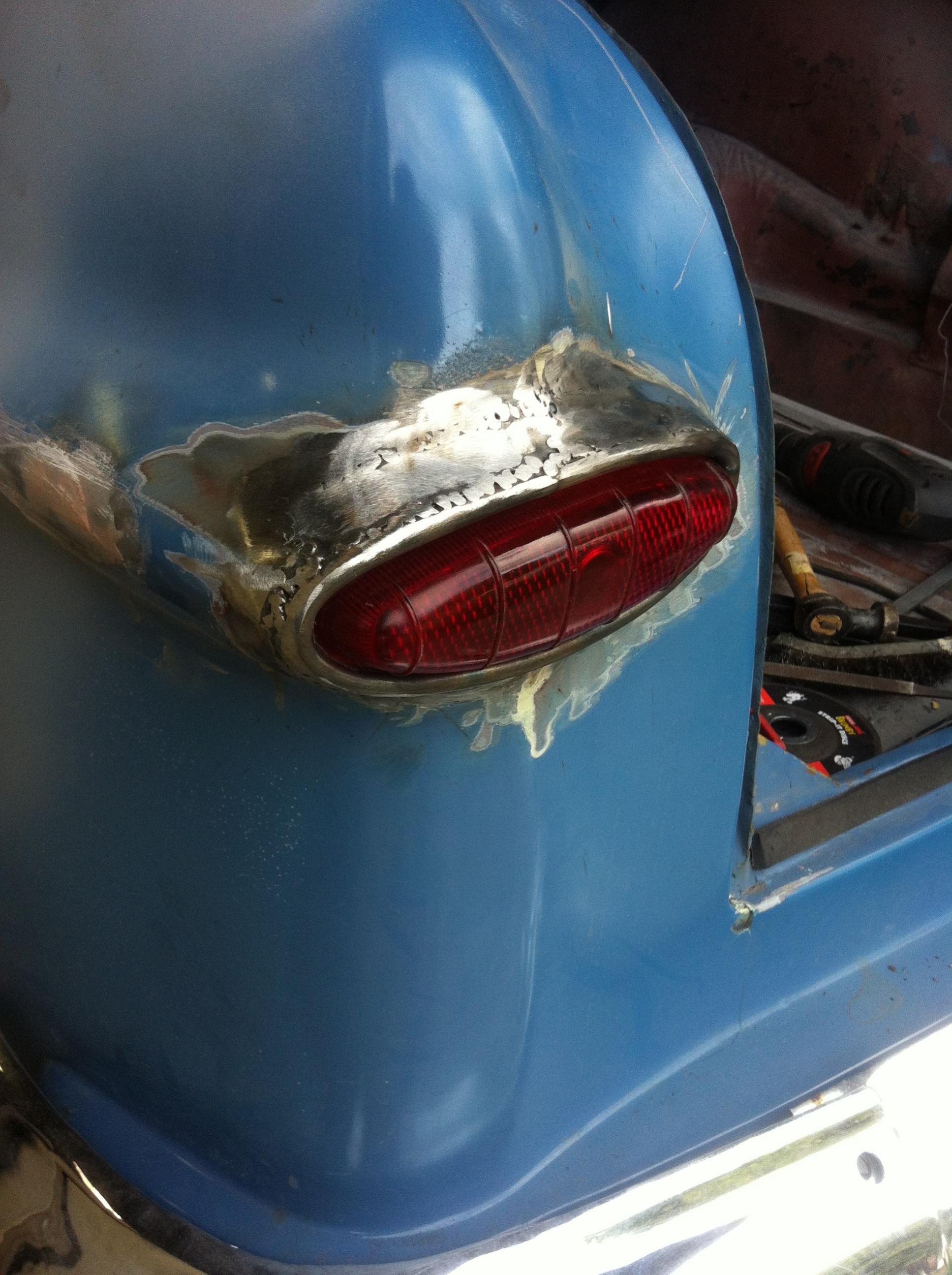

    I then welded 3 screws to the inside where the original 3 screws were to fit the backing globe holder and held it down with nuts on those screws.
    So to finish I put the lens in then the globe holder plate and the nuts then later a skim of filler and sealant on the inside around the lens when the cars finally painted .
    I have to stress I'm no expert just doing what I can with the tools I have

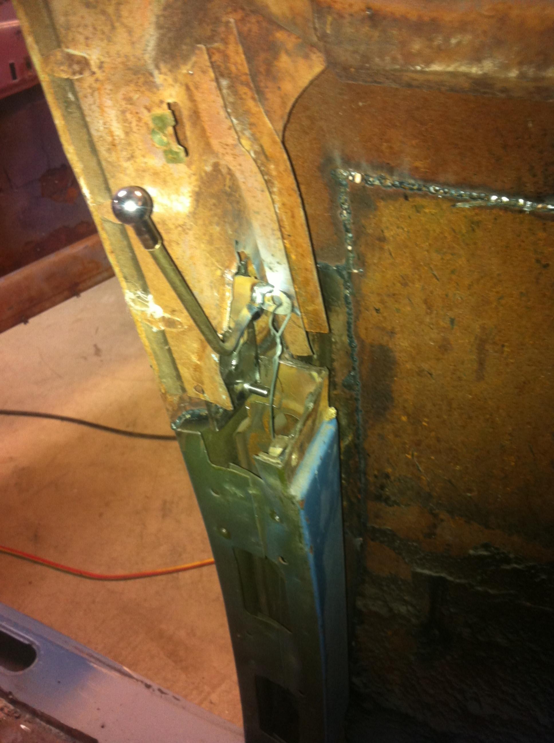

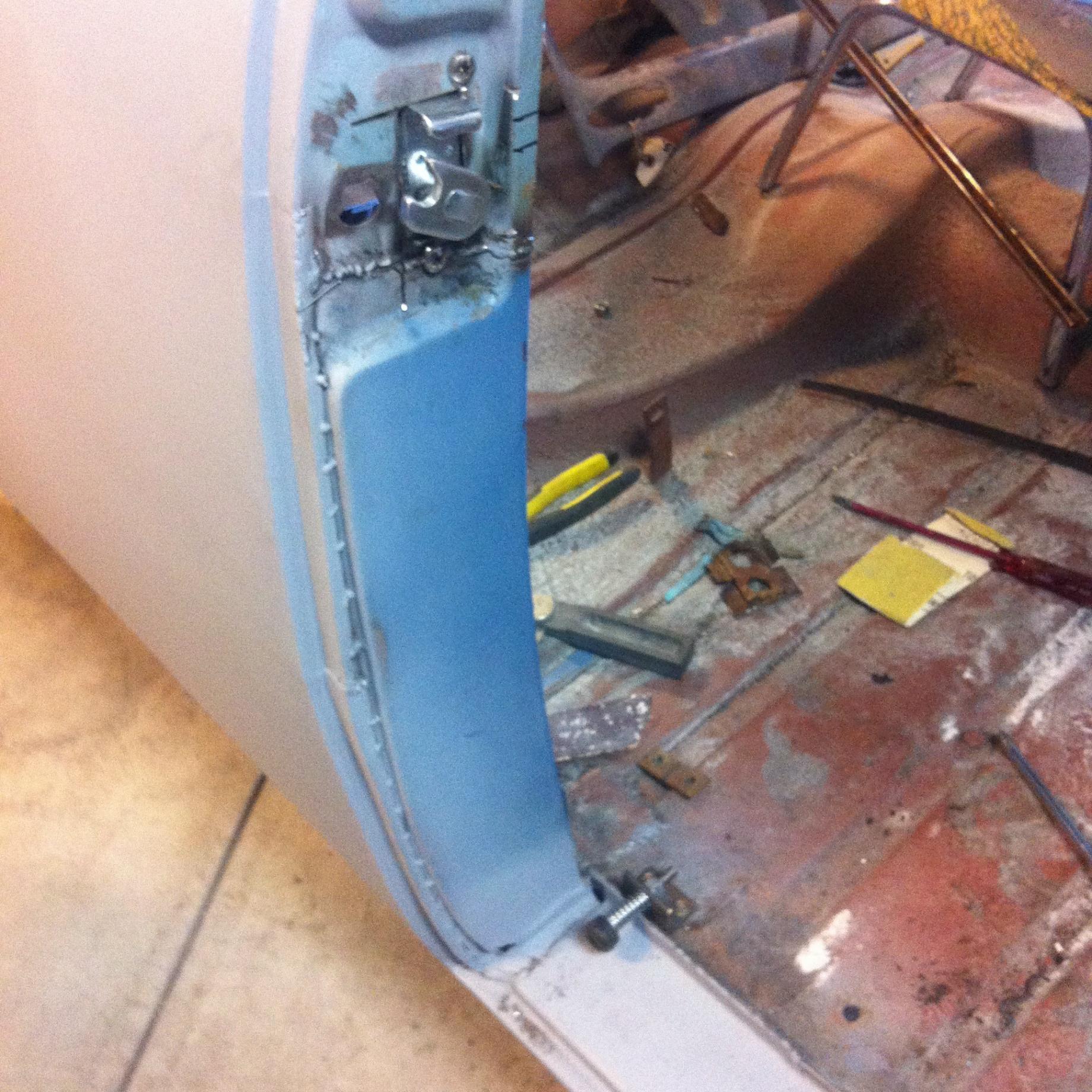

    New update .. I'm shaving the door handles and didn't want to use electric door poppers
    coz basically I've seen electric poppers not work and a smashed window later was the the only entry. so I made it all mechanical, I've fitted a bear claw latch ( or similar) inside the b piller with a wire that travels down the b piller and out the bottom inside of the sill / rocker panel . so to open the door just pull the wire I've also made sprung poppers at the bottom of the door just to push the door open so theres no struggle to get fingers in behind the door to get it open ImageUploadedByTJJ1336529055.388264.jpg ImageUploadedByTJJ1336529157.233973.jpg ImageUploadedByTJJ1336529250.755621.jpg door

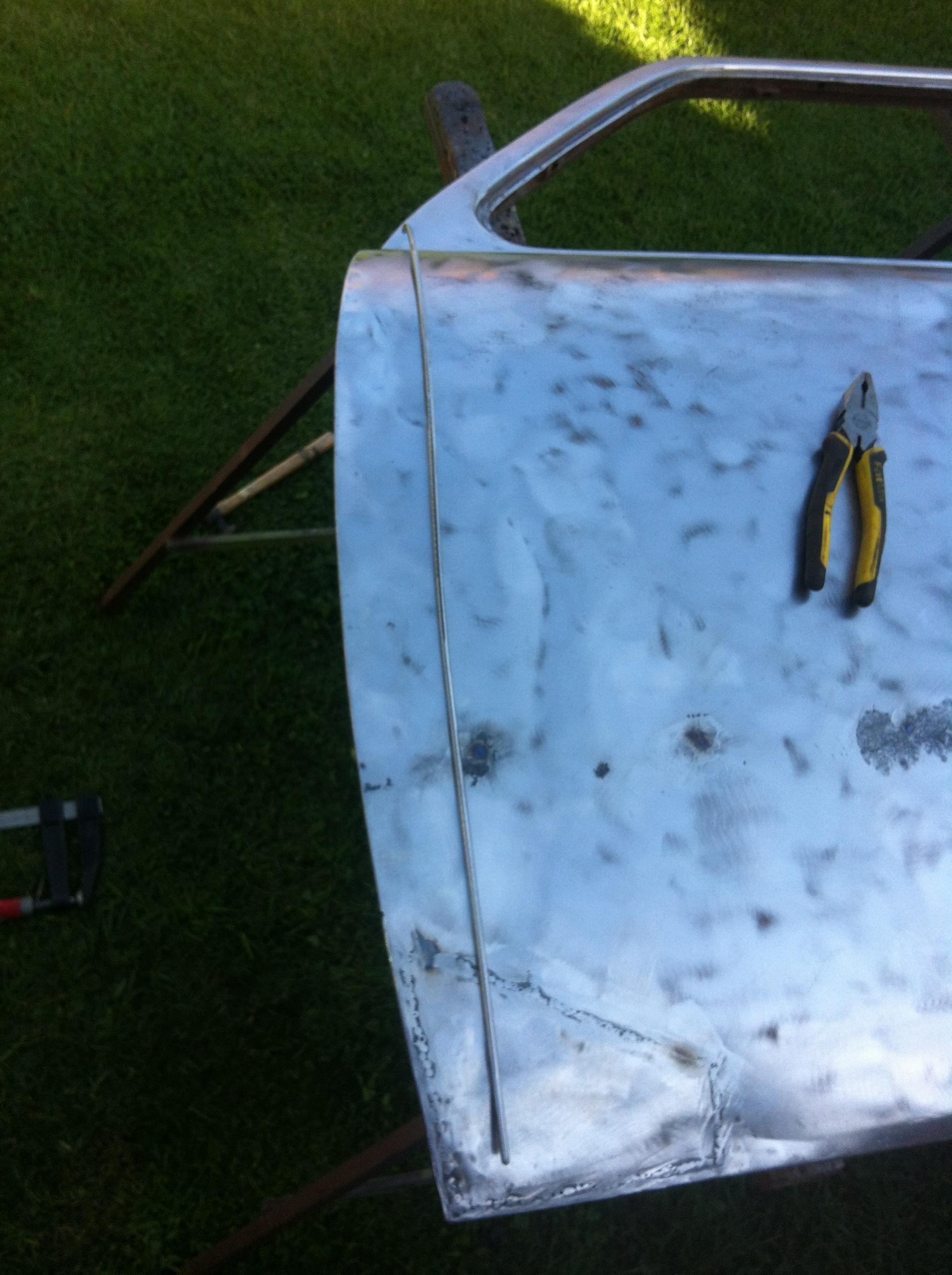

    I've also started on stripping the doors and fixing rust and dents and filling in where the door handles we're.
    I started on the worse door because the good door has no rust or dents (bonus) and will just get handle holes filled then primed ImageUploadedByTJJ1336529955.433097.jpg ImageUploadedByTJJ1336530012.583430.jpg ImageUploadedByTJJ1336530071.814626.jpg ImageUploadedByTJJ1336530154.912645.jpg

    The door also had a half inch gap between the door and front guard that I couldn't live with so I added round rod to the front of the door to fill it in it worked great and here's the finished door , a skim of bondo later on and I'm happy ImageUploadedByTJJ1336530434.226276.jpg ImageUploadedByTJJ1336530530.603689.jpg ImageUploadedByTJJ1336530589.764648.jpg ImageUploadedByTJJ1336530672.798336.jpg

    Av88, you may find those poppers to be in the way of your back seat guest, if you relocate them to the lower part of the door then they will always be hidden and out of the way. just a suggestion
    looks great
    Godspeed
    MrC.
  10. AV88
    Joined: Feb 7, 2011
    Posts: 235
    AV88
    I see what you mean and thanks for the suggestion but I'll just live with it for now I thought about running a cable that comes out just next to the front seat well see what happens later

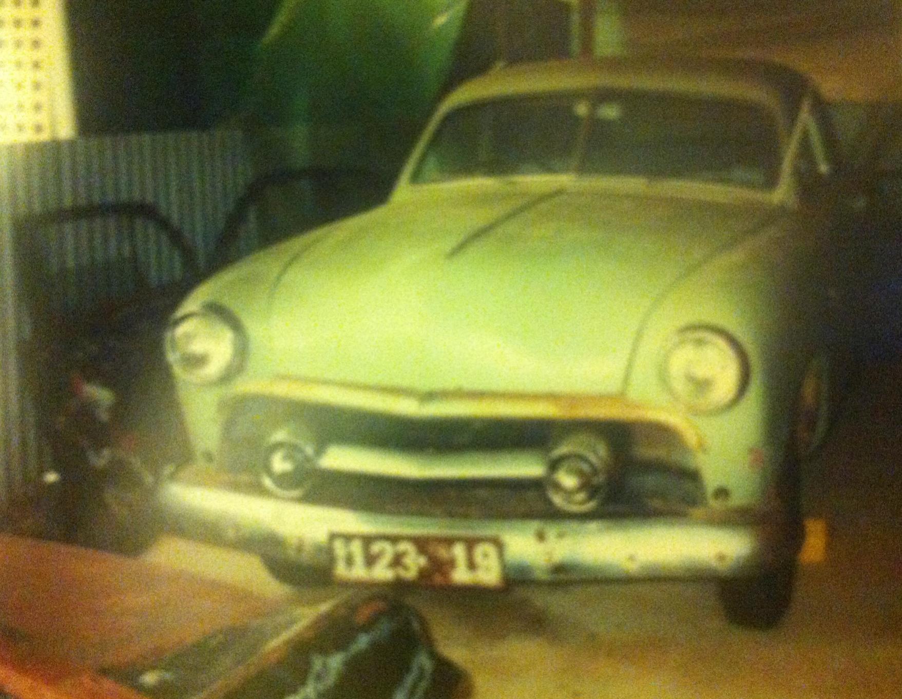

    Hey des I'm probably gonna bring it to chopped this year but not sure my daughters getting baby sat so might drive my roadster well see , but I always wanted a two door but had no cash ,so I got this car 10 years ago for $800 ,Michael ahrens and I spent a year fixing it up here's a pic when I first got it ImageUploadedByTJJ1336734482.278805.jpg

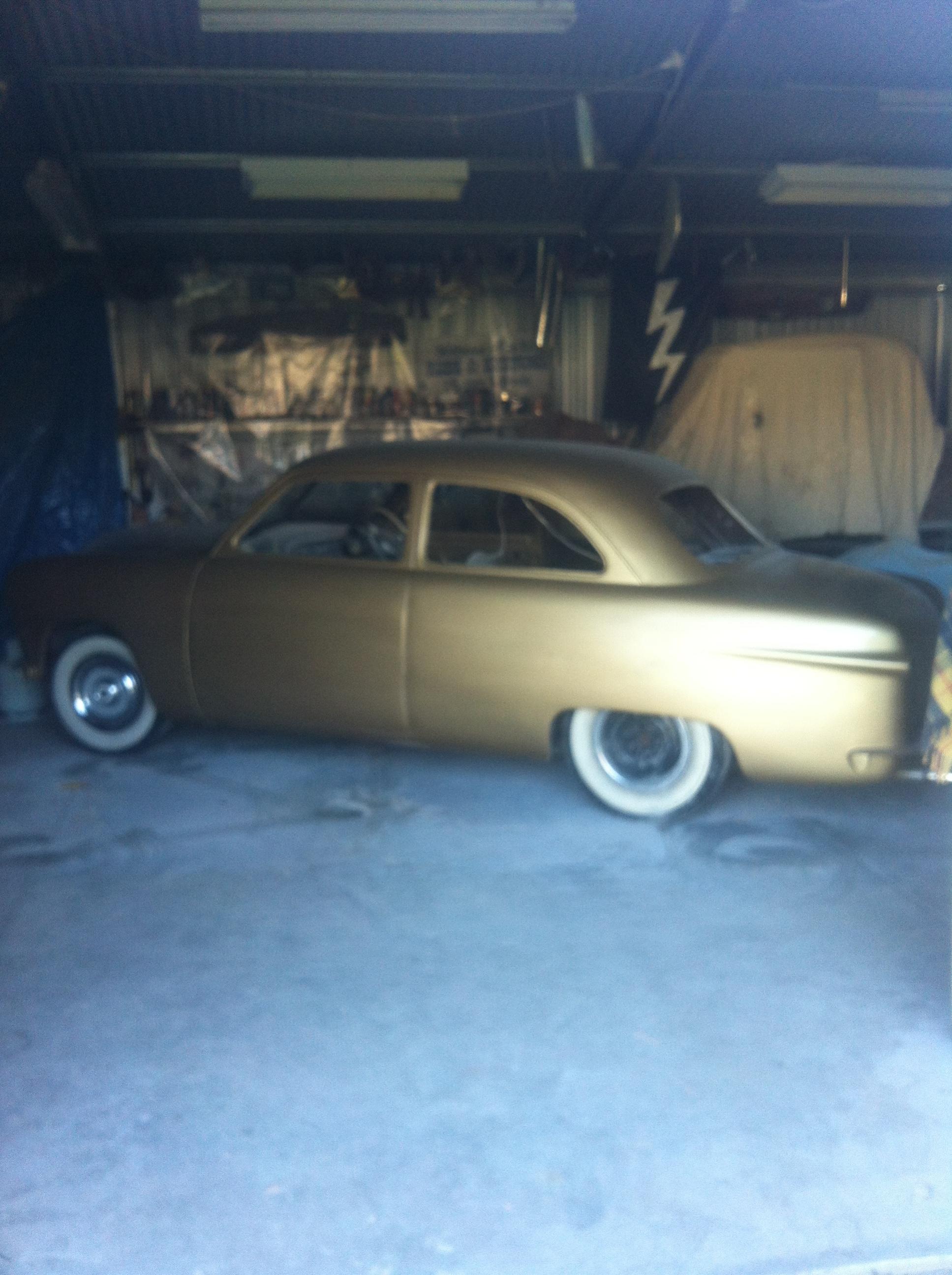

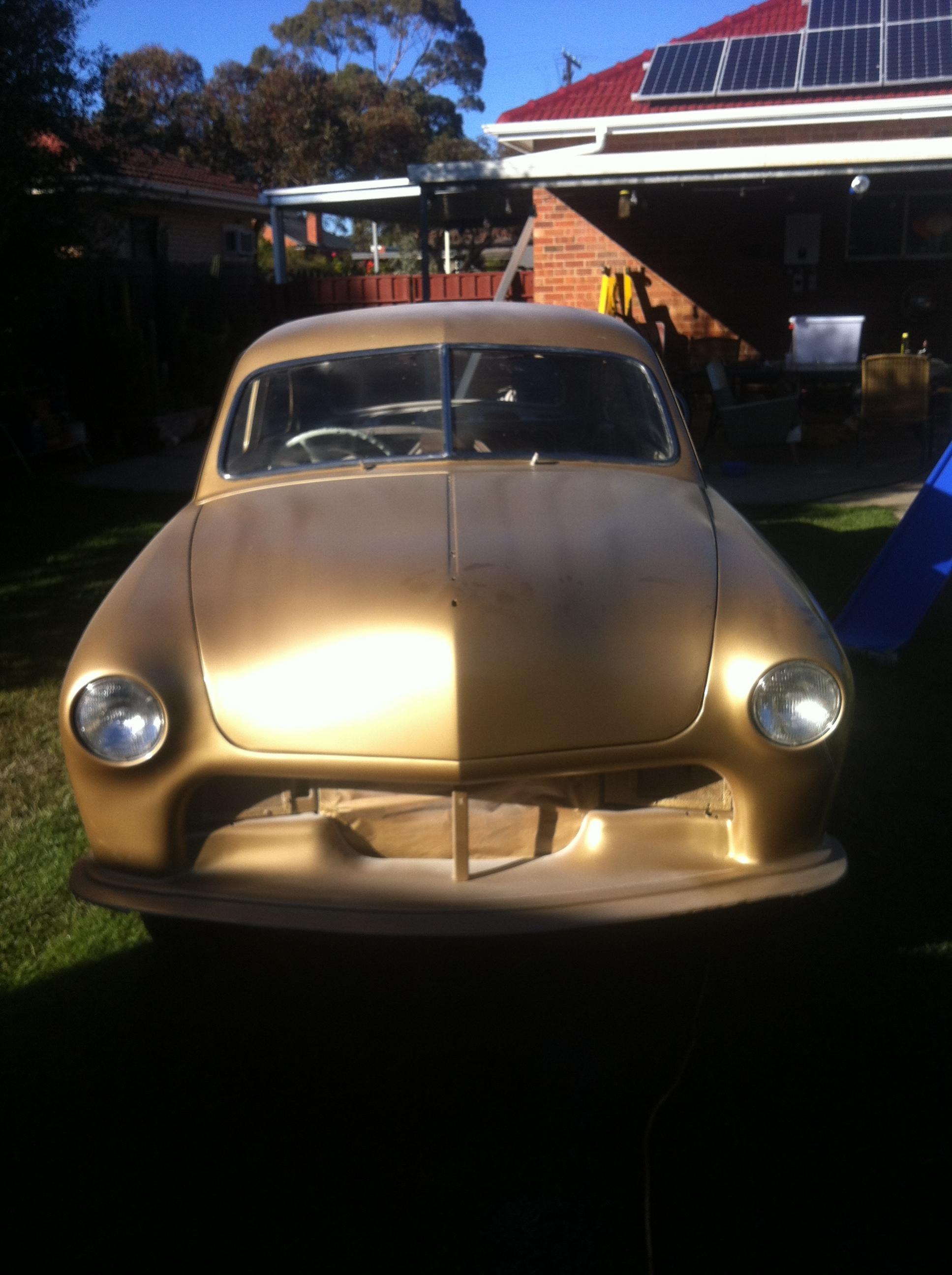

    Ok update time well it's finally in colour
    It is a mid 80s colour from Chrysler called "gold mist"
    It's my first metallic paint job and is very different to a non metallic to paint, it's acrylic with clear laquer ImageUploadedByTJJ1339497368.366333.jpg ImageUploadedByTJJ1339497402.147240.jpg ImageUploadedByTJJ1339497458.497033.jpg ImageUploadedByTJJ1339497536.773971.jpg ImageUploadedByTJJ1339497584.516918.jpg
