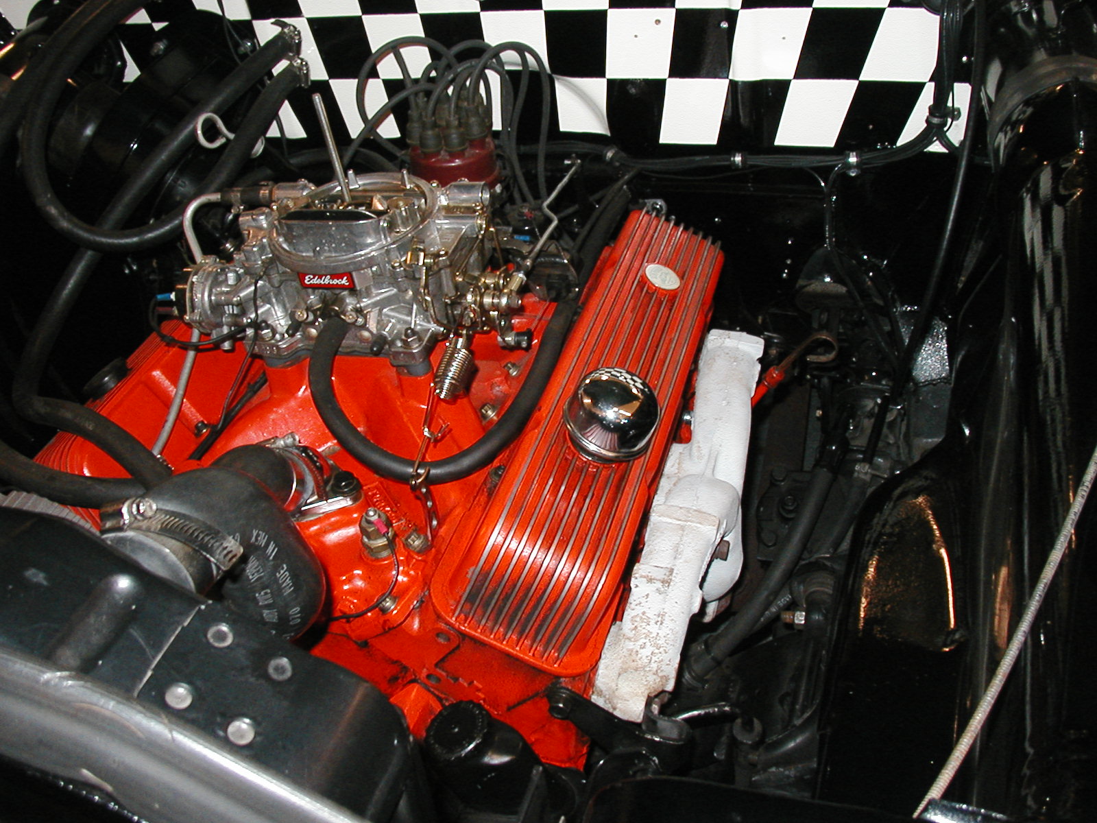

  4. Here are 2 shots. Stock 51 to 700-R. Yes it works properly in all gears. It was real important to me to look stock with the Hood closed, as it should.

  6. That looks good. Could have saved me a lot of time.
