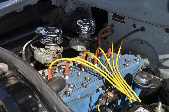

    Today I've managed to put together and unscrew bellhousing, flywheel and other stuff for five times in my 226. Last week I've realized that somehow my freshly rebuild flathead is stuck. I had some thoughts about reasons and I was considering dismentaling all the engine to bare block. I've started with unscrewing bellhousing and oilpan. In this situation I thought I'll try to spin engine for last time and, as You can imagine, it started to move freely... My first thought as that the problem is in rope seal in the pan. So I work on it for next 40 minut, put the oil pan on its place and the engine still moved freely. So the problem was solved. Then I screwd fly wheel on it's place and the prolbem occured again... God damn it!
    Then I've stared to think that the problem lies in flywheel bolts, but htat didn't work. So I'm looking betvene flywheel and engine block for next 15 minutes or so and I can't see the problem... And eureka! I've put 2 washers (that spring one and ordinary) which pushed bolts head so much that it blocked the flywheel and frozed up the engine (I won't show You any photos because of the level of embarsasment)... So I happily put together all the parts and just after screewing lats bolt I've realized that I forgot about the back freez plug about which I spoke not to forgot to my friend in the shop... So again- unscrew everything and put that sh*tty freez plug in its place. IMG_6860[1].JPG IMG_6861[1].JPG After this happy time I've managed to weld engine tray and put the engine like it should be
    IMG_6864[1].JPG If the engine won't start it'll still be a wonderful beer case, still a bit heavy, so I wouldn't recomend it for weekend vacation.

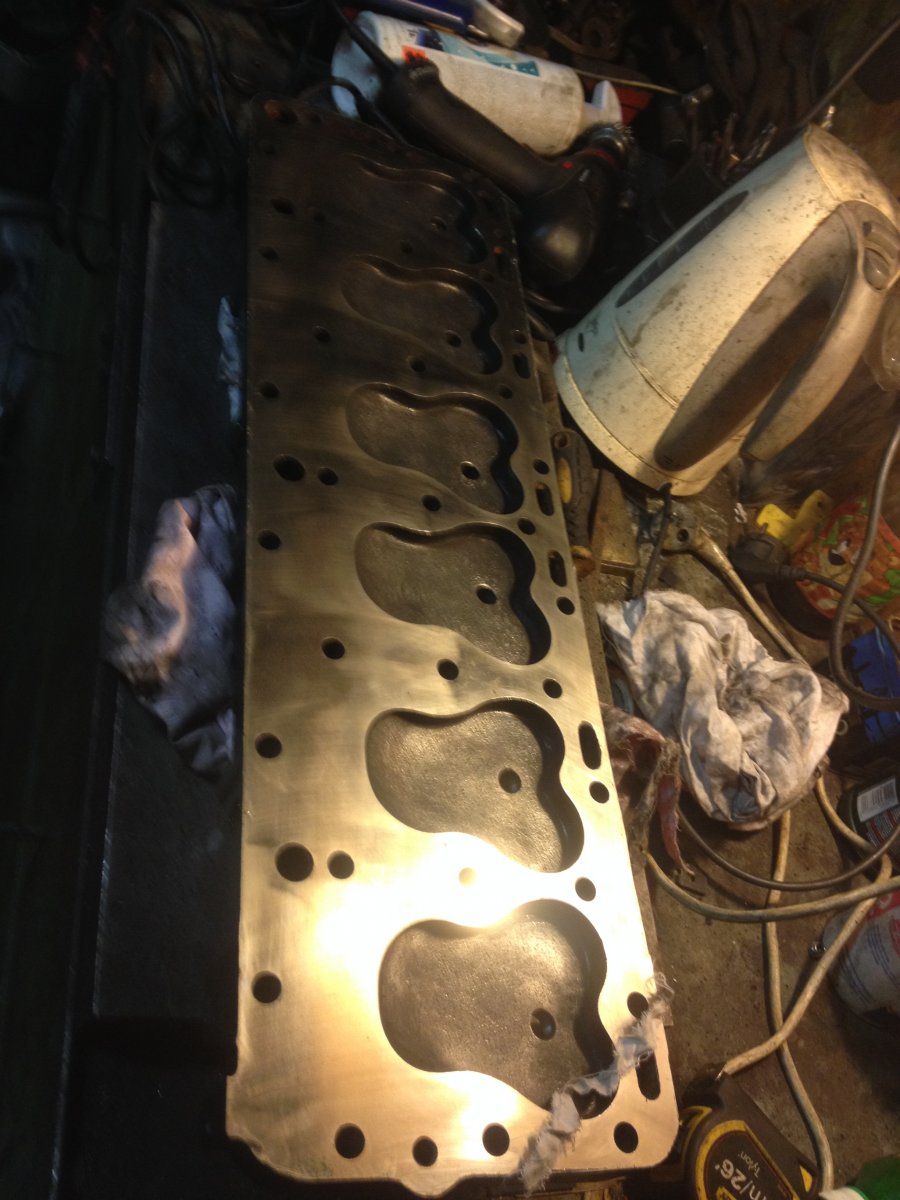

    At last I've also cleaned combustion chamber in the engine head
    And started to begin the end of this historycal ***embly (I've got to be honest- it took me almost 2 years of very slow work ;)) and raised my level of patience. I have to say that it is one of my biggest dreams to have and rebuild a flathead engine, and that dream came throu! IMG_6869[1].JPG IMG_6870[1].JPG

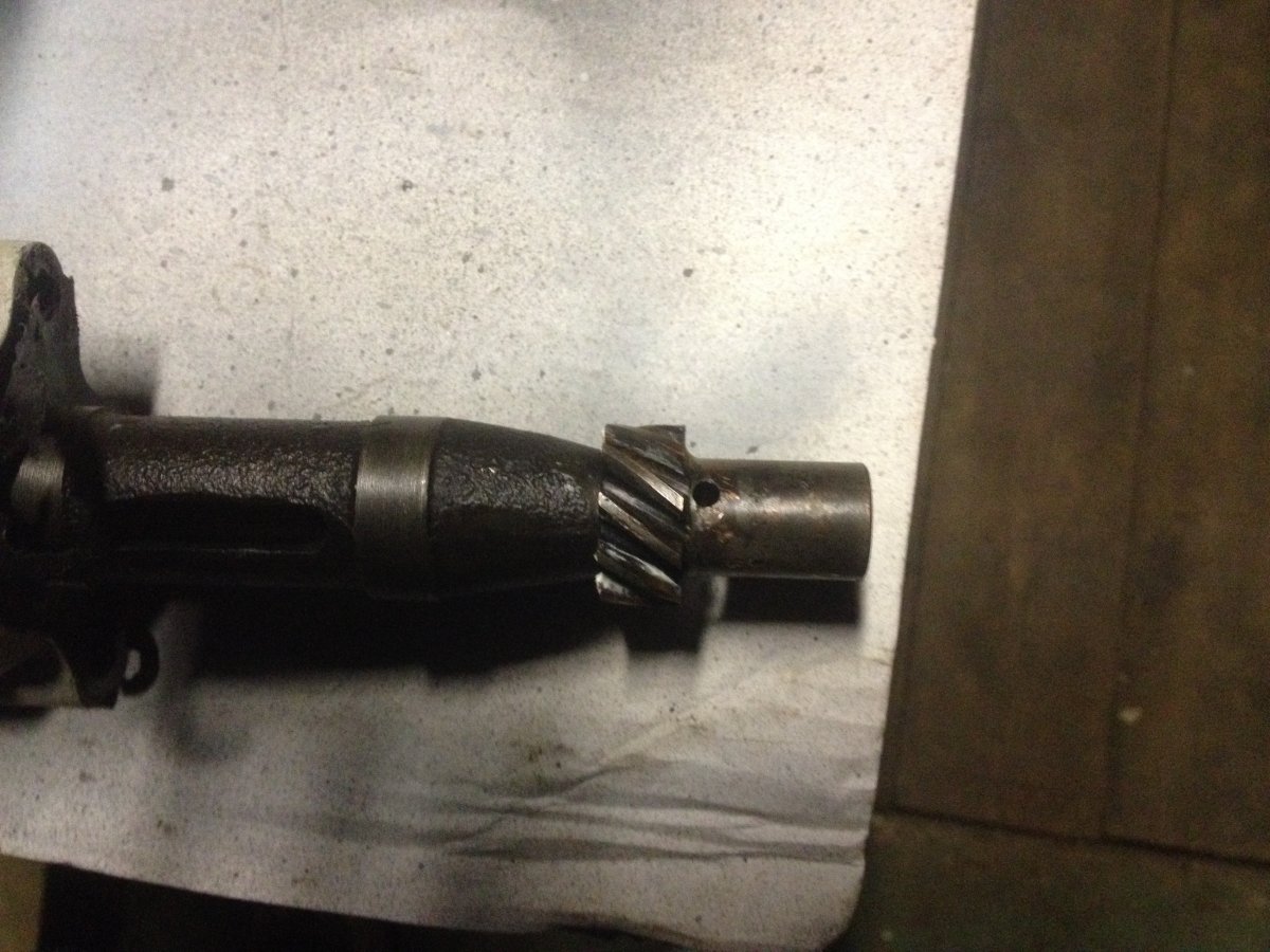

    I'm still working on this project, but it gives me levels of iritation I didn't imagine I could have... I thought that I'll manage to start up the flatty, as I've finished up the full flow conversion, but I've broke the tooth of oil pump gear... I forgot to make photo, maybe Marcin could help out, but for me it was the end- I wanted to make this project burn! Still, the engine is almost ready. But everything should be in order, so- first I've pluged up outlet port from the oil pump

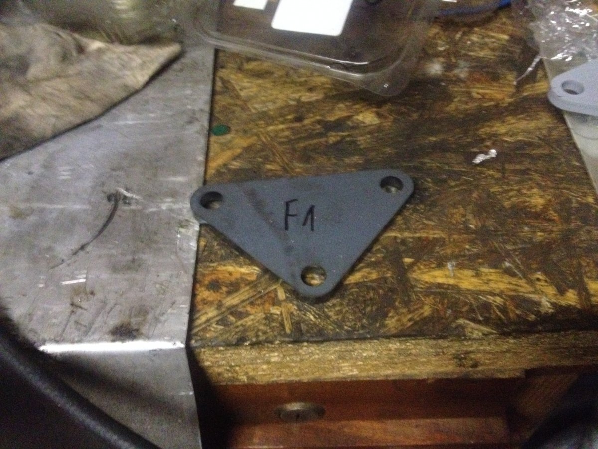

    Because of my work I have posibility to make some CAD drawings and laser cut some steel like those below: IMG_6726[1].JPG IMG_6935[1].JPG first plate will be a part of the oil pump. I've drilled a hole in that first thick plate to weld up new outlet
    IMG_6940[1].JPG than there was time for the triangle shape plate- I've made it to seal the holes after old oil filter can. As I wasn't sure should I pluged in 100% I've done sort of a groove

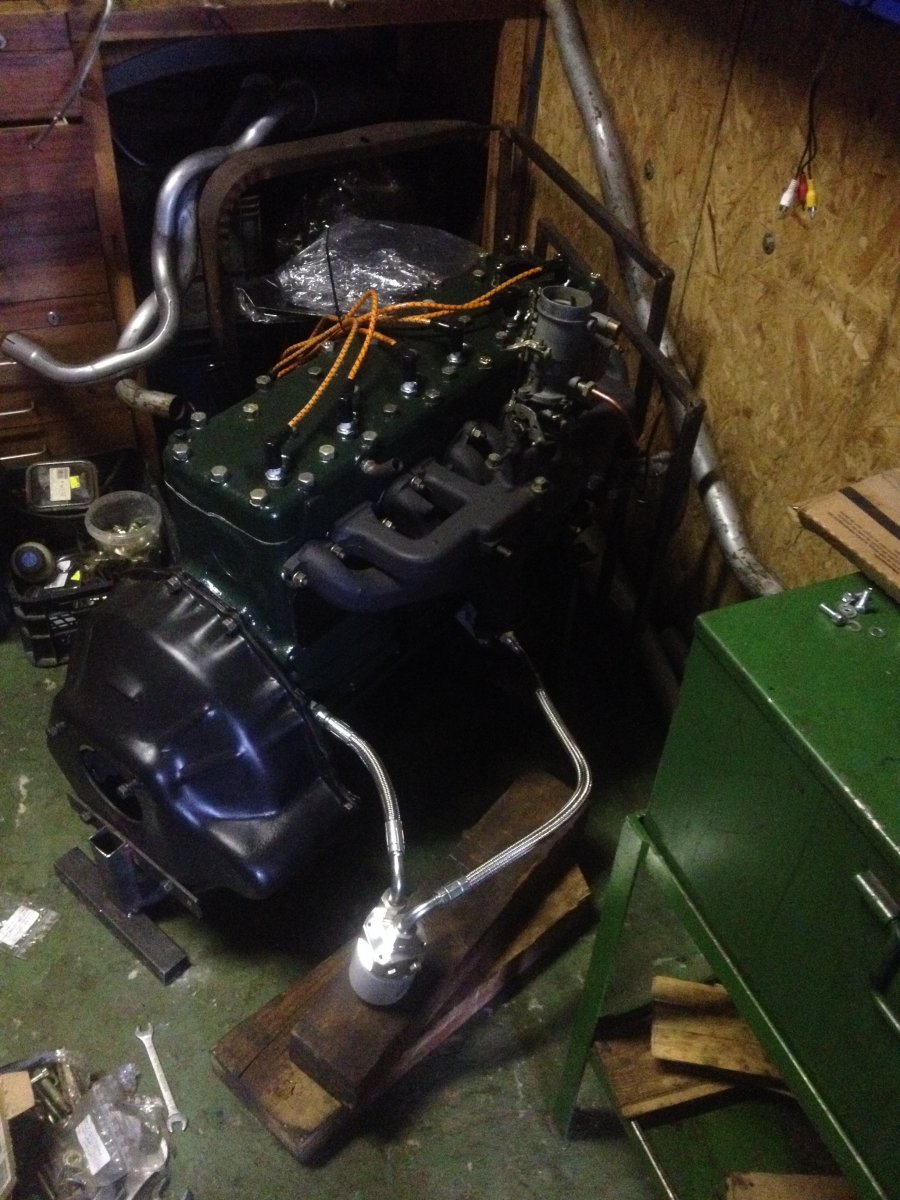

    IMG_6937[1].JPG I've putted all the bricks together and I have this for now (I've got to thank m.kozlowski for making those nice oil hoses for me- thanks Men!)
    IMG_6965[1].JPG IMG_6966[1].JPG And as I wrote befor- I'm stuck. You can imagine how its hard to find another oil pump here in Poland... So here is a question for all You HAMBers- is this gear from V8 interchangeble with my broken oil pump gear in 226?
    http://www.ebay.com/itm/Flathead-Fo...ash=item58c8c04cd7:g:1xEAAOSwPcVVoA~9&vxp=mtr
    it looks similar.... Anyway, I'm puting off the revival of the engine for now, cause, for now, I can't think of anything else, than throwing this stubborn piece of s*$t for high mountain straight to volcano... I'll try to write about welding the B pillar tomorrow, but it didn't went well either...

    the problem is that I really don't have anything. My plan is to mesure my broken gear and ask politly that vendor who is selling those gears for his mesurments.

    Could you post a picture and dimensions of the gear you need?

    steinauge- I'll do the mesurments and photo on saturday, cause I have that broken pump in m.kozlowski's garage

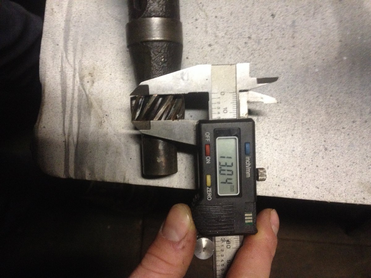

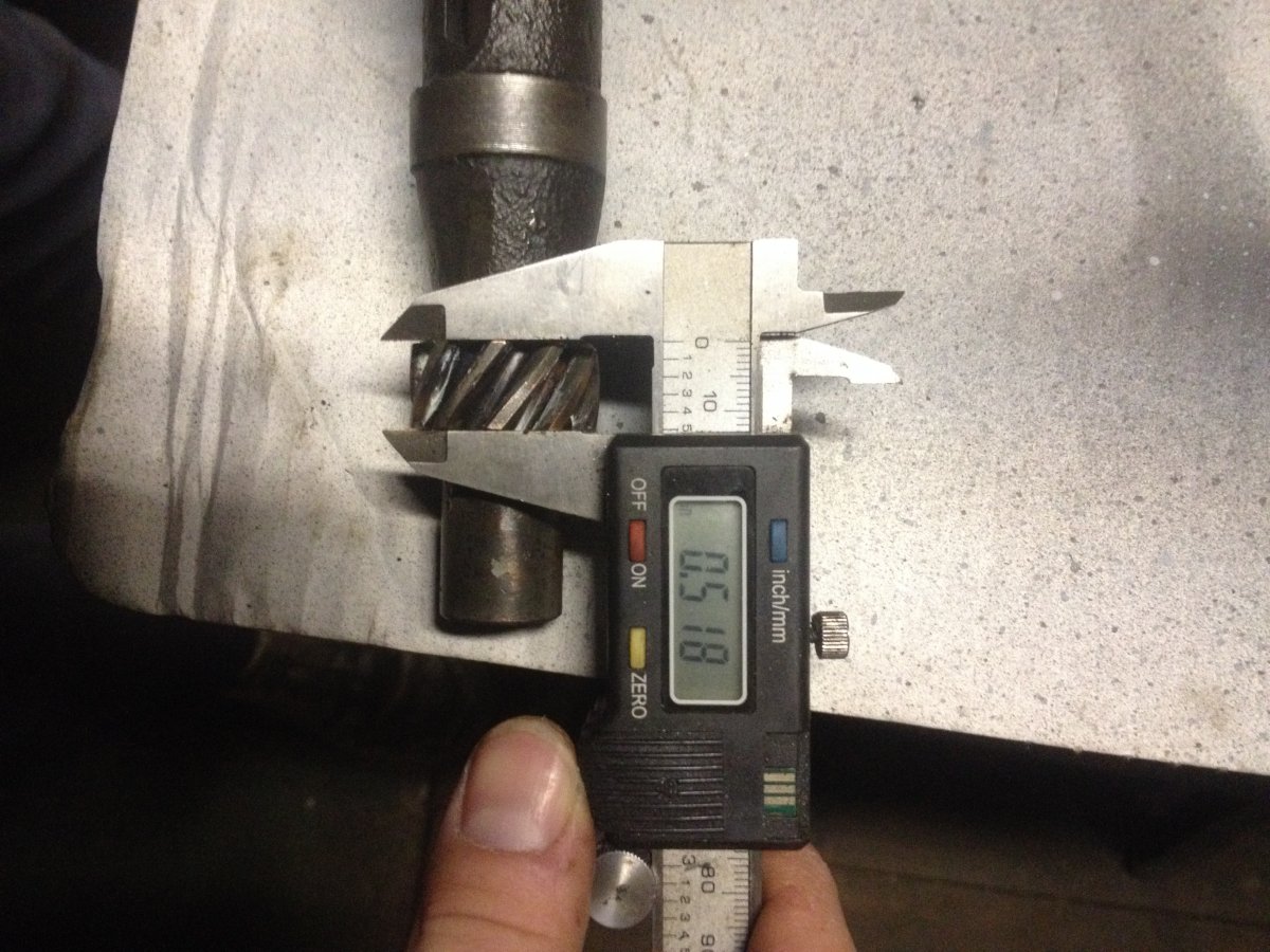

    Your support os great! Thank You very much! So I've mesured and it looks like this: IMG_6998[1].JPG in inches. Hight was about 0,5 inch, but my phone didn't save the photo of mesurment, so I will clarify

    The gear looks like this: IMG_6998[1].JPG IMG_7001[1].JPG IMG_7003[1].JPG IMG_7004[1].JPG all in inches
