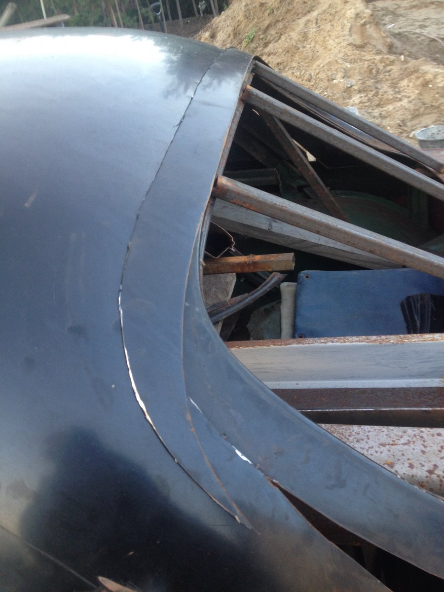

    Back to the story- left C pillar. Last time I was there it was only tucked up in the front section, so I started to finish it up. First I had to do special clips, cause those regular ones from the shop were to short IMG_6990[1].JPG those holes make them lighter ;)
    And with such great weapon I could start my work IMG_6991[1].JPG IMG_6992[1].JPG IMG_6994[1].JPG And I started to cut off extra portion of roof IMG_6995[1].JPG

    I think generally, most folks start lining up the cut roof at the A pillars first and then work their way back to the b and c-pillars. At this point, I think I would move the front of the roof forward to line up with the pillars on the body and fill the gap. Leaning the windshield back that far by leaning the bottom of the a-pillars back may not look as nice. Hang in there!! :)

    Looks like you've already got the C pillar in place, so your best bet to get the A pillars to line up is to cut the front of the black roof off and cut a section of the old red roof off to match, except with some extra length to make up the difference. You could cut the front of the black roof off, line up the pillars, and use a strip of the old red roof to fill in the gap also, although that would make two seams instead of just one.
    That's how I did my '53 and my boss' 50 back in high school. It's kinda clunky and makes a longer roof but it does work.
