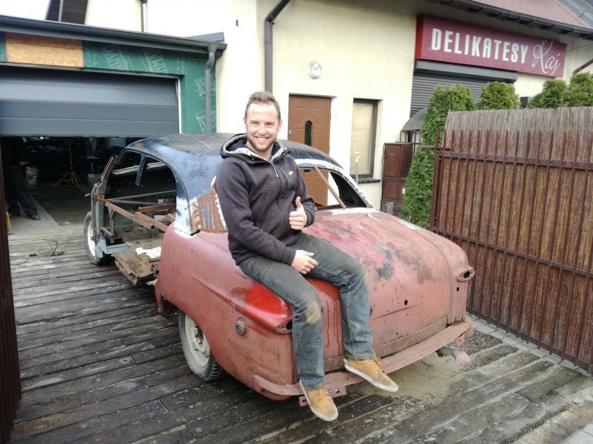

    It is a tradition of some sort to fire up any engine (or engines) on that particular day, at least since volga ;)
    Sent from my HUAWEI VNS-L21 using The H.A.M.B. mobile app

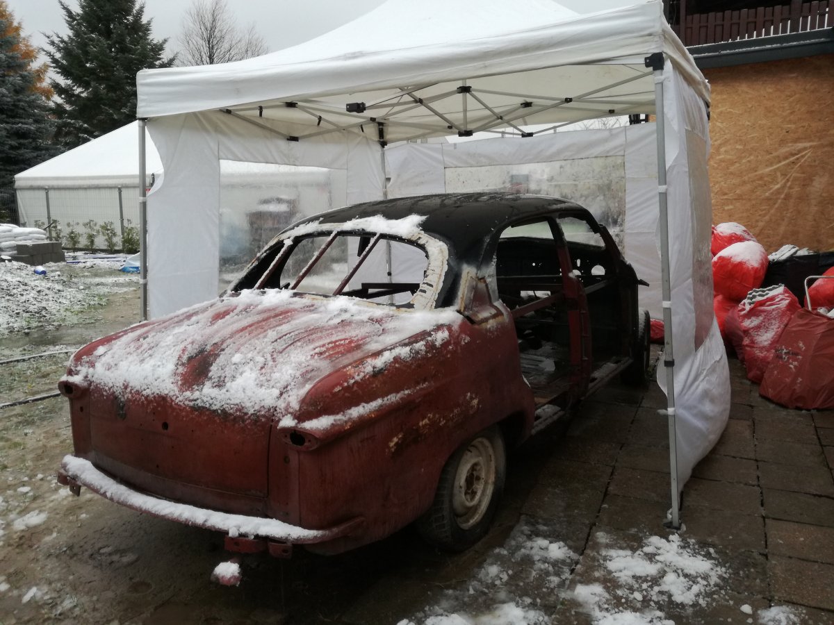

    And the winter came- but, as we all know, real men don't care about the weather.
    but work has to be done- so we used, with m.kozlowski, the front end to make garage little prittier ;)

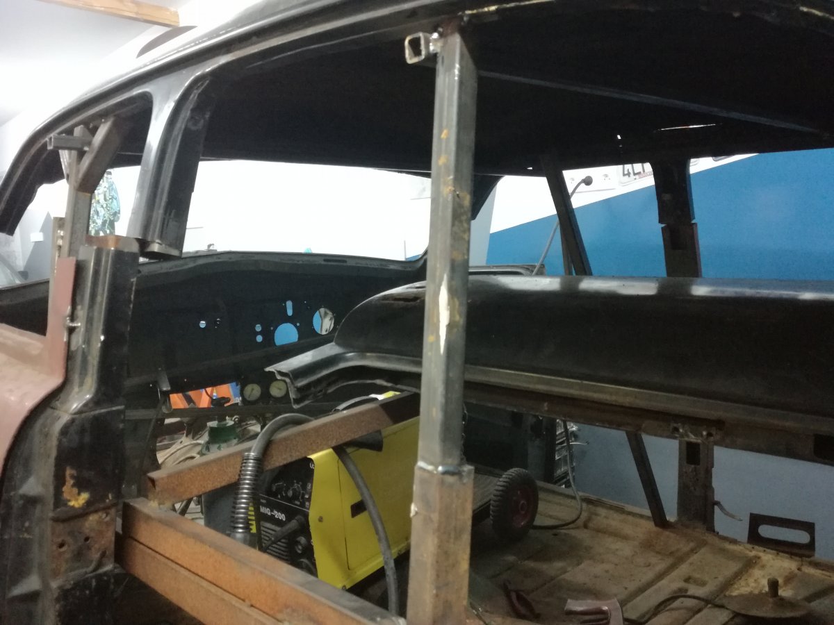

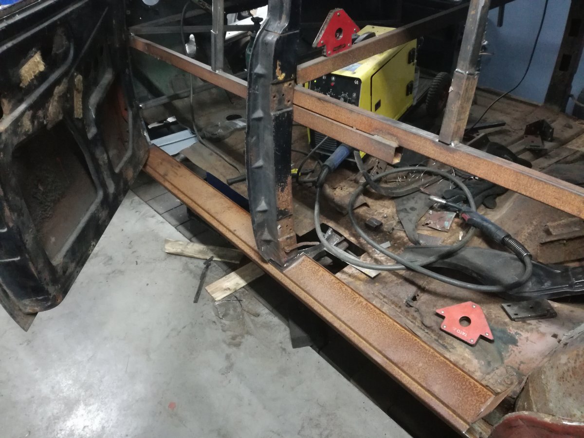

    First I've leveled the body and the roof to make a stronger cage to support all the loss in body (don't ask why I didn't do it earlyer... Ireally think that this thread is the real one how NOT to build a custom :D)
    Also, my eagernesswould let me do all in right order and I've started to mount the choped door
    And started to fit the B pillar welding it inplace to door
    When I was able to reestablish the new position of B pillar I had some good idea-why, the hell, I didn't build a proper cage to hold the roof in place. So I did
    dana barlow and spurgeonforge like this.

    And started to strip that B pillar connection to weld the inner parts of it
    As You can see I have a very different aproach to my chop, that why I have to move those upper B pillars and weld it in their new place

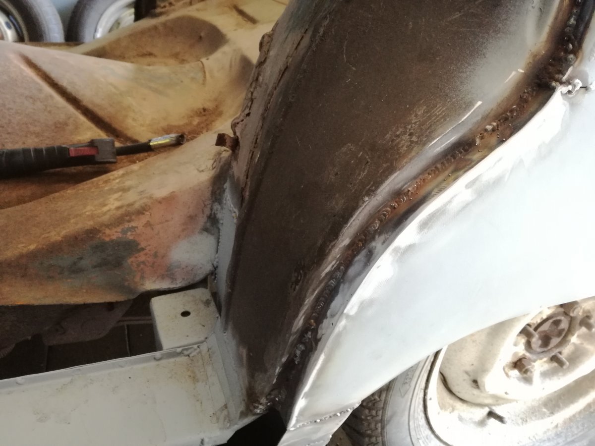

    So the time came to move the car from garage for a bit of time, thats why I had to double my effort, specially that in that stage I would warp in the rear wheel arch section. Thats why I choped more :p

  22. Trefl
    Joined: Dec 6, 2012
    Posts: 93
    Trefl
    And inner fender wasn't done better :)
    Of course I've weld that little hole and close with welds all up, but You have to belive my words- I've forgot to make photos...

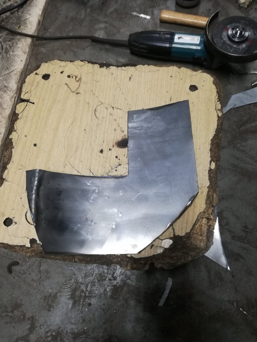

    I've almost forgot- if You can recall,I had that pritty weld maze below C pillar.
    With english wheel (this was my first panel, wheel arch was second to use english wheel) I've made a patch for that place. Thats maybe nothing, but I a bit proud of it :)

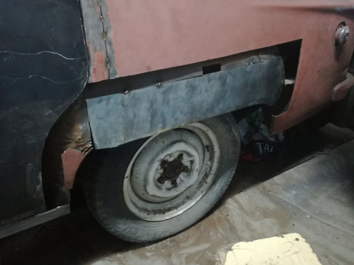

    Some weld later, as I sad earlier, I had to move mycar out for a bit (I went on vacation to think about my next moves). Ford looked like that:
    As You can see it hade a big gap in front of rear wheel arch, but I wasn't worried to move this for now rolling shell :)

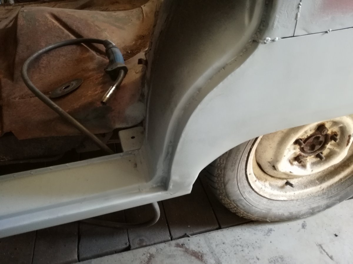

    Car went back to garage so I could start those finishing touches. First was to make a better joint between rocker panel and wheel arch
    It's still not too good but its way better than it was. Than I've filled that gap in front of wheel arch
    Next place that I'm a bit proud of :) at least thatsall I can do with my set of skills and tools
    after that I've started to weld up the wheel arch. Boy- that's a tuff one...
