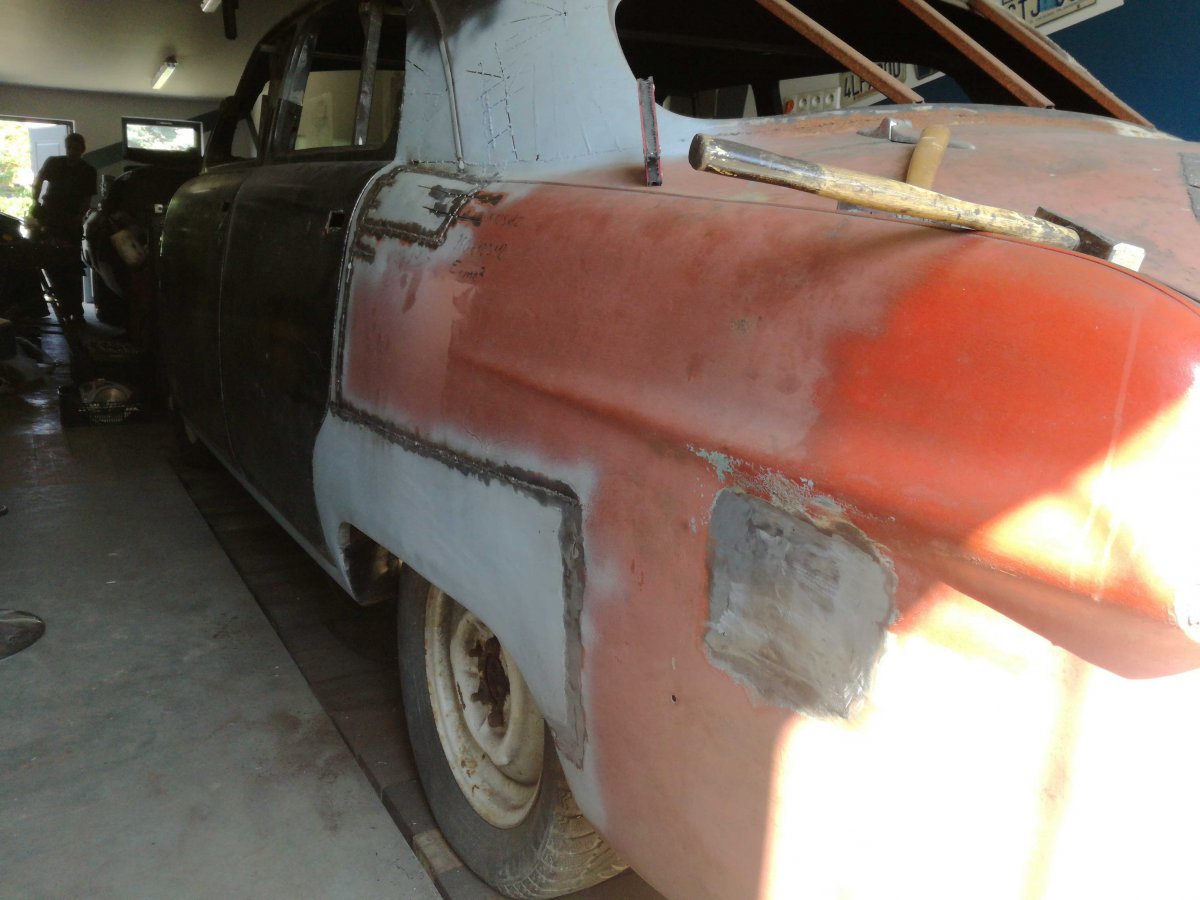

    I would even say that very slo :) I've tryed smooth that upper patch up and I was doing it half a day and it still does not look well, even for my standards :) thats why I will be learing sone lead wisdom in the near future[​IMG]

    I din't like that tank filler cap. It's way to off that rear panel IMG_20180428_092132.jpg

    Trefl
    I had to do something, so I've cutted it out and made a plate in its place IMG_20180428_095357.jpg

    Trefl
    And weld it up. Till this point its the best patch I've made on this car... so theres always hope that I'll learn how to do it right ;) IMG_20180428_121512.jpg

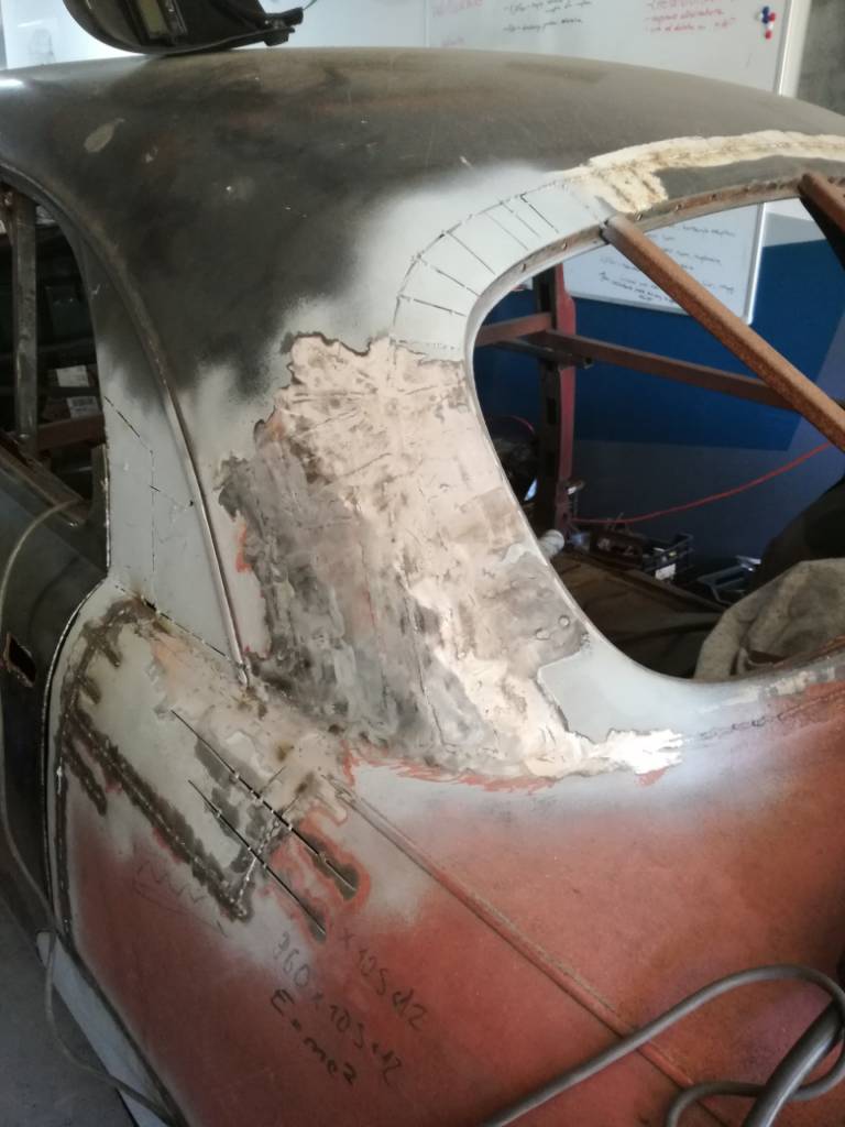

    Last update for next few weeks. Project 49 goes on hold, cause I want to work on my other car. So, to be satisfied from all that previous work I wanted to finish left side (at least without A pillar- I dont want to cut roof in half without welding up all other pillars from right side). So I started with finishing up rear window frame IMG_20180519_104753.jpg

    After some grinding I went back to B pillar. I made it some time ago, but welds weren't smoothed and there was about 35mm (almost 1,5inch) after relocating upper B pillar in roof. I've managed to salvage roof profiles from red car roof. After cutting required part of channel I've realized that its rusted out. When I was wondering what to do next our friend George came by and sed "why don't You make it yourself?". Of course he was joking, but I took it seriously- why I dindn't think about making one?! So I've made it [emoji2] IMG_20180519_115436.jpg IMG_20180519_115443.jpg IMG_20180519_115800.jpg IMG_20180519_130553.jpg

    Next I've grined everything and paited it with primer IMG_20180519_135426.jpg IMG_20180519_135447.jpg
