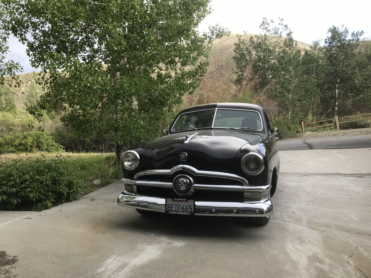

    Good morning Jeff...back again for more help with my 50 shoebox project.....all finished and on the road with the whistles a bells...except...
    It wallowed and rolled like a sailboat ..bilsteins in rear and 5821 Monroes in front eliminated the problem at lower speeds...however at 65-70 it still wallows and rolls over irregularities in the road...help? And thanks hope all is well with you.. A2A53B80-71B1-460B-9C84-6A89DEFD2FF4.jpeg

    Thanks...installed the front sway bar from Jamco...changed front shocks to Bilsteins...completely cured body roll and wallowing ride is a little stiffer than I’d like but vey stable. Thanks again for your help and happy holidays!!
