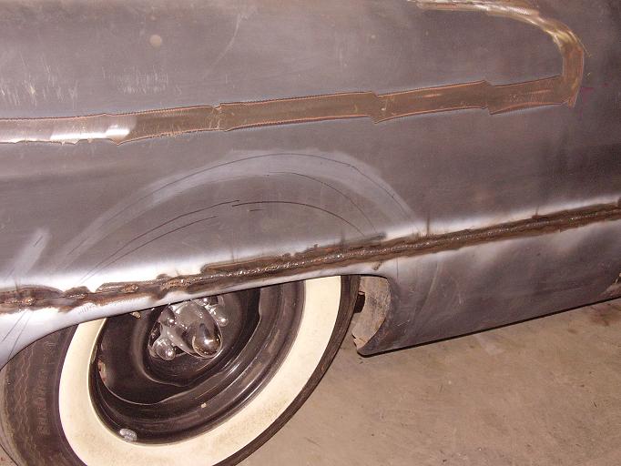

    been procrastinating on welding the car back together after i sectioned it,,,finally started the tedious job of welding her back together,,,,,,ive got the quarters nearly done (no grinding yet)...went real slow and skipped around (got some funny looks from my cat when i was skipping around the shop,,hahah)....the warpage wasn't really that much of a problem after all,,,there are a few spots that need hammer and dolly work,,but not bad at all....there is one spot on the drivers side in front of the wheelwell that seems to have some bondo,,i have a feeling it wont be pretty,,may have to redo a patch panel there before moving on................after that, i will pull the engine, weld up the firewall, pull the fenders and weld them on the bench, weld up the inner fenders, and finally weld up the inner door frames,,,,,really went a lot smoother than i thought it would,,next time i won't procrastinate so long,,,,then its back to the fun stuff,,,,,,,,,my wacky mind has been hard at work,,,,,wait till you see whats coming......

  24. Looking good! Did you do all the welds with a henrob? With the front fenders are you talking about something kind of like the later version of the Golden Sahara? Can't wait to see more1

    mig welded it....i bought the gas welding setup (meco mini),,but need more practice,,i decided to go ahead with the mig process until i get the hang of the gas welding,,,
