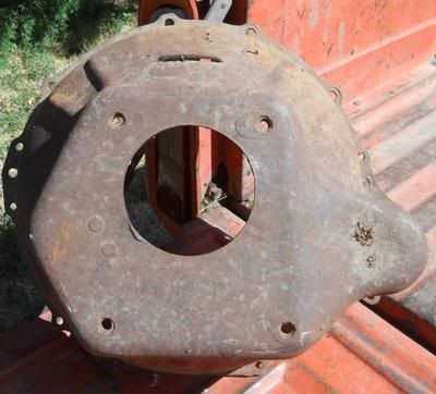

  19. Mr48chev
    Joined: Dec 28, 2007
    Posts: 36,509
    Mr48chev
    The shoebox uses the stamped steel bellhousing like this one With the appropriate adapter plate. Edited, I don't think the first one I posted is correct but the damn spendy Offenhauser one from Speedway is correct. Screenshot (3383).png

  20. Thames58
    Joined: Jan 10, 2019
    Posts: 33
    Thames58
    I've seen that adapter somewhere on the web, I think I can cast it and machine it for a lot less money.
