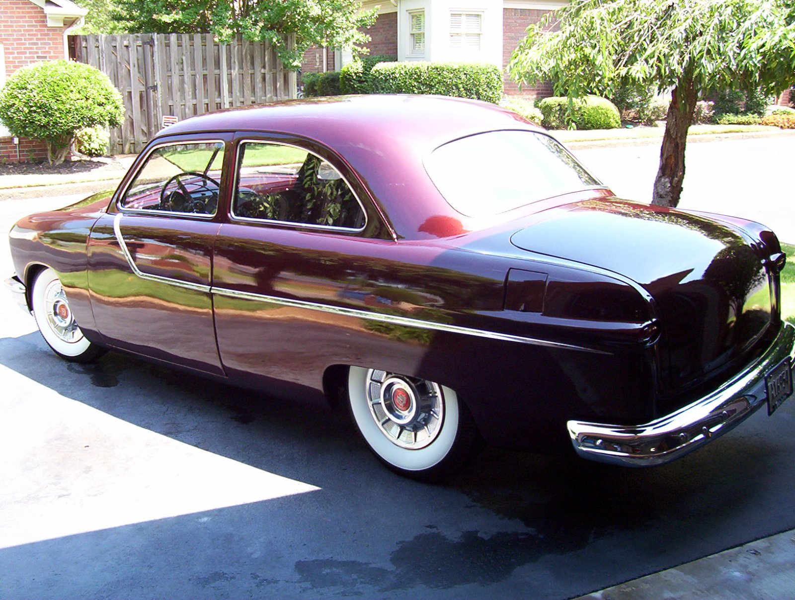

    I'm running a 66 mustang 8 inch in mine. Slightly wider than stock but not enough to matter. Easy to find too. 20240428_120558.jpg
