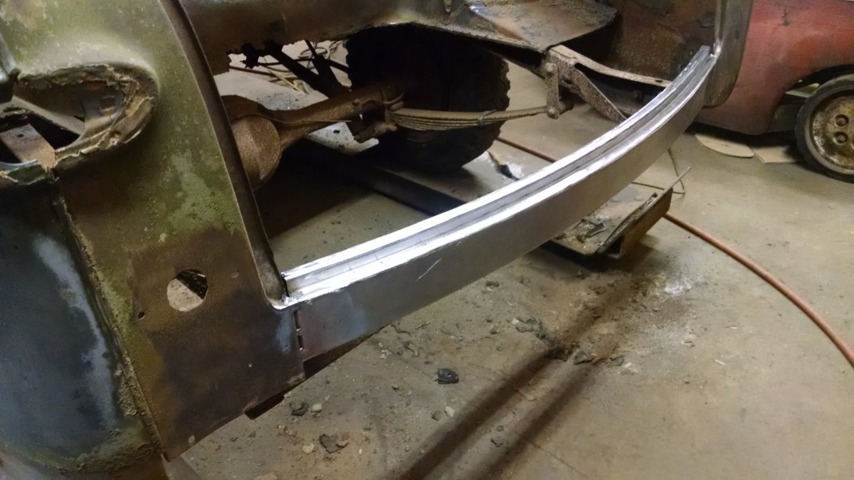

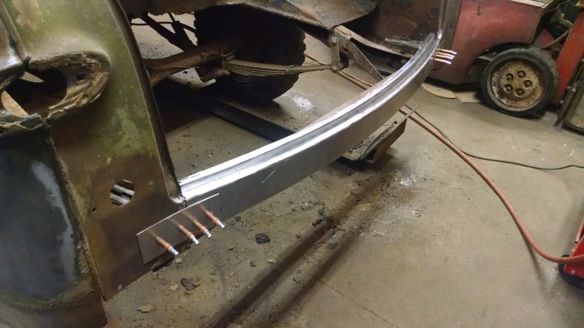

    here is what I made for my 49
    IMG_20151103_161538356.jpg IMG_20151104_132914430.jpg IMG_20151104_134740432.jpg IMG_20151106_164235210_HDR.jpg

    I cut holes to the inner panel.It will be a lot easier to paint it from the inside and it will be a lot easier to clean it in the future from the inside.Its a curvy piece,so the shrinker/stretcher was handy with this one.
