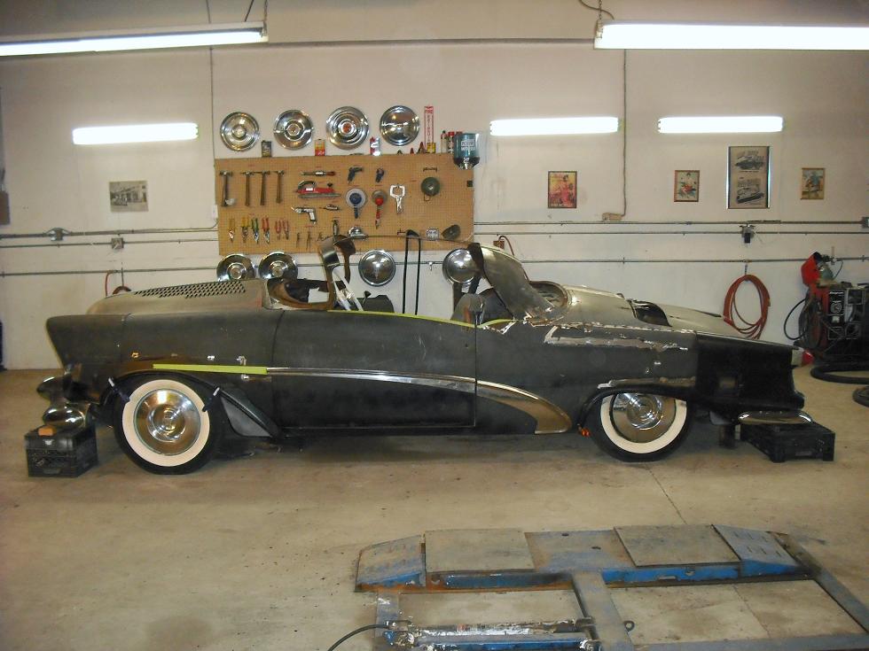

    after a week of thinking, i figured out how the back of the car is gonna come together...i needed to widen the roof and deck area and figure out how to make it flow into the quarters,,,it took some real figuring,,but i am happy with what i came up with,,,its just tacked at this point,,and i need to lenghten the trunk a bit,,but all in all,,it worked out pretty well...the bumpers will be made into bumperettes,,they will wrap around into the rear pan,,,i need to get more welding gas this week,,and then it'll be WELD, WELD, WELD....

    what are ya gonna put on the sides of the quarters to roll into the decklid?

    the quarters roll right into the deck because of the way i tapered them,,,no filler pieces needed,,,,i thought id have to fab up some rolls,,,but turns out i wont need them,,,

    ohhh so the lids gonna sit up form where it is at now? level with the orig piece with the little rain guter

    So you're not going to use the shoebox rear window glass? What are you going to use to fill the widened rear window hole? Or am I missing something?

    the window opening is the original metal from the shoebox,,its chopped around 2 1/2 and stretched approx 4 1/2 in width,,,,,,,,,i have two options for glass,,,,one is lexan,,,the other is an interesting idea i saw on a hamb tech thread,,should be pretty easy to do,,find a windshield with the same curve as the rear glass,,use the rear glass as a template and move it around the windshield until the curves match,,then trim away the glass i dont need,,,,one other option would be to cut the frame out and weld it back together in the stock width and graft it to the roof and use filler pieces around it,,,i think it looks good wide like that,,so it'll most likely stay as it is,,,

    probably gonna drop it another inch all around,,,,,dont want it draggin on the ground,,,not the right look for the car,,,,its gonna have a concept car/autorama vibe (hopefully)

    Just one thing - I´m looking at the way the rear catwalk now rolls down into the rear quarters and it seems somewhat undefined - like the shape of the rear fenders needs to be extended more towards the roof, so it doesn´t just roll straight from the side of the car into the top. Or simply a piece of chrome to divide the two panels. Am I making any sense here??

    I was thinking the same thing it's almost like the top just keeps going straight down into the quarter panetl. Tough to see in the pictures but that was my first thought when I saw them as well.

    I just have one comment though. I was looking at the flow of it all,&#12288;and was trying to figure out what I didnt like about the profile and kept on looking at the rear quaters, but its not the rear quaters its the bonnet, It totally goes the wrong way, it needs to be dropped where it meets the screen, I think it upsets the whole thing.

    makes total sense,,,i do have a plan for that,,,

    true about the hood,,,instead of lowering the rear part..i may raise the front a tad,,,
    have to see how it looks,,,it does slope too much as it is now..
