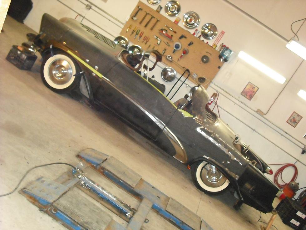

    fixed the problem with the hood today.....coupla pics,,,,,,,,,,,,,,,,

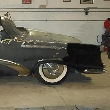

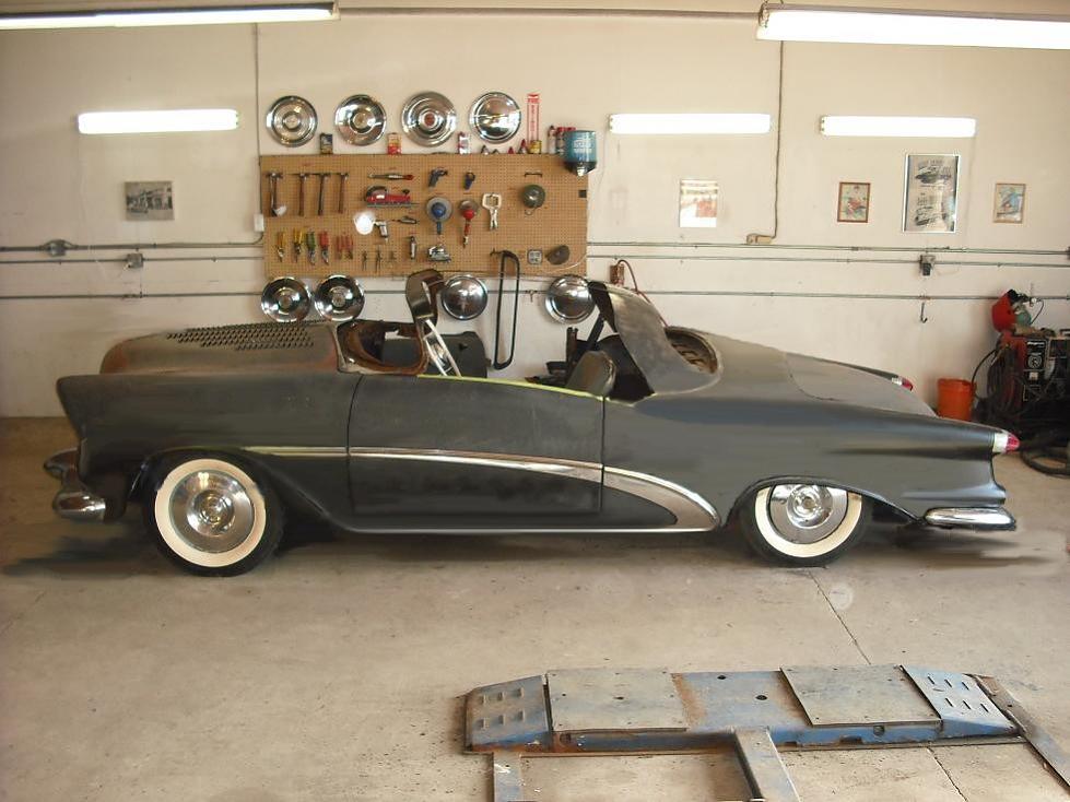

    Still think the whole rear area is too low and drops away too much...the front fender line sits a good four inches above the equivalent line on the rear fenders, if you look at factory cars of the day, they never did that and theres a good reason for it, it creates a 'broken' look. I wish i could photoshop to show you what i mean..
    take or leave this opinion, the amount of bodywork you are creating for yourself is staggering, and to be commended!
  11. totally understand what your saying here, but i think with the side trim it works if you look at the photoshop version. You could also raise the boot to offset the rapid downturn.
  12. Kustom7777
    Posts: 5,188
    Kustom7777
    from Austin, TX
    with the side trim and the downward swoop of the door, i think the downward taper of the quarter compliments/mimics the shapes...i do understand what you are saying though

  15. twochops
    Joined: Feb 28, 2006
    Posts: 1,510
    twochops
    rear 1/4 taillight raised about 3-4 inches
  16. Kustom7777
    Posts: 5,188
    Kustom7777
    from Austin, TX
    definitely doesn't work for me,,,,,
    thanks for doing that,,,,i knew i wouldnt like it,,,seeing it confirms that,,,,
    i was holding a pencil on my monitor trying to visualize that,,did not look good..

    I also prefer the 'real' mockup, but...
    I would adjust the bottom of the rear quarters, so those two little 'lines' that develop behind the rear tire, 6" below the tail lights, are level with the ground and bottom of the door. Keep the arc/droop of the line into the taillight, but straighten below.
    And the roof? What's gonna happen there?

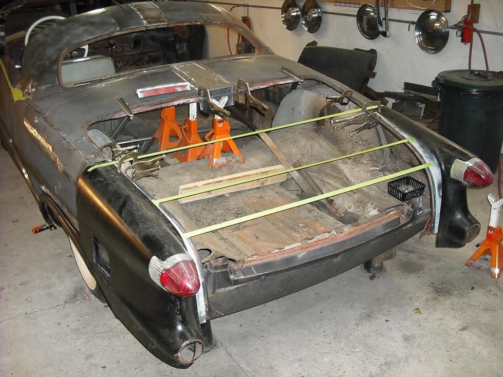

    today's progress,,,,,,,,,,,adding trunk channel,reforming the stock shoebox trunk channel to accomodate the widening of the decklid,,,i plan to quarter the decklid, and splice pieces in from a spare decklid,,spliced in a piece of trunk channel into the widened catwalk..
  27. Kustom7777
    Posts: 5,188
    Kustom7777
    from Austin, TX
    everything will be straight when i finish weld it,,,its just tacked right now,,,it may have shifted a tad.....
