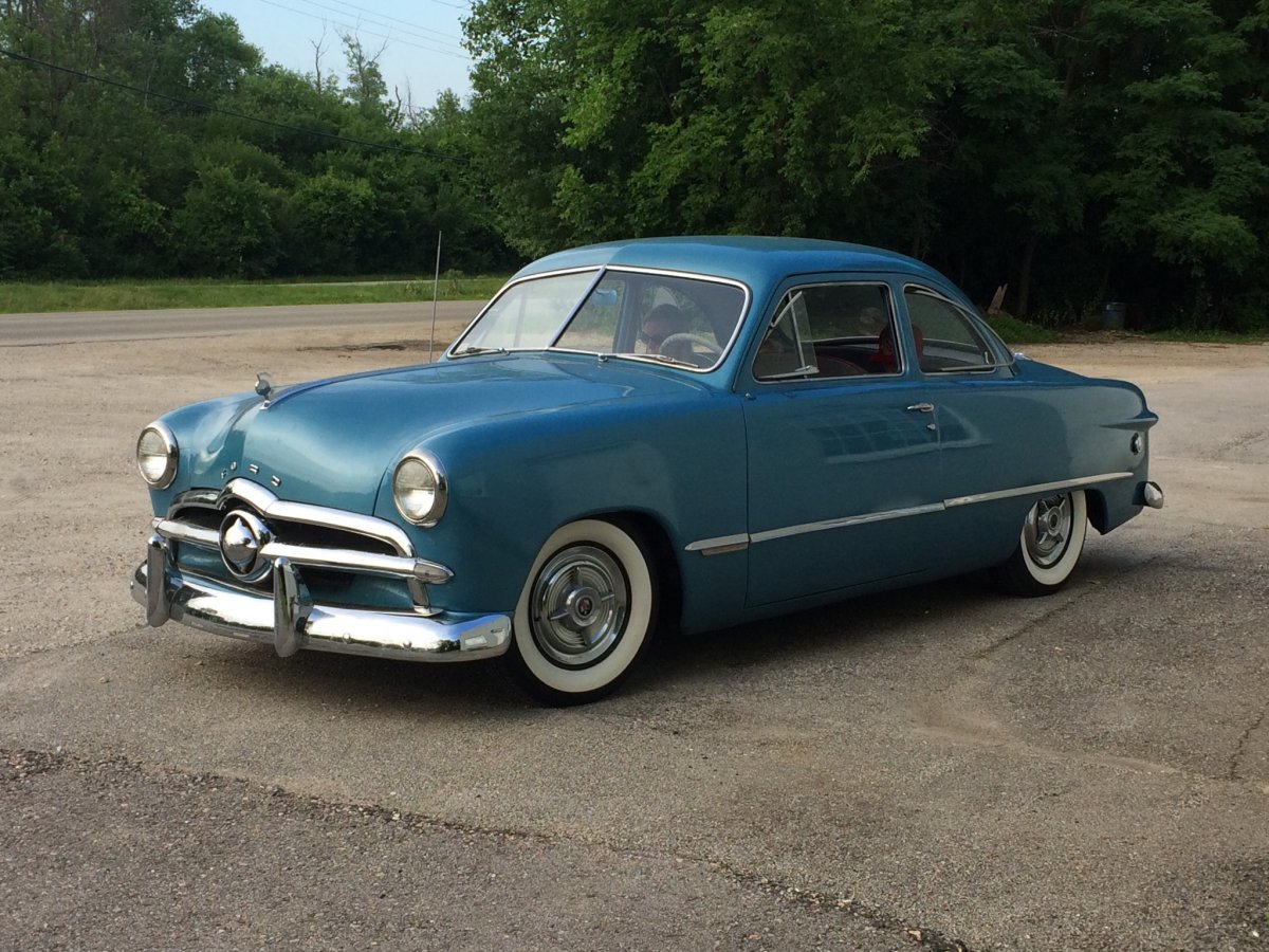

    Joined: Jun 23, 2020
    Posts: 2,678
    210superair
    from Michigan
    20200731_083334.jpg a shot of how my 51 sits. I think similar to what you're thinkin....maybe not quite as low in back as you want....
    Okie Pete, CyaNide and Surfcityrocker like this.
