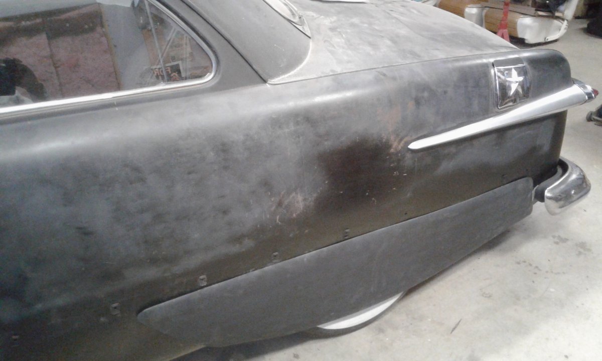

    Progress is slow but I got some done. Got the rear corner back into shape and bolted the Tbird rear end in with 2in blocks. They already have 2in lowering perches , so its now 4in lower. 20200904_080945.jpg 20200829_121741.jpg 20200829_130137.jpg 20200829_130137.jpg 20200829_130612.jpg

    Its been a while but I am making slow progress .Collision damage is repaired and the rear bumper is on . Mocked up the skirts . 20210110_154001.jpg 20210110_154026.jpg 20210110_164332.jpg 20210110_154026.jpg 20210110_164332.jpg

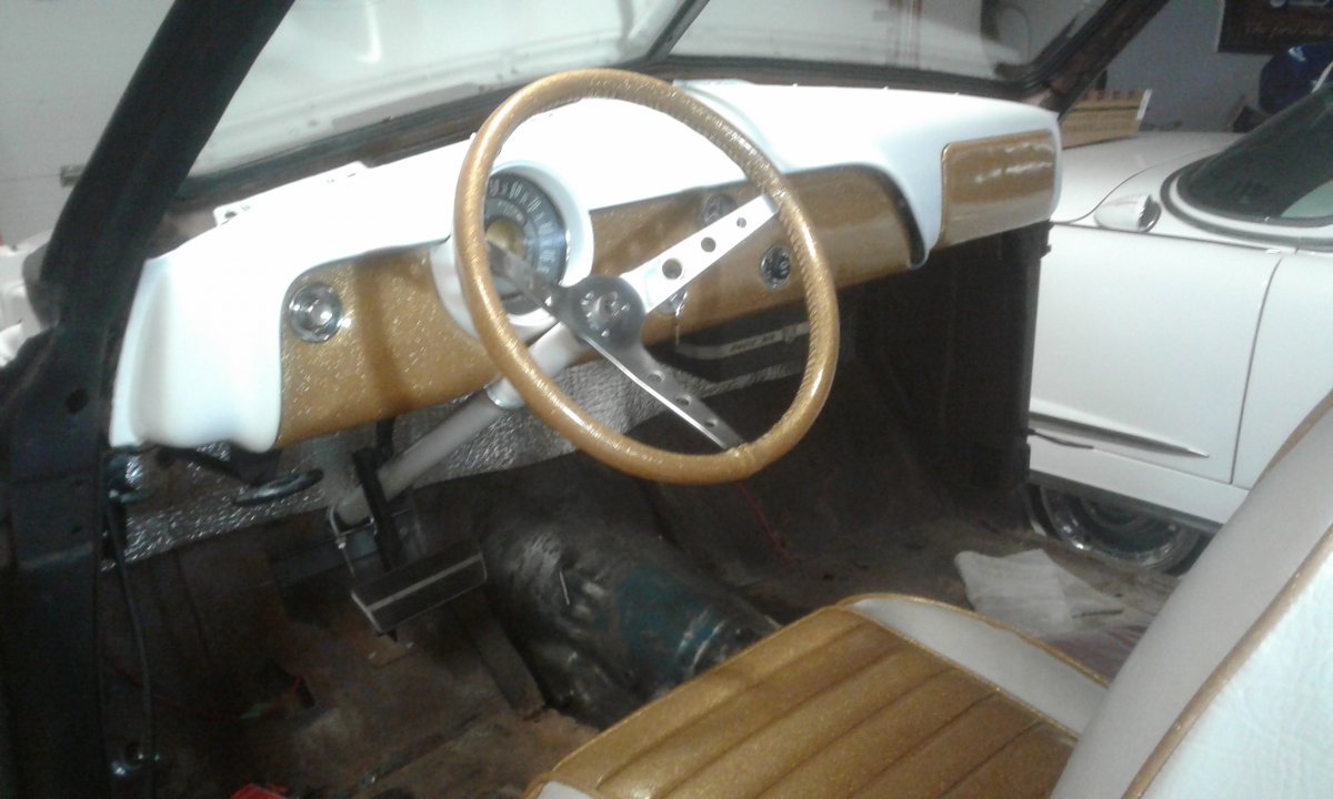

    Did you put any quick disconnects in to facilitate removing the dash again? I did and that enabled me to wire the dash on the bench, install it then plug it in. I used 6 pin trailer connectors.

    I love the Gold flake/Pearl white interior, the dash is amazing! Very cool

    I pre wired the dash before installation. Left the wires long enough to hook up. Good idea with the plugs though
    warhorseracing likes this.
