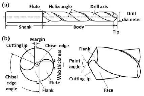

    1st is to understand the geometry of the point. You can't sharpen a bit without knowing and understanding it. 2nd when drilling a pilot hole the starting bit should be the thickness of the web of the finial size bit. Also you need a grinding gauge to get good points.
    4-11_drill_bit_geometry.jpg Drill-bit-geometry-a-twist-drill-bit-and-b-drill-bit-tip-11.png
    continentaljohn likes this.

  10. ??? What is the thickness of the web of the bit??? The center part of the bit, the thickness of the material there between the flutes? Just hold up the intended pilot bit and compare to the very center thickness of the final size bit? I think that's what you are getting at.
    Interesting. I never knew. Learning quite a bit here.

    This shows the web. It does no cutting.
    https://www.google.com/search?q=wha...rome..69i57.8079j1j4&sourceid=chrome&ie=UTF-8
    You are correct in your ***umption about selection of the pilot drill in relation to the size of the web. However, it's always best to drill a pilot smaller in dia. than the web when drilling larger holes over 1/4 in. to increase accuracy.

    "??? What is the thickness of the web of the bit???"
    Little publicized or discussed. It varies. The web gets thicker as the drill gets shorter.
    It is a whole other science to properly narrow the web to keep the drilling pressure down
    and 2 clean chips coming off.
