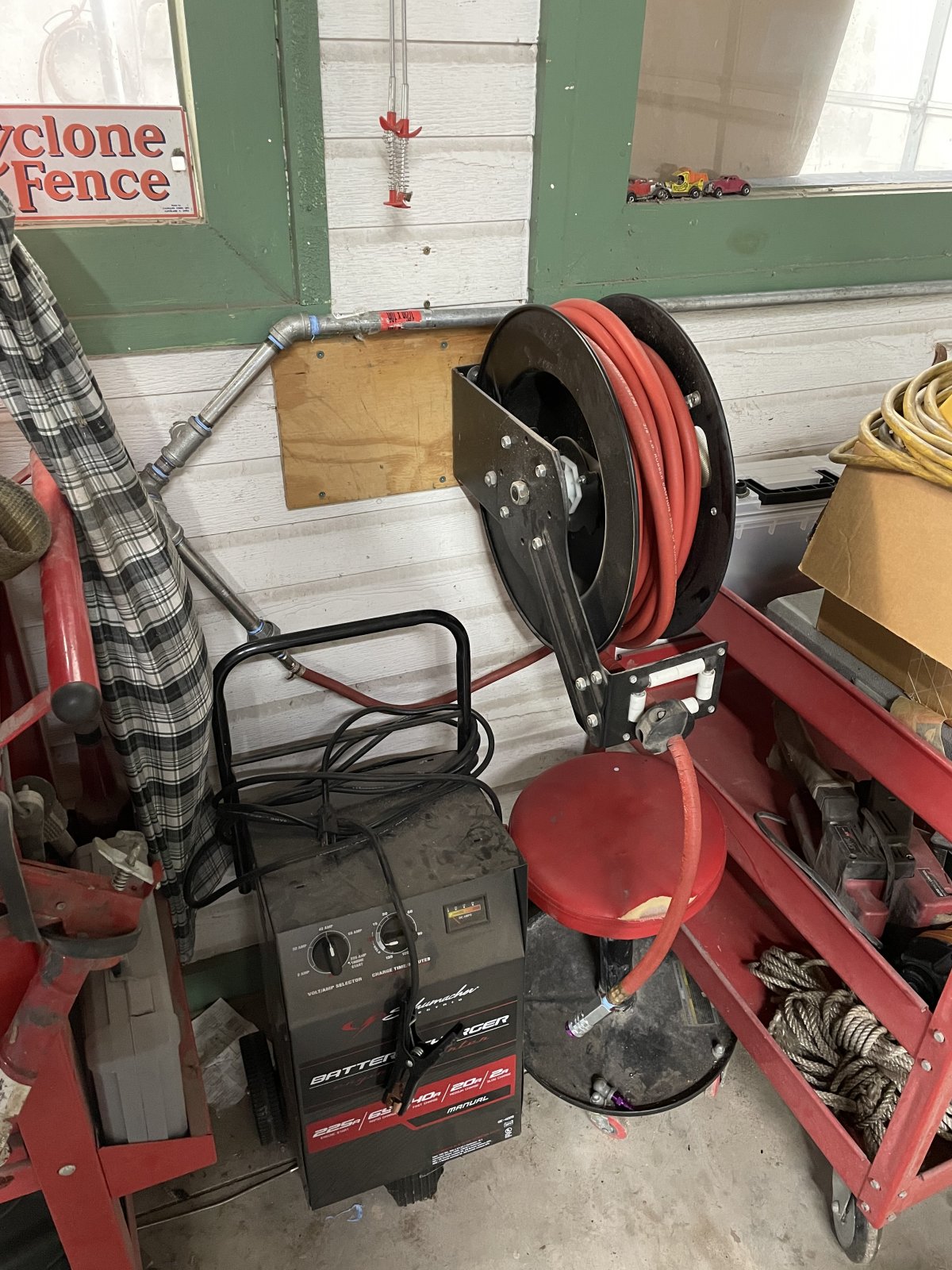

  4. Hose reel was bought before I built the shop and installed first thing. Didn't help with the mess, still have one.

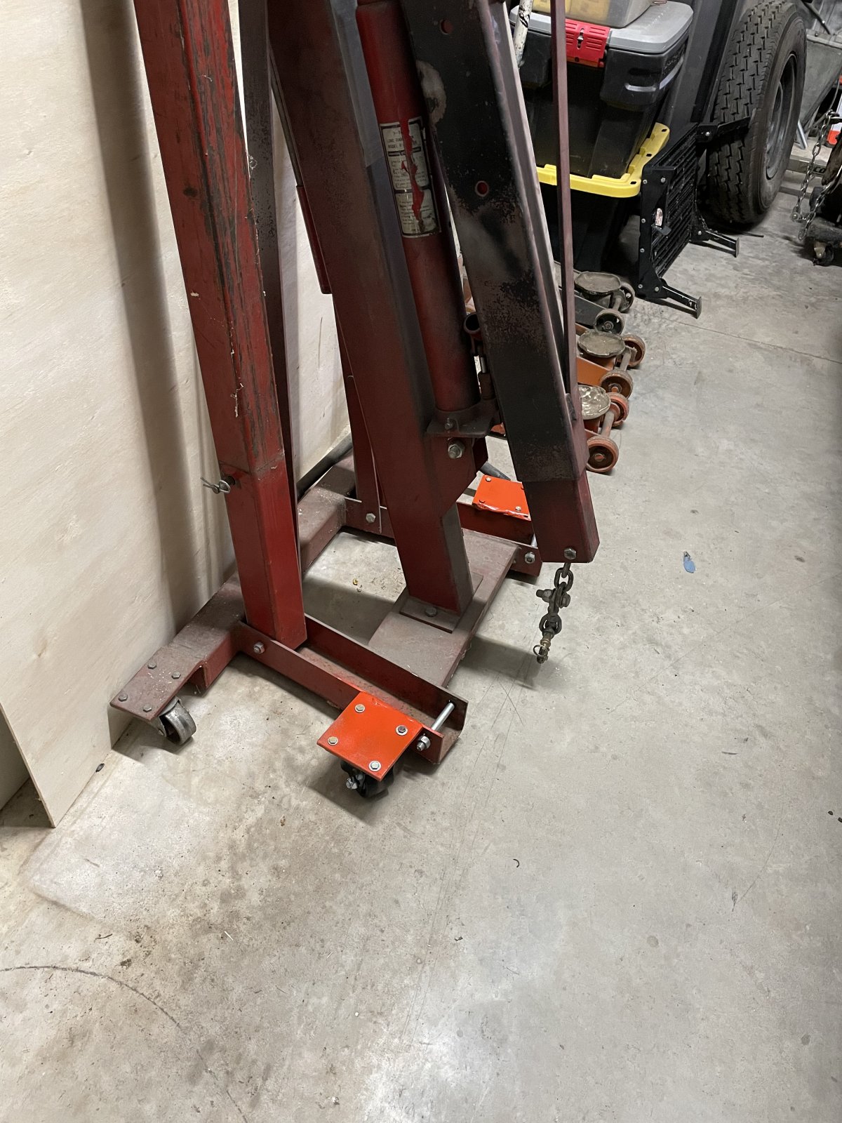

    Ok, here it is in all it’s glory. My hose.
    And here is the mod to the cherry picker. First time in 30 years this thing has been folded up.

    I need to do that to my cherry picker. It’s always in the way.

    Took me about an hour, saves about 10 sf.

    I like the low casters too. Fits better under the vehicle. Hmmm.

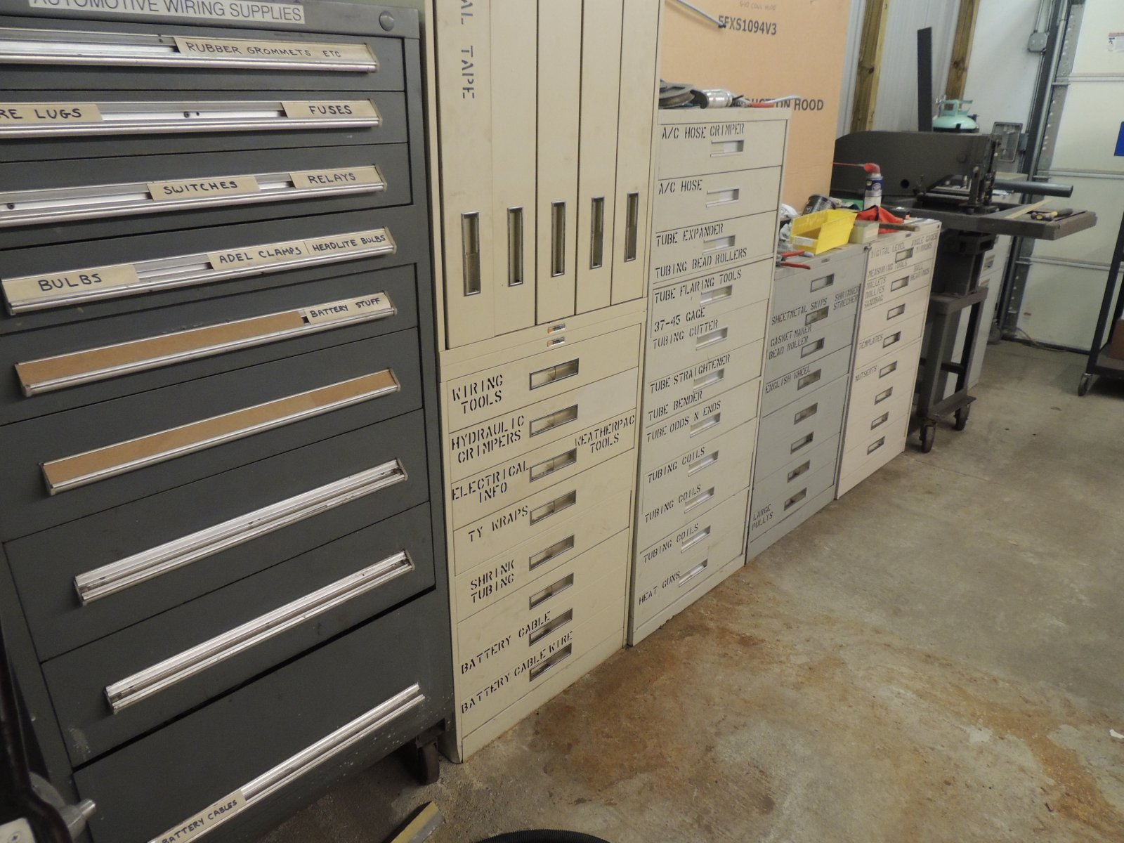

    This is just 3 of the 4 drawers in one of my 30 + filing cabinets. It`s under my pallet rack. You gotta be organized. IMG_20211017_0004.jpg

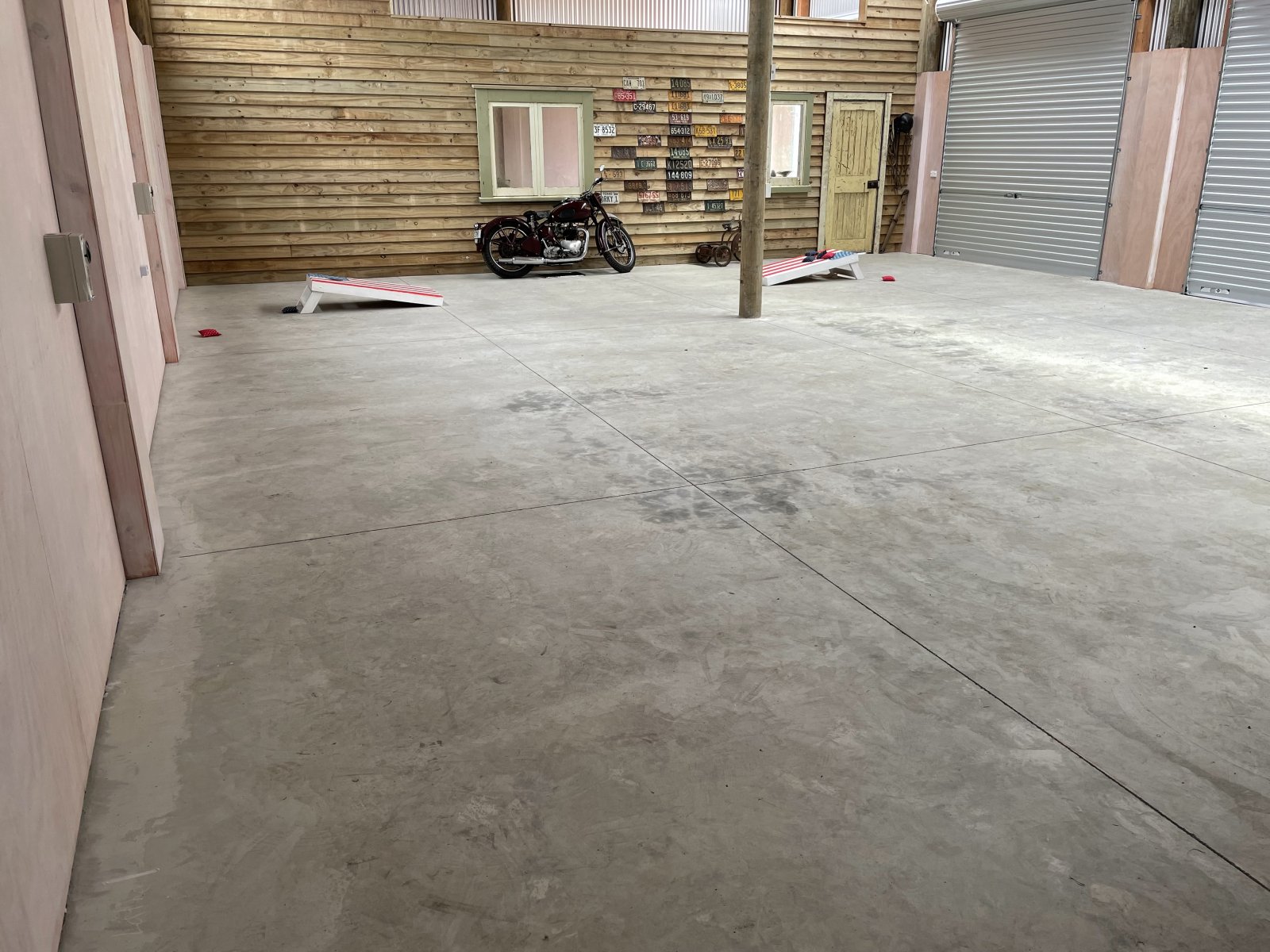

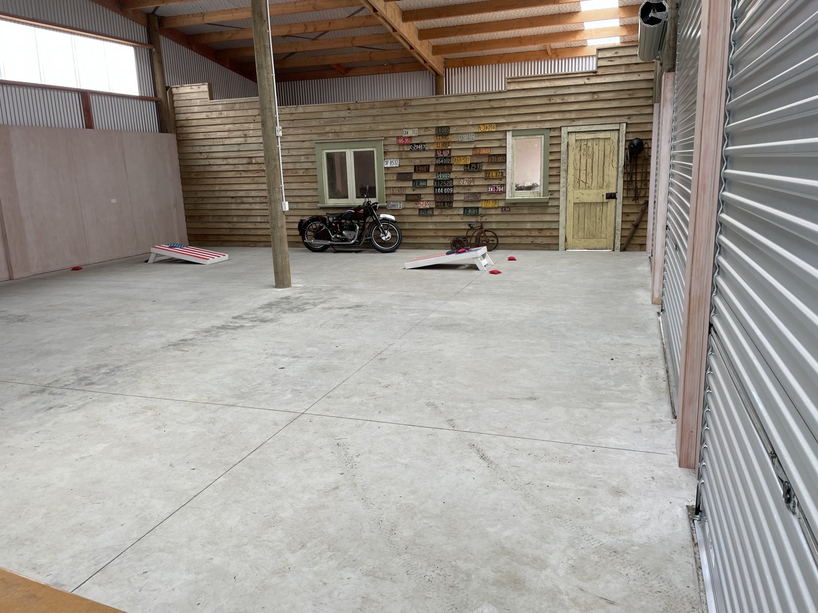

    Mostly a blank canvas start. The end inside shed is 430 sq ft for a couple of 32s. My old shop of 40 plus years is behind me and has a double door walkway, that’s 581sq ft. All up now 2281 sq ft. Loading gear in today. Lift lathe and other gear to follow.Just trying to work out the best place to install equipment. A small gathering to welcome the new space.

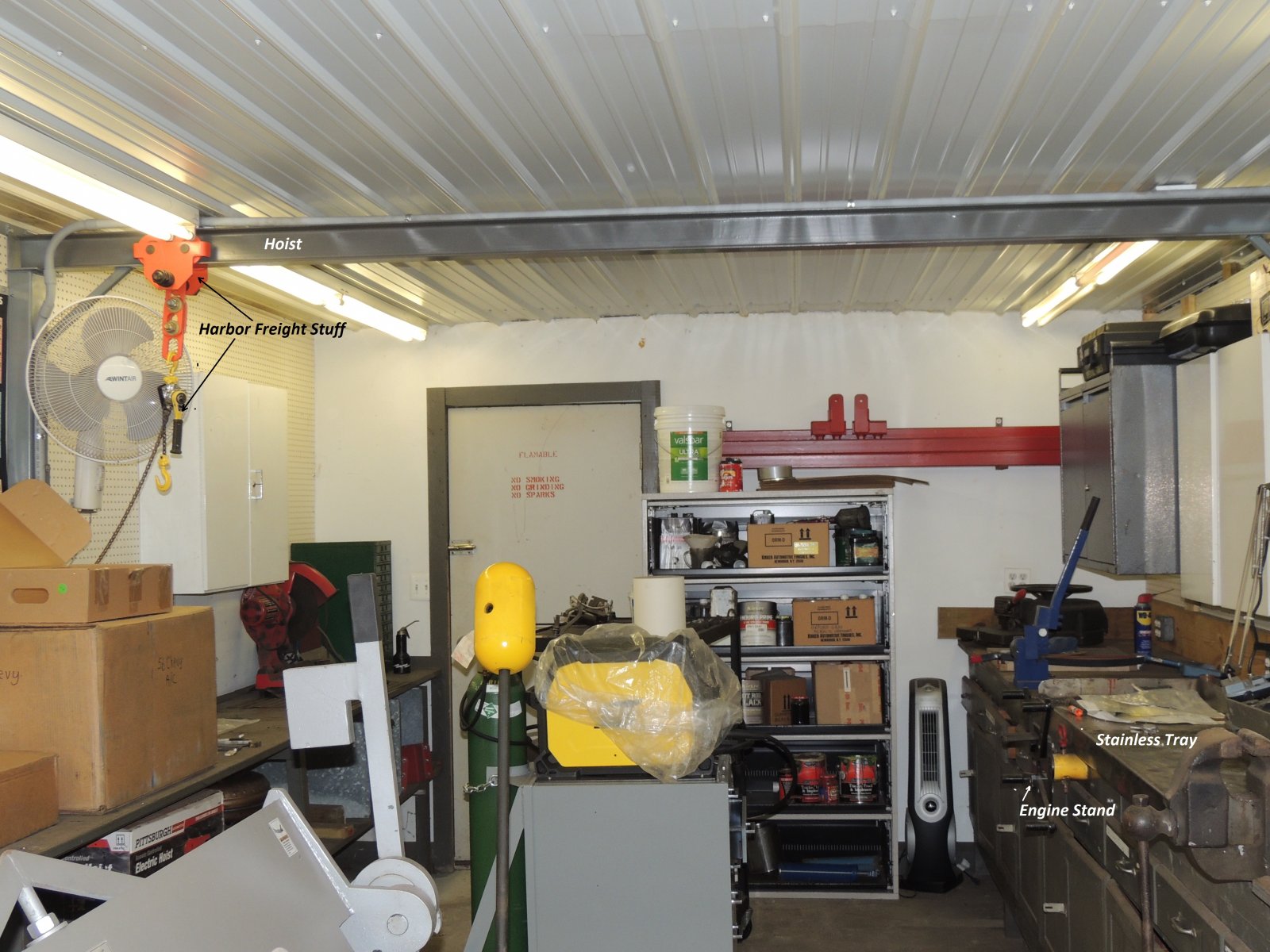

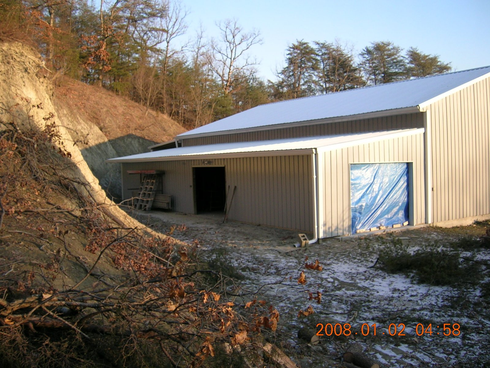

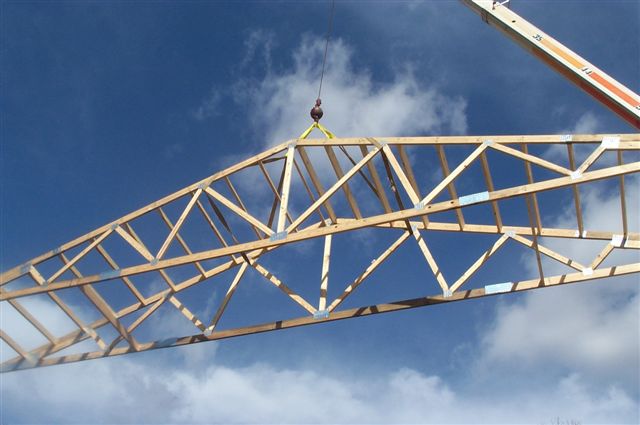

    I've posted them before, but I'll do it again. The lean-to is super simple. Just put some 4x4 posts in the ground next to your building and screw them to the building with lag screws. May need to counterbore a hole part way thru and need to hit a stud in the buildings wall. Then put a double plate on top of the 4x4s to set the rafters on.
    Build a 2x4 wall on the ground and stand it up for the outside wall. When the floor is poured, put some threaded rod in place to anchor the outside wall. The wall should be just high enough to allow water to run off. 8' outer wall and a 10' or whatever the building allows for the inner support.
    I used 16 foot 2x6s for a roof and put 2x4s every 2 feet as cross supports for the metal roof. Takes time, but works good. In NY if you have heavier snow loads, you might scab two 2x6s together every 3rd rafter for a little extra strength. Electric outlets are cheap. I put them on every stud about 4' off the ground. You can buy the box and outlets and have your BIL show you how. Then each box only costs a few ($5) for parts. Later you will find that you always have a convenient outlet no matter where you put a power tool.
    The eight foot door is good between buildings. You might consider one on the end as well. You can put a car in if needed.
    I'd keep that lathe and put it in the lean-to. Thats a nice lathe for a shop. If the mill isn't s****, just buy an aftermarket DRO for it.

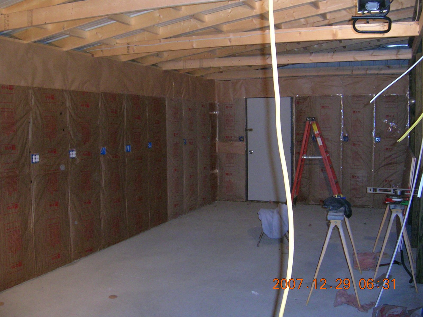

    You can see how simple the framing is here.
    How that one end looks now.

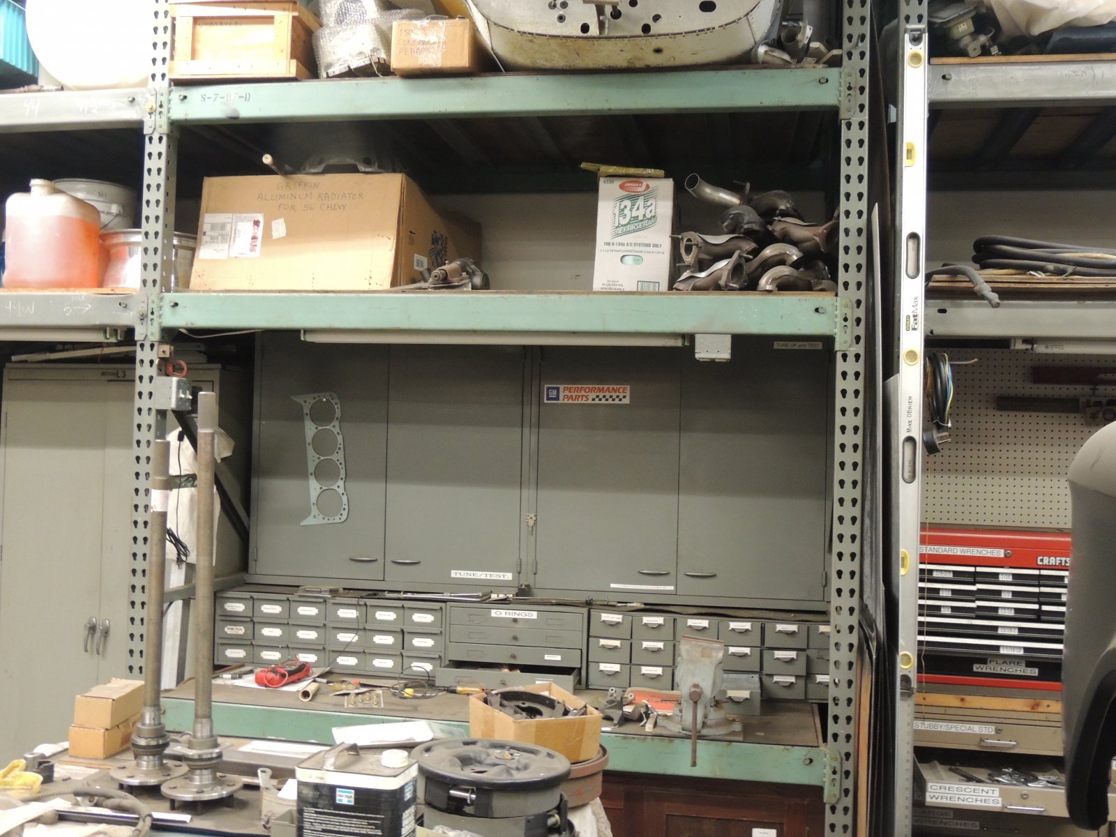

    Part of the opposite end. Notice the simple 4x4 posts to support the roof. Don't need high ceiling that lets the heat rise up.

    Looks organized. I like it.

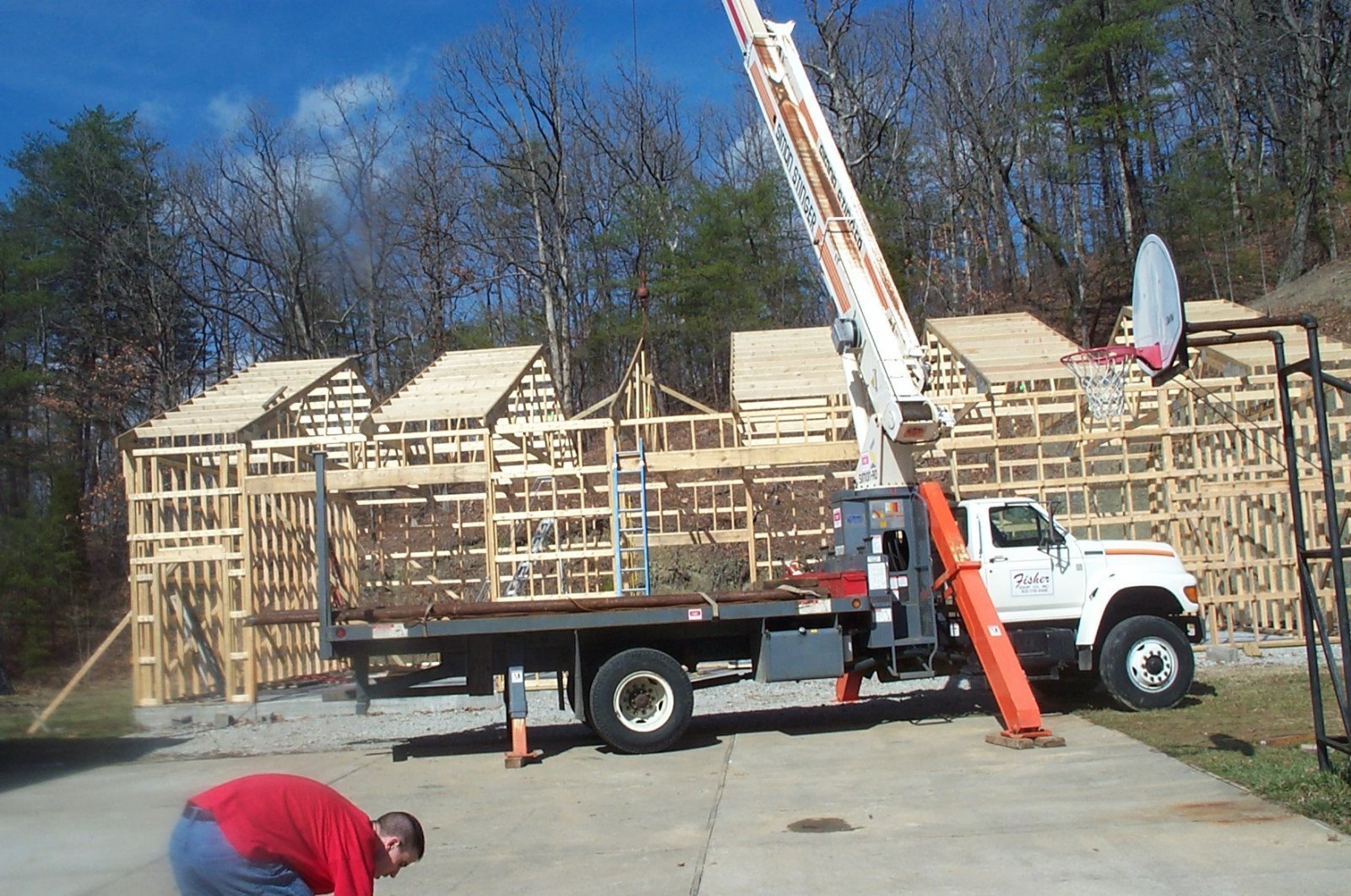

    There just bushes.........:D Honestly, once you add something like a lean-to, it just transforms a shop. All those things that are in the way can be put on wheels, and heavy things like lathes and mills can be put in there permanently. The thing is that its much easier and cheaper to build a leanto than a complete building. When I built my pole barn, it had 40' trusses. They would be difficult to lift in place and take several people. Guy around the corner was building one and wind blew all his trsses over and damaged them. I took mine and put purlins between them so they were in pairs. Then had a crane come lift them in place. Only took about an hour to set all of them on the walls............but still it was a lot more costly and involved than laying 2x6s in place by myself. Thats why I push for guys to look at lean-tos. They really add space cheaply and easily. If the zoning is a problem or finances are low, one can build a car port. Then later on add the walls .......
    Once you have a basic structure, adding a lean-to is so much easier than building another structure.
