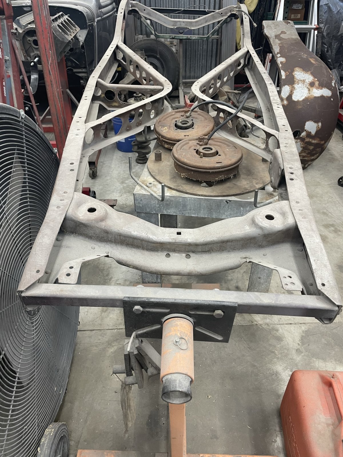

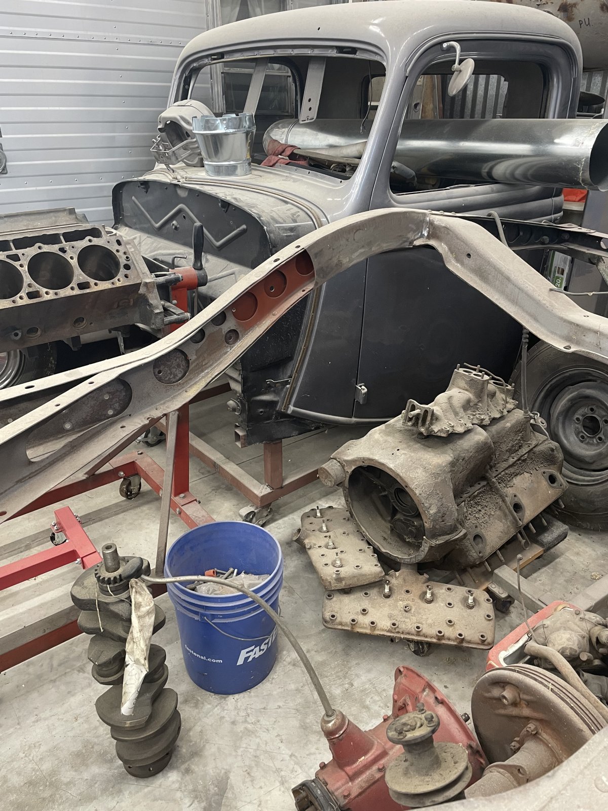

    Here's the deal. I have my 36 pickup blown apart into a thousand pieces. The frame is on a couple of engine stands, the cab is on a dolly, the bed is leaned up against the wall, fenders are strewn about.
    I need to build something that has a low center of gravity that I can mount the bare frame to, since there is no suspension. The frame has a tendency to want to flip over on the engine dollies I have now, so that would be even more exaggerated if I mounted a cab and bed.
    I figure I can't be the only guy to have this issue, so post up some pics of your solutions. I want mine to be mobile until I have the time/money to get back to it.

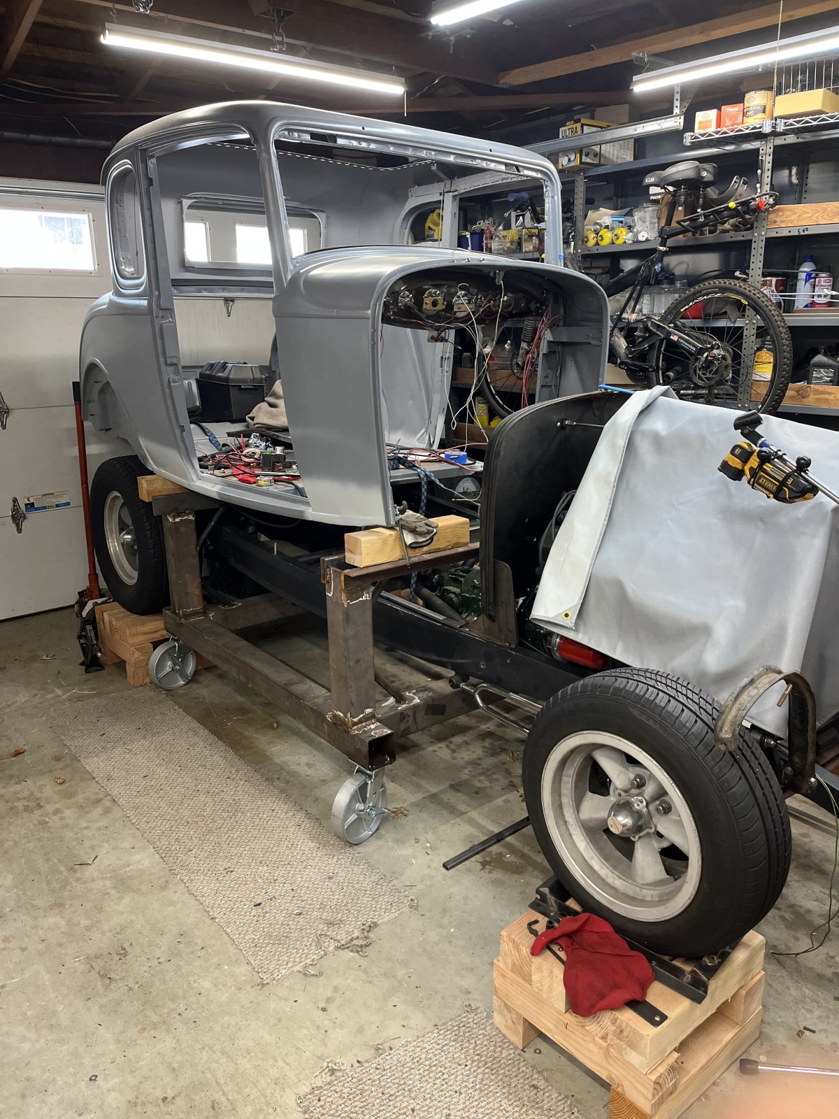

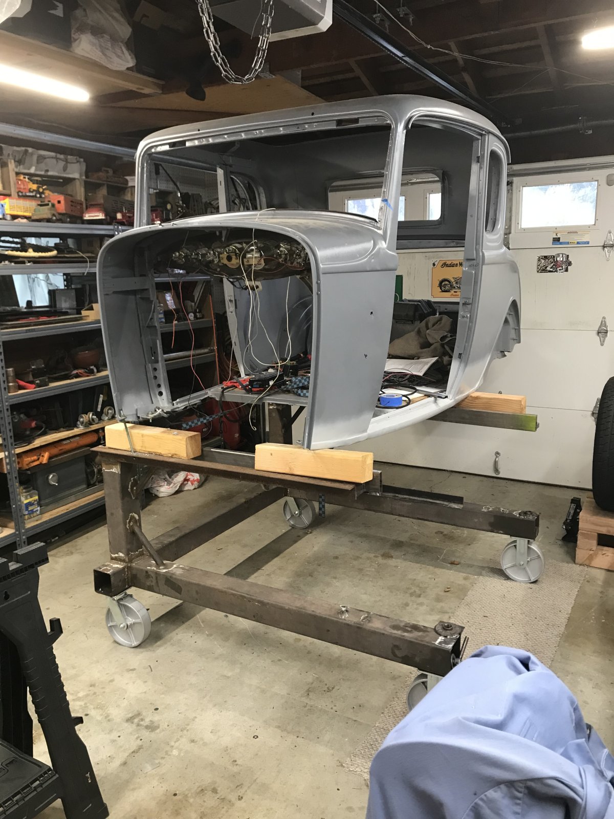

    Chris, @nochop built this body dolly cantilevered so he can park his wife's car in the garage every night.
    I copied the pics off his blow-it-apart thread, 'cause it's a great idea and plagerism is the greatest form of flattery.:D

    I saved those photos, That is a nice setup for small bodys in tight spaces.

    Standard 8ft ceiling

  24. Roothawg
    Joined: Mar 14, 2001
    Posts: 26,034
    Roothawg

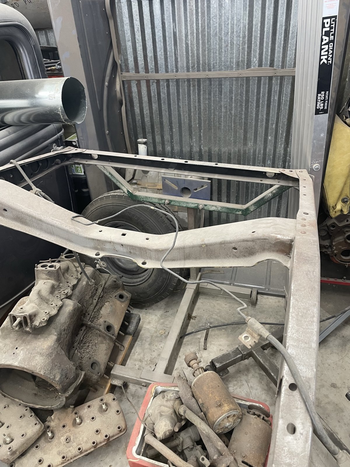

    This is what I have now. Note the parts explosion around it.
    F97C8AE2-1D73-436F-A690-24883B111E91.jpeg 4DB051B5-C1B7-4791-A142-4F96ED47BD11.jpeg 0ADFD460-CD25-4C60-9605-E28BBC80D1E8.jpeg

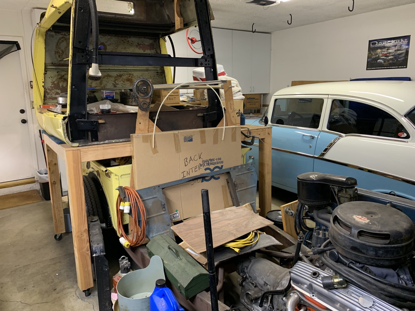

  25. Johnny Gee
    Joined: Dec 3, 2009
    Posts: 14,420
    Johnny Gee
    from Downey, Ca
    Sadly the 32 pick up has become the catch all but you can see the rolling table the cab sits on. DCB03B15-3BC3-479E-8D9C-8B8BBB13CBBF.jpeg

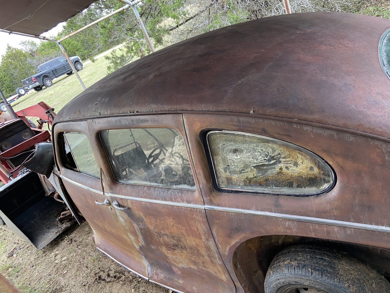

    My neighbor complained about my quarter panel leaning against Her brick wall. A**** other things. She did a land survey to prove her point. Be careful what you put outside. IMG_5846.JPG

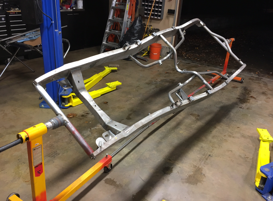

    You gotta tie the engine stands together buddy. Otherwise they flop all over like nuts on a Great Dane.
    I'm not sure if my U joint on this end helped or not so I will say it did...definitely. :cool:
