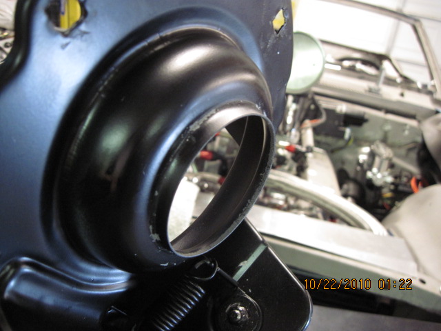

    Heres a low-buk hole press.
    I used it to enlarge the back of some head lite buckets

    What are those pieces originally?
    That looks like it'd be remarkably easy to use as a radius die.
    -Brad

    They are just PVC fittings from the hardware store,,

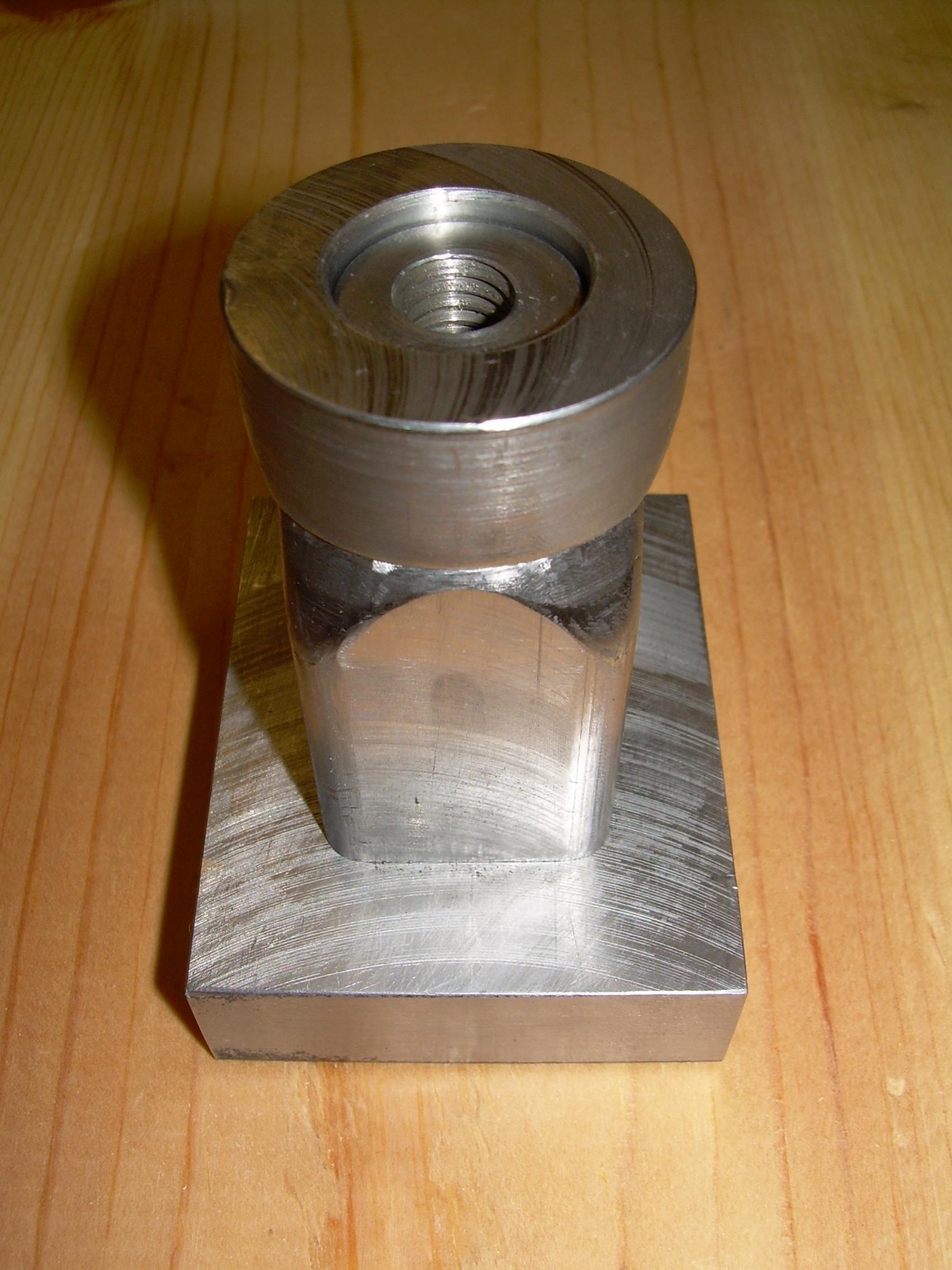

    Here's a pretty basic form tool for forming tubing for header flange tubing transition from rectangle to round.
