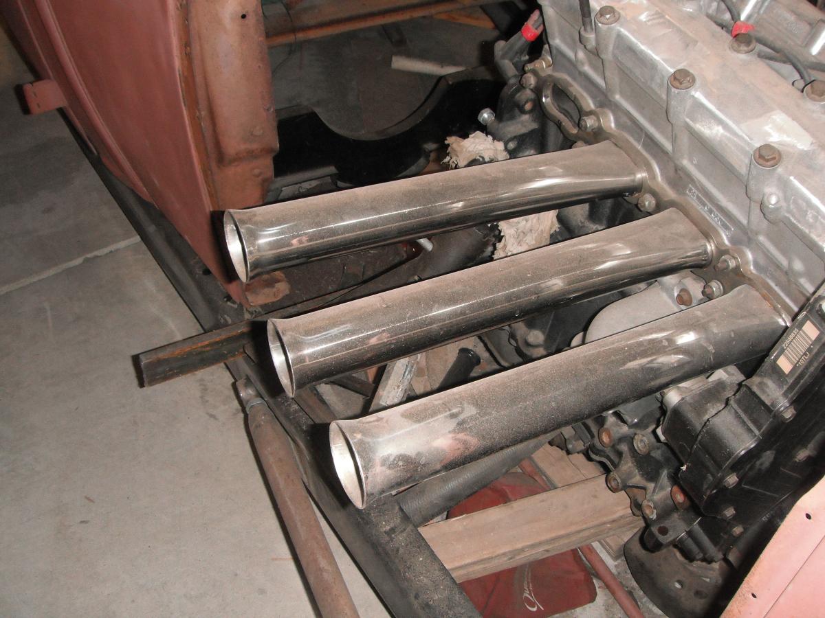

    Think I may have the cheapest tooling here yet.
    This is the wheel off my hand cart, pressed the stainless into it to get the flare.
    This is the header, made matching intakes for the Webers on the other side.
    Look closely at the middle pic and you will see the exhaust flange side, that was made by forcing 2 sockets apart with a cold chisel between them in the press also.

  4. lawman
    Joined: Sep 19, 2006
    Posts: 2,665
    lawman
    That's GREAT !!!!!! That is Home made !!!!!!

  6. iammarvin
    Joined: Oct 7, 2009
    Posts: 1,196
    iammarvin
    from Tulare, Ca
    Ummm...Thank you!? It just needed to pressed (Forced) that way.
