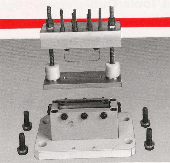

    I think the die set you have pictured would work if you made a slice for each louver instead of using the die to shear. Then the dies will self center and just slide down the cut. I would also find a way to bolt the lower bed solid to the uprights.

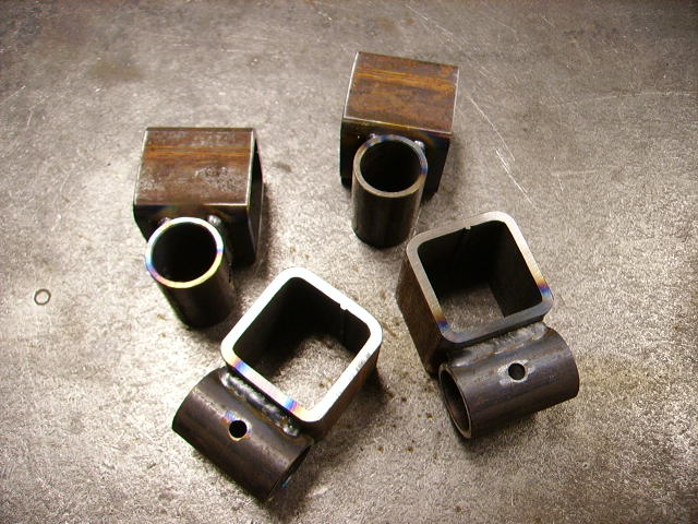

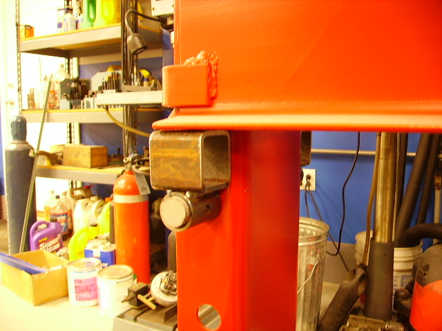

    I always find that the upper table elevation holes are too high and the next set of holes are too low. I needed a way to locate the table half way between these holes. Instead of drilling new holes between, I made these spacers from 2" square tube and some pipe. Slip them over the cross pins and you can locate the table half way between the existing holes. This can save a lot of needless pumping on the jack handle.
