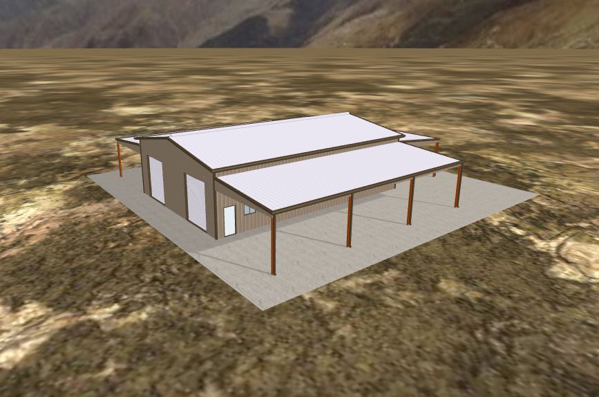

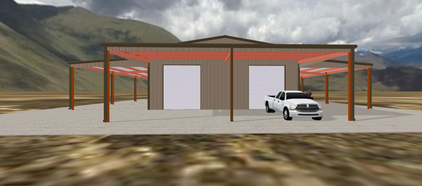

  27. I was quoted $145k turn key for a 40'x60'x16' with 20' lean-to canopies on 3 sides, 4x 10'x12' garage doors, 2x walk-in doors, and 4x windows. That's a 80'x80' slab, spray foam on walls & ceilings, basic plumbing, & electrical. A pretty basic building overall, nothing fancy. The concrete was over half the cost of the total price. I'm considering a smaller slab with just gravel under 2 of the lean-to's to reduce the cost. I can add concrete later.
    This doesn't include the septic system, bathroom, fixtures, or lighting. My plan is to park an RV under the canopy and live in it while I build a small cabin next door. No restrictions means I can do whatever I want on my land.
