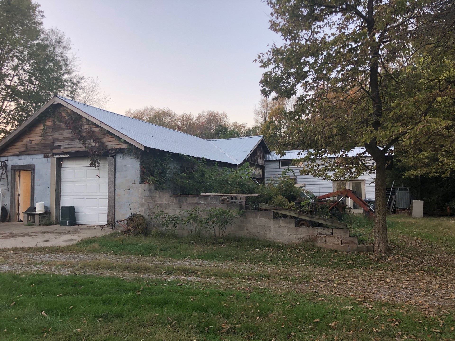

    A little history before we get started. This has been my shop for about 40 years. Before that it was a machine shop with drivelines in the ceiling and belts connecting the machines. The building was unused about 20 years before I bought it. So, as you can imagine it was the falling down building no one wanted.
    In the original post you asked for pictures, inside and out, plus dimensions to give you an idea of space. Bear with me as I try to explain pictures and the size of areas seen.
    The first picture is the front or south elevation, the original machine shop is 24'x60'. The block walls are 9', the interior center height is 11'. The front (south elevation) overhead door is 8'x8', the east elevation has a 10'x10' overhead door. To the right or eastside I added a 14'x24' area. This became my wood working area. To the left or westside I added a 12'x24' lean to. Later I sealed that space and brought the roof line to match the original machine shop. This space is hold's my metal working equipment. Next post will have indoor pictures.
    ras

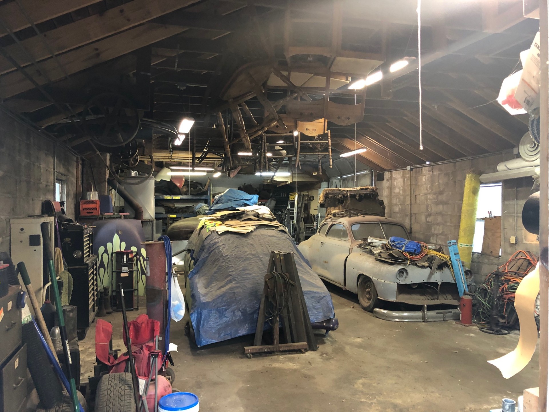

    I now have 3 to 3 1/2 cars in my shop plus tools, plus parts, plus some house stuff.
    This picture I'm standing in the front or south elevation's service door looking north. The 24'x60' space. The gray car is a 47 Desoto, under the tarp is a 50 Olds, and you can barely see a rear fender of a 41 Desoto in the back. So, no small cars. in the front of the 47 is my 8'x8' overhead door, I could pull in another car if needed. Between the 41 and the other two is my 10'x10'overhead. This is where I bring in the daily driver if needed.

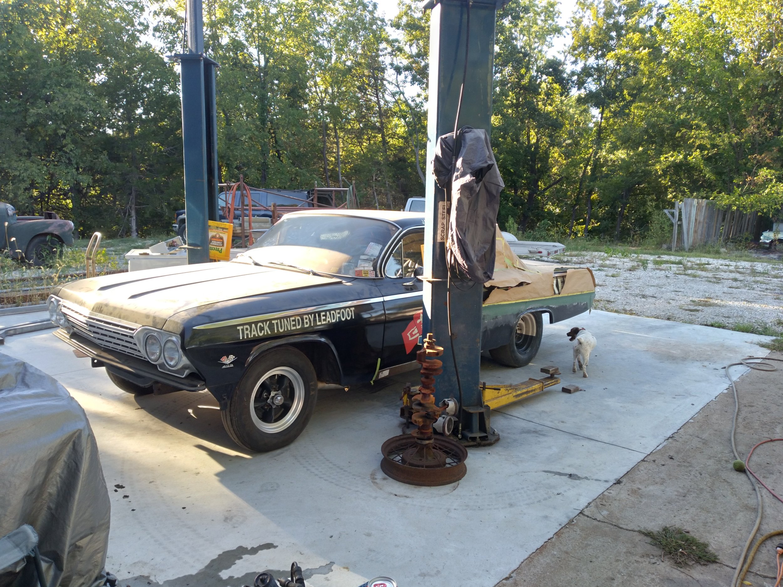

    I am going with a 24x31 carport. I had a bunch of dirt work done and a retaining wall put up. This is the north side of my house and plan to close the west wall and what little of the carport that will be espoused to the south. then plan on a lean-to on the east side to cover the the drive in my ba*****t. This will be a fair weather shop as I have my ba*****t to work in if weather get to cold.
    You can tell by the stain on the ba*****t wall how much dirt I had to move.
    I went with a 26x35 pad. 20230412_194408.jpg I bought a used carport and had to build taller legs to have the height I need at the walls for my lift.
    This is how it will fit up to my house.
    The poles will be just to the right side of the lift so the other half has plenty of room for a car on the other side of the lift.
    I was lucky that all of the cost so far has been funded by my sales on the market place. I do still need to buy metal for the roof. This carport had horizonal roofing and I will build it with vertical as I believe that is the best way to run the ribs for water and snow control. I think the roofing that came with this used carport will be enough to cover the roof on the back half and the wall to the west. This will give me new metal to do the front for better curb appeal.
    If someone is looking at the back side I need to know what their intensions are.
