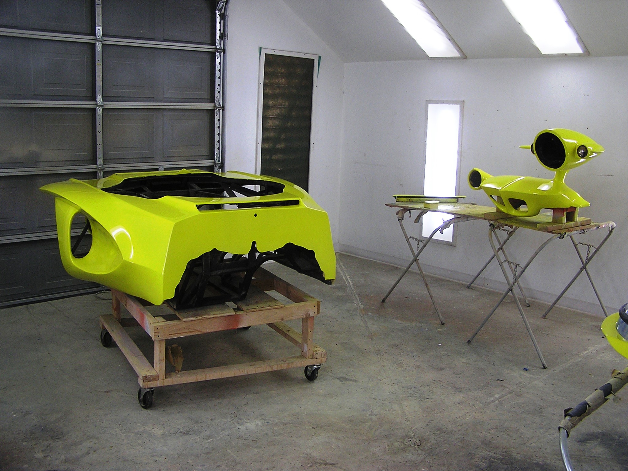

    4) a full feature paint booth. Has inlet dust filters, 40" exhaust fan, ceiling and wall fluorescent lights. My previous rendition had a drain in the floor so it could be washed before painting, after color sanding, etc. Couldn't fit the drain on current property. 6HP 2-stage air compressor in corner of this room, in its own isolated room. Air delivered all over shop via 1/2" copper pipe.

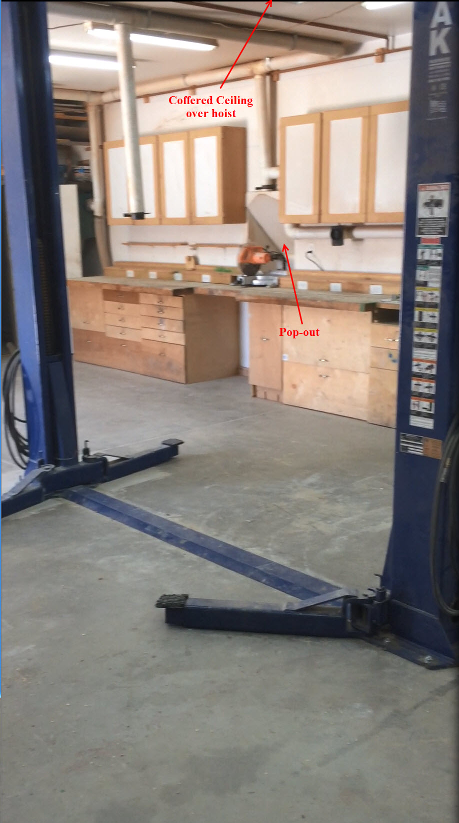

    Here is the previous version floor plan. It had a bathroom and floor drain. Couldn't get water or drain to my current shop so no bath and no floor drain. Only 60' long, not 64'. Left pop out holds exhaust fan right pop out accommodates sliding 10" miter saw. Coffered ceiling accepts cars over hoist.

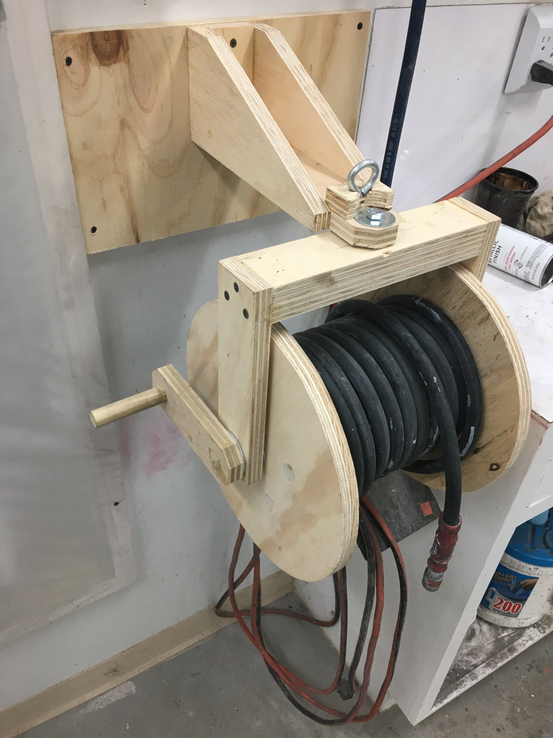

    I built half a dozen of these. Really helpful keeping hoses organized.

    Paint boot in action!
