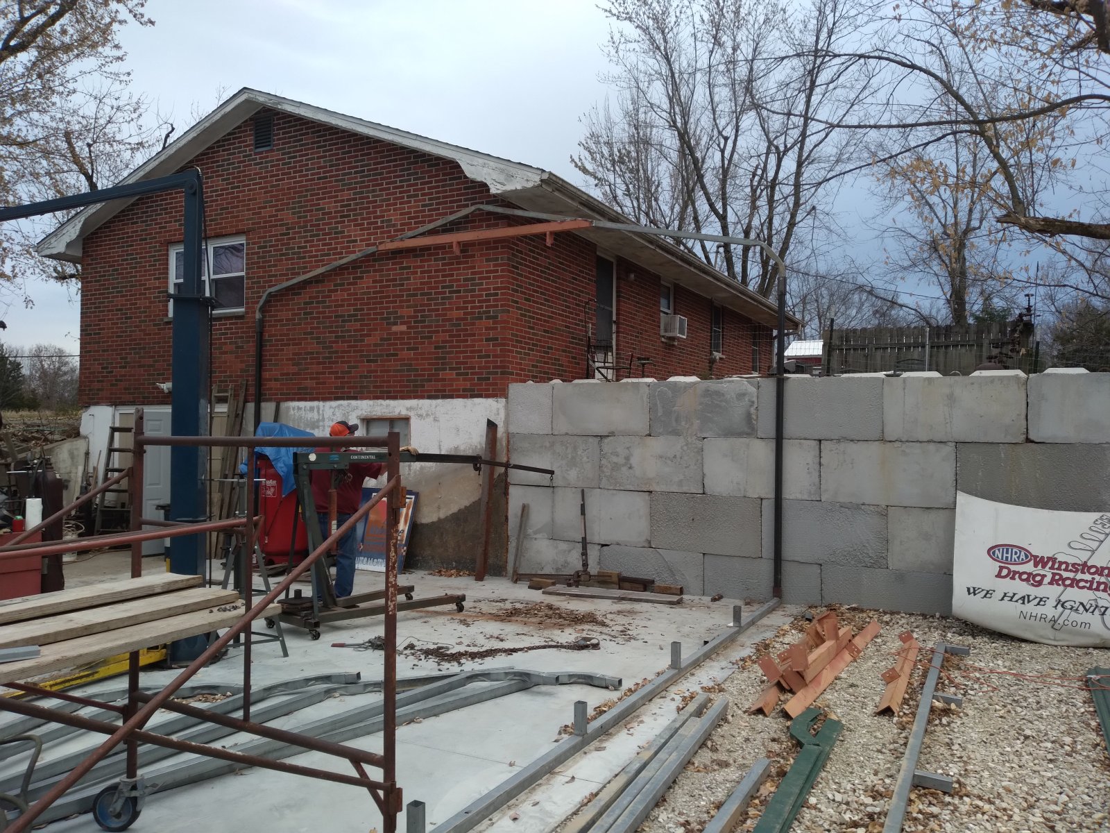

    You can attach "lean -tos" to the central building but at a lower height. Saves the cost of one wall and the lower ceiling is all that is needed because you don't need another lift. Heating it is cheaper because there is not as much to heat and the heat stays lower. I have a workbench and a bunch of cabinets that I aquired at auctions and off Facebook in the leanto..........and provided 2 overhead doors so whole vehicles could come inside if needed. (Depends on the span of the leanto) I filled mine with a workbench and other tools so no more vehicles with my 13 ft span. The point here is that you can take a lot of the tools you may use in your main shop and put them on wheels. Store them in the leanto and roll them out when needed. In my case, I also have a couple of permanent tools in the leanto....a 4ft shear and a 4 ft sheetmetal brake. But I have several other large tools that I can simply roll into the main shop when needed. Insulate well.

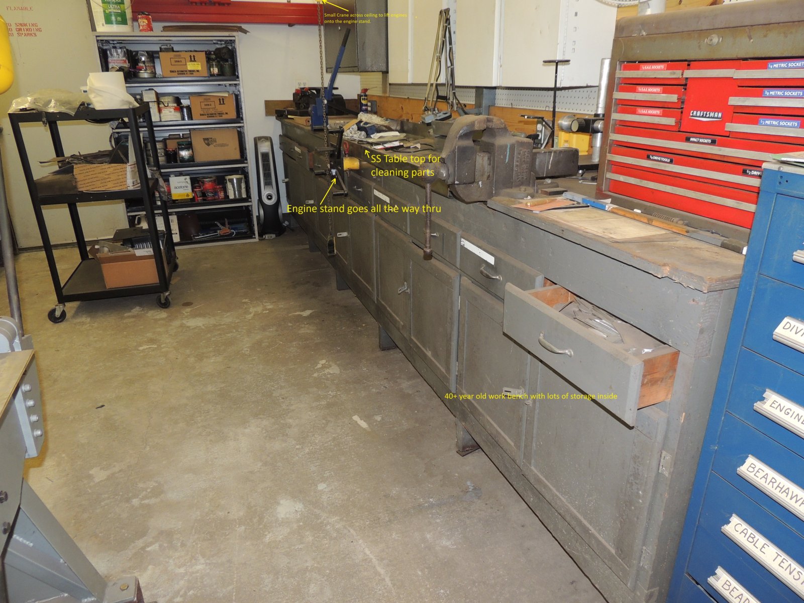

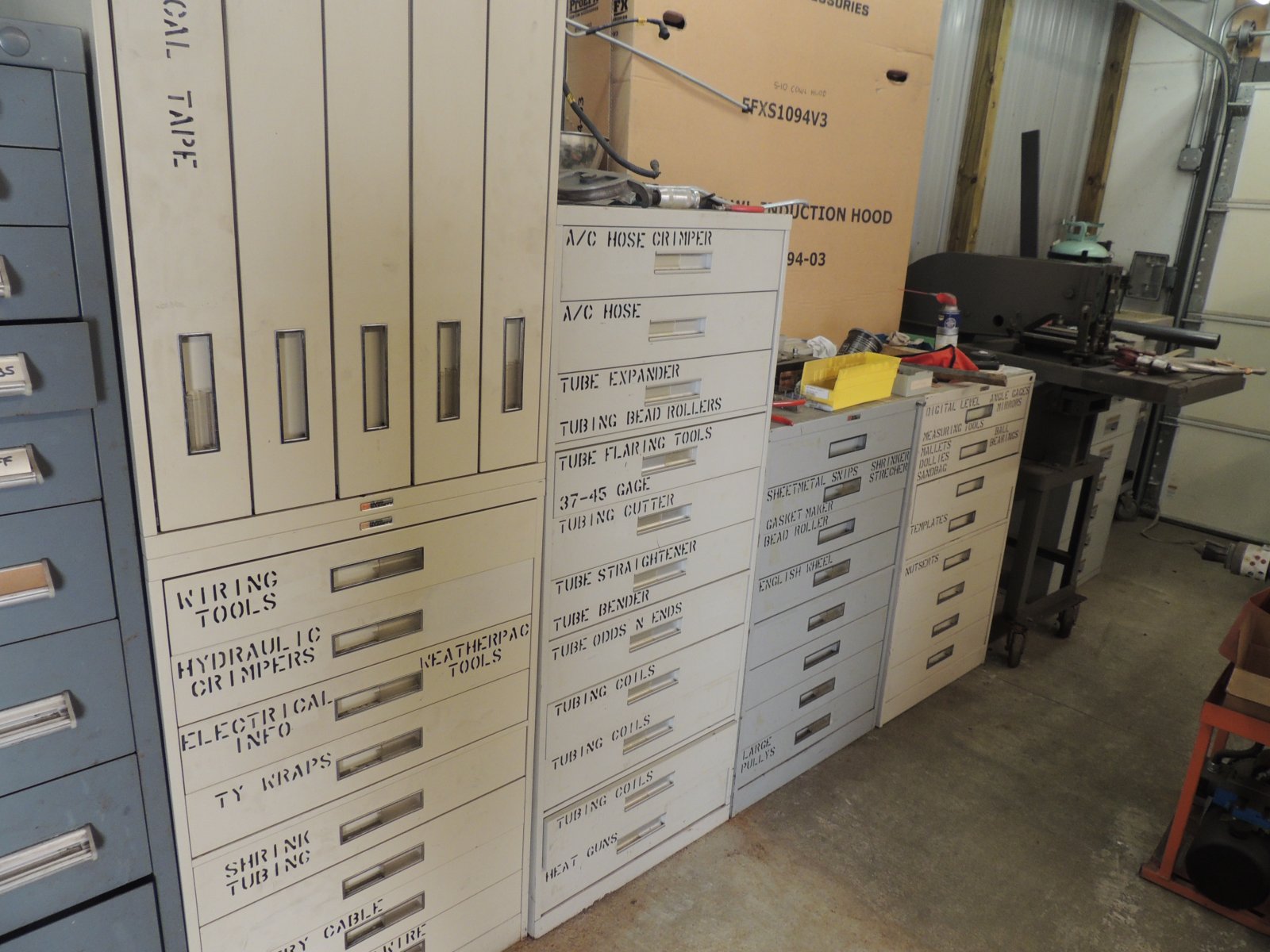

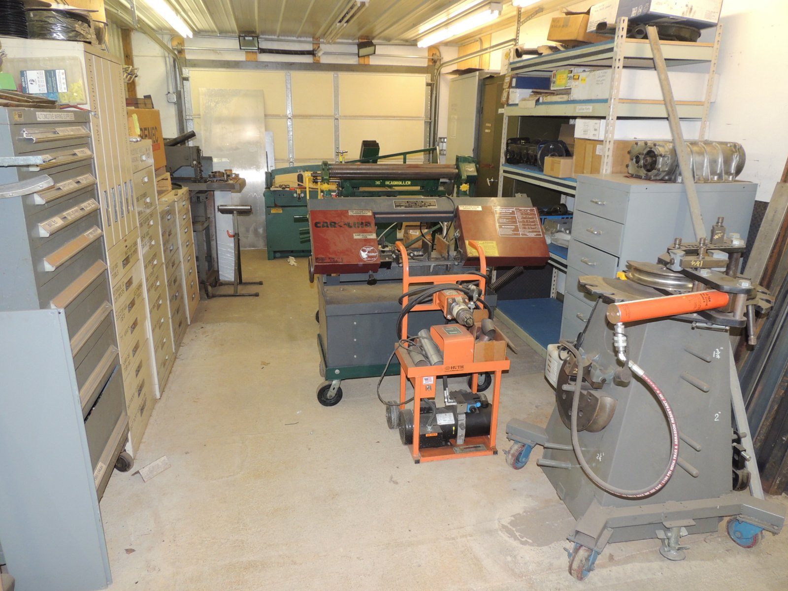

    Left side of leanto
    Leanto 3+.JPG Right end of leanto

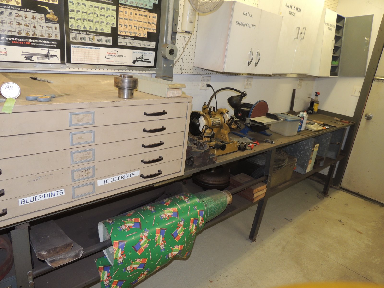

    Additional detail of right end of leanto
    Additional detail of left end of leanto.

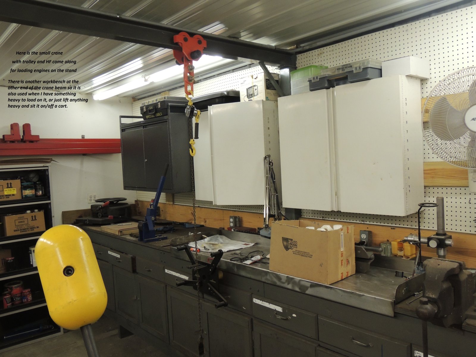

    The idea here is that I can store stuff so its not always in my way in the main shop and I don't need a high ceiling. I can also work in here on things like engines and transmissions because I have a workbench that has a SS tray on top to catch oil and debris and an incorporated engine stand in the workbench....eliminating the floor space of a full engine stand.
    As you can see, all of this stuff doesn't need to be in the way in the main shop, and makes great storage and even additional workspace for certain things. I'm a big believer in incorporating cranes into ones shop...both small and larger ones. Its hard to believe just how handy they are....especially as you get older.

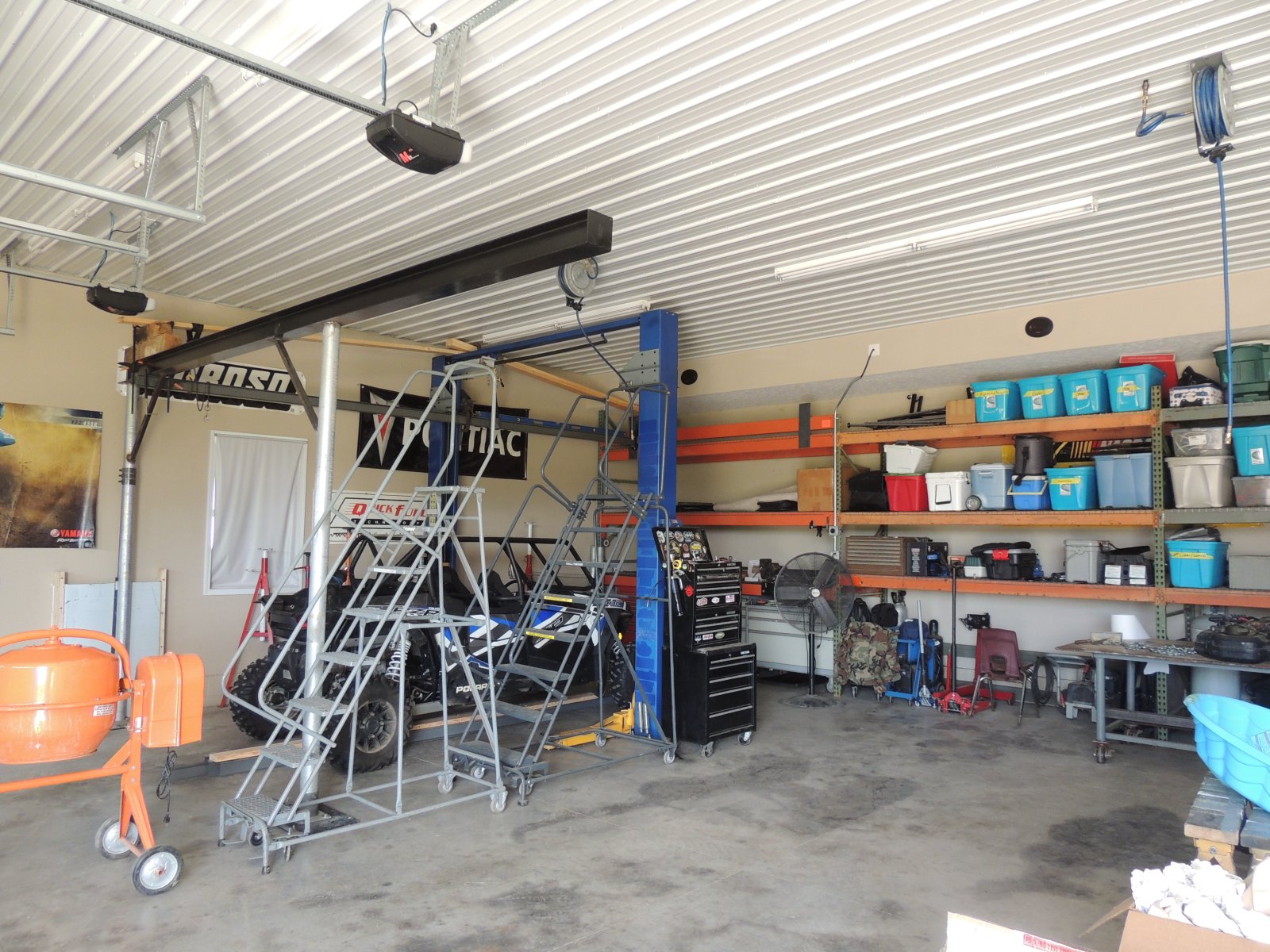

    Here is a crane we built in my son's pole barn using the two post lift and some pallet racking as part of the support. Cut two 4" I beams (NOT H beams) 20' long. to do this. Then two supports and a heavier crossbeam at the front.
    The heavy beam was long enough to make a cantilever in the next bay, so we added a counterbalance by pouring concrete in a form against the wall. Now things can be unloaded in the other bay with no loss of usable space. He put an electric hoist on the cantilever and his wife even uses it.
    Small crane and trolley in my lean to

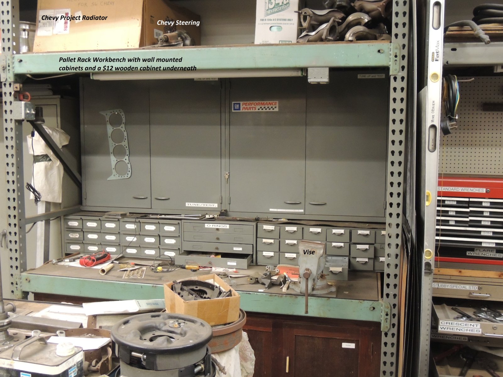

    So, my suggestion is to not only create additional space, but to incorporate pallet racking and cranes to make it work for you.
    You can also incorporate work bench space into pallet rack and have storage as well.
    Hope this gives you some food for thought.

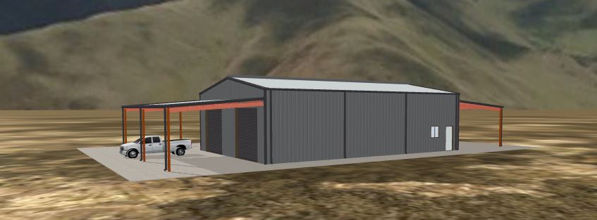

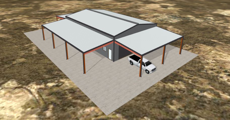

  11. Personally, I want enough space to pull my daily truck and flatbed trailer inside without having to move my other projects and stuff out of the way. I want an area for my fabrication equipment, and enough room for 2 lifts and to park at least 4 project vehicles(not stored on the lifts). I also want a 20' deep mezzanine area for storage on 1 end, and a bathroom.
    I've been working with a contractor on the plans for a 40'x60'x16' shop with a 20' lean-to on 3 sides, so a 60x100 concrete pad. One walk-through door on each end, and two 12x12 garage doors on each end so I can drive straight through. I may only do 1 garage door on each end, either way it's pricey, but I want to buy once & cry once.

    That contractor has gone the extra mile with that shop rendering. SW of Austin is a nice area. I would not mind having open sided storage if the weather was more vehicle friendly. I just want enough space to get everything under roof. I hate seeing cars with potential out rotting in the weather (mine included). I may not be able to save every great find, but I can start with the ones I have and then p*** the ones that aren't keepers along to someone that will take care of them. Some of the non-cl***ics might be fixed up and gifted to someone in need. We can share our skills and blessings with those who might just need a little help.

  17. The rendering is from Mueller's 3D builder on their website, it's just a visual for the pre-planning stages, and I'm likely using a different manufacturer due to cost and availability. I'm the licensed contractor so I'll be doing the foundation myself, and have the shell erected by the contractor. Then I'll finish it out with electrical, plumbing, insulation, the bathroom, and mezzanine on my own as well.
    The covered lean-to's are an expensive add on, but in the Texas heat, they are non-negotiable, and I can always wall up the one side if I felt it was needed, but I'm planning to park an RV trailer there to live in while I build the cabin on the property.

    Those lean-tos are excellent for a dirty to clean workflow, too.
    Pressure washer at one end, next a blasting area, then a solvent tank and hot tank.
    Hose the project down, dis***emble and clean chunks and then have it ready for inside modifying, storage and fitting before paint.

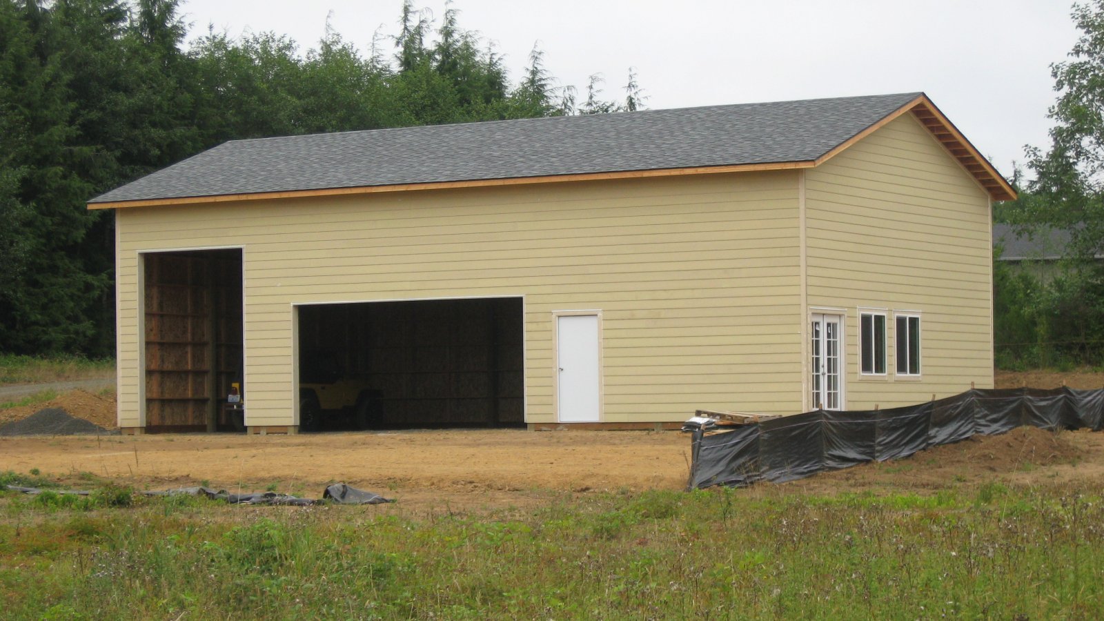

    Is that a Pole Barn Constrution? Looks like it is... Nice size
    Looks like your on the Bay

    Yes, it is.
    It is on the Bay (Grays Harbor).
