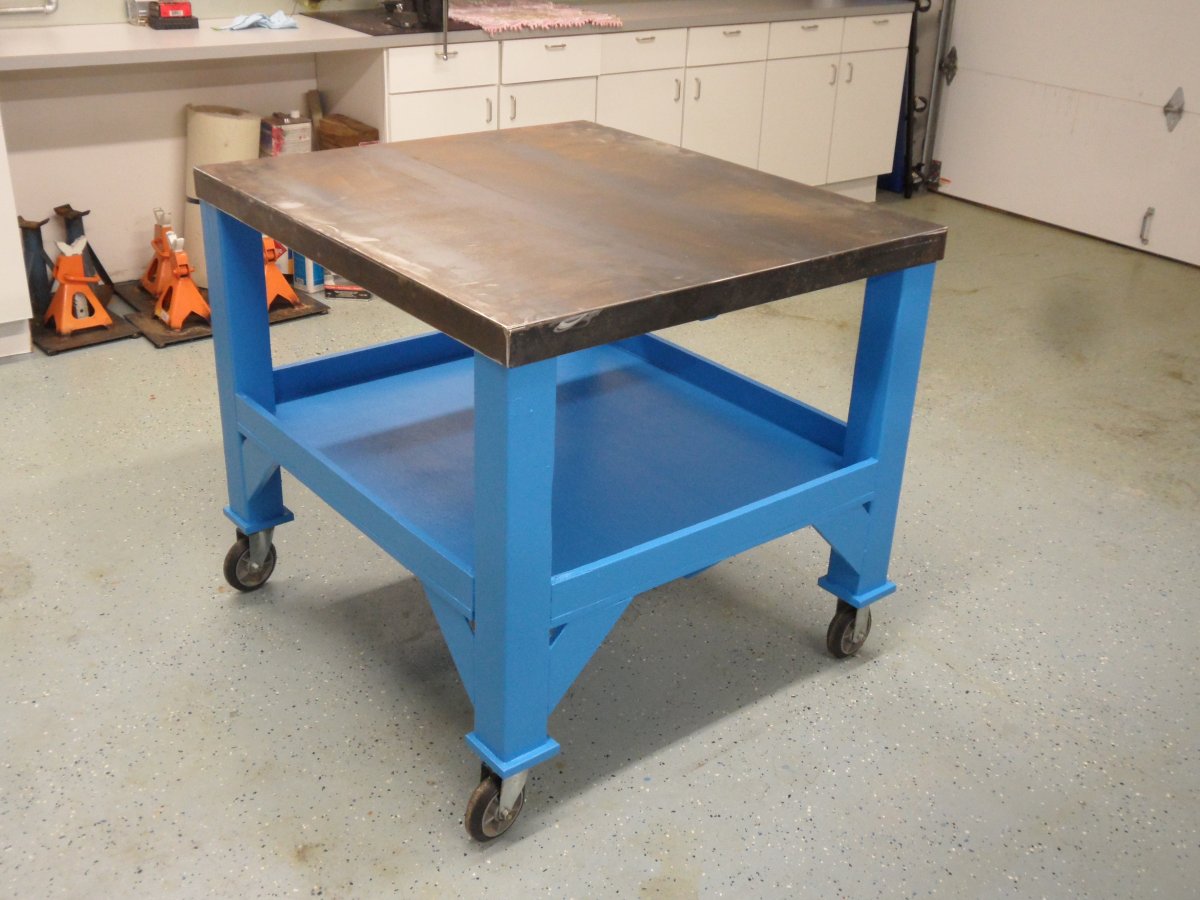

    TableProject 005.JPG TableProject 008.JPG TableProject 015.JPG I need a steel topped work/welding table that I can move around and outside for welding on my 40 build project. Knocked the table out in a couple days but 2 coats primer and 2 coats color, another four days. Our business fab shop has a 10' shear so I had them shear up some 10GA plate for the top and sides per my cad drawing and below is the finished product.

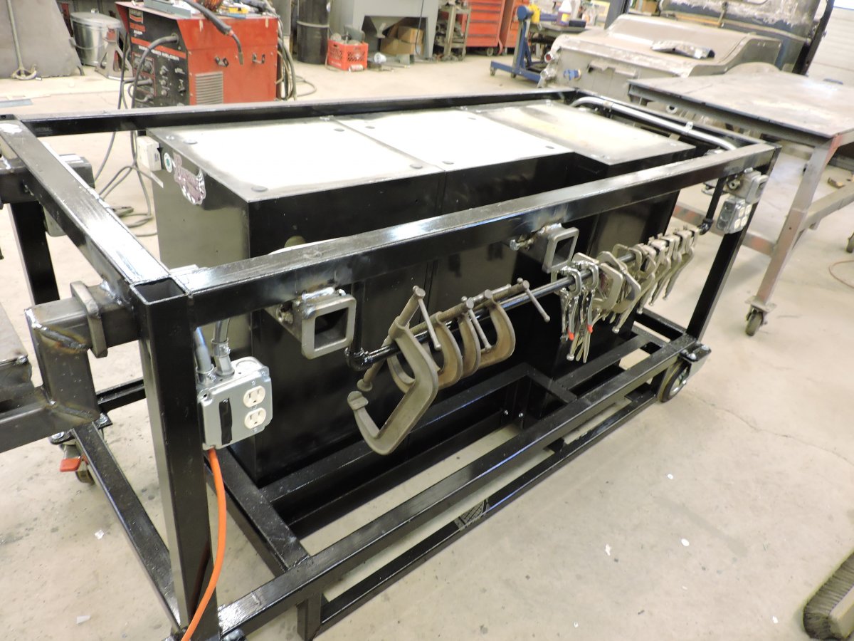

    This is the shop bench I just built a couple of weeks ago

  4. D.R#1, Nice looking cabinet work. I'll go out on a limb here and say the day will come when you will wish you had built it out of Steel Tube and larger casters instead of Lumber.

    Thanks Wizzard, I appreciate the comment. I had a little time, no weldor and wood available so it was a make do deal. This one will be a multiple use table, my frame table will be all steel but I needed this one to build the frame table.

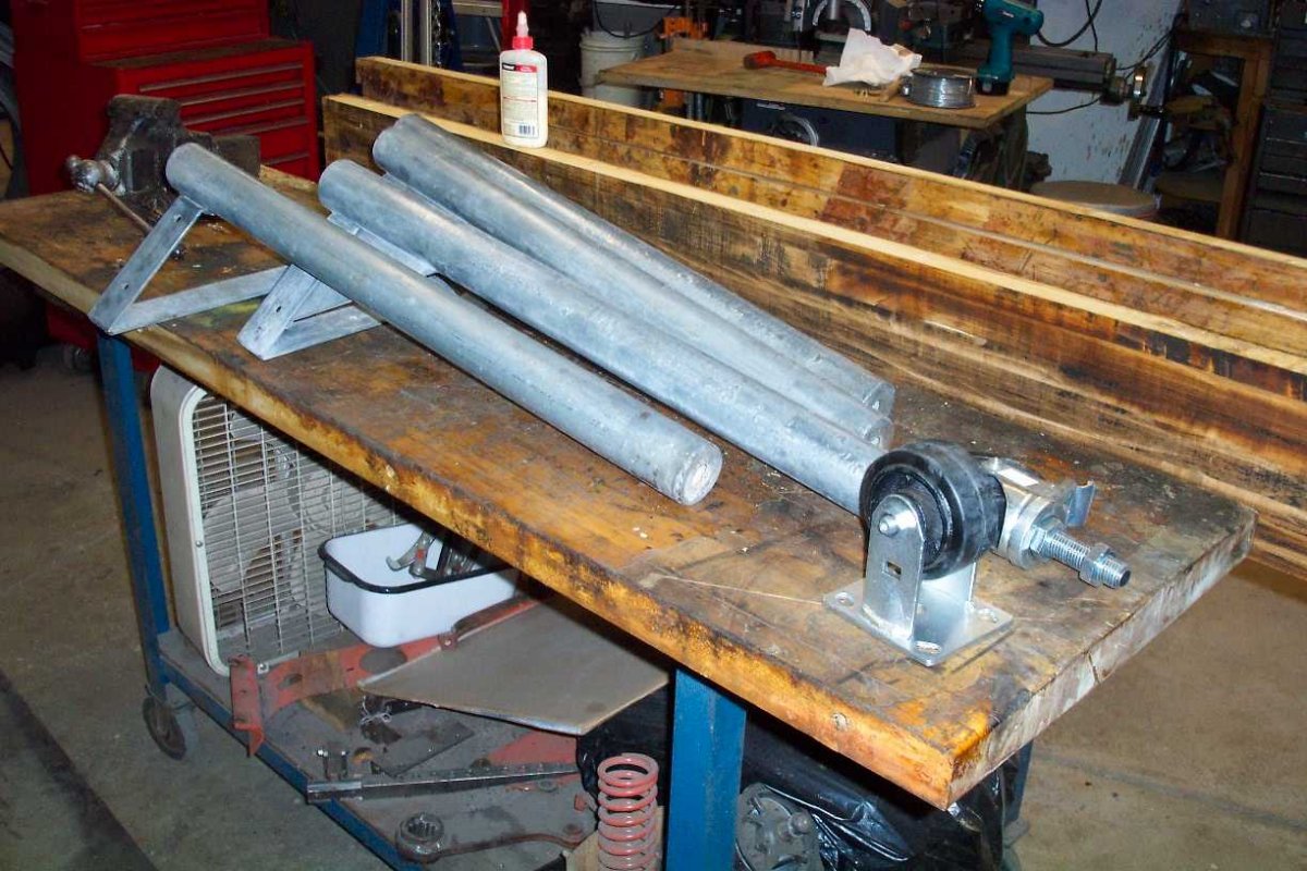

  10. gatz
    Joined: Jun 2, 2011
    Posts: 2,316
    gatz

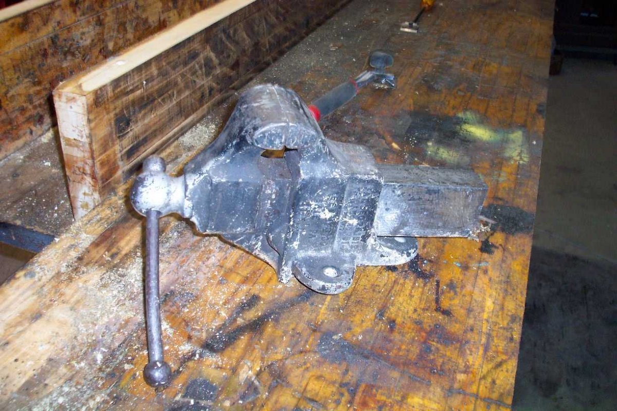

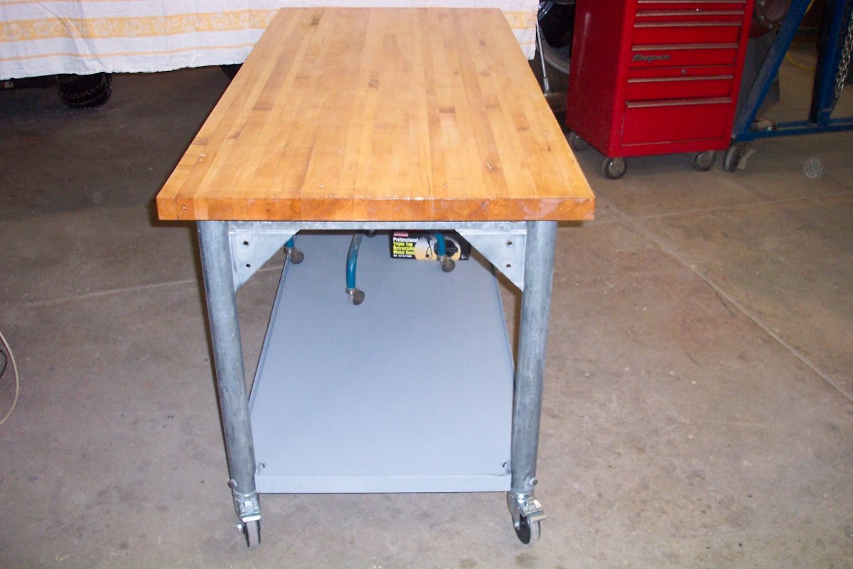

    some years ago I answered a CL ad for a "table". It was sitting upside down on top of another light-weight table. The woman's son and I struggled to get it down on the garage floor and upright, but as it turned out, glad I did. She threw in the Reed vise with it for $45
    At first I thought the legs were just some cheapo steel tubing and would take hours to clean up, and then re-paint.
    After I got it home and started taking things apart, it became obvious that it was a darn good industrial table like from an ins***ution, and the legs were actually heavy wall galvanized tubing.
    Took quite a while to clean things up.
    Especially that decoupage **** that was once fashionable. (never understood the thinking there).
    After making new tension rods and re-gluing the maple top together, I took it to a lumber co and had it sanded down. Turned out nice.
    Welded up a lower shelf. Added casters. Now have a descent flat table to work on.
    juan motime and DesertRat#1 like this.

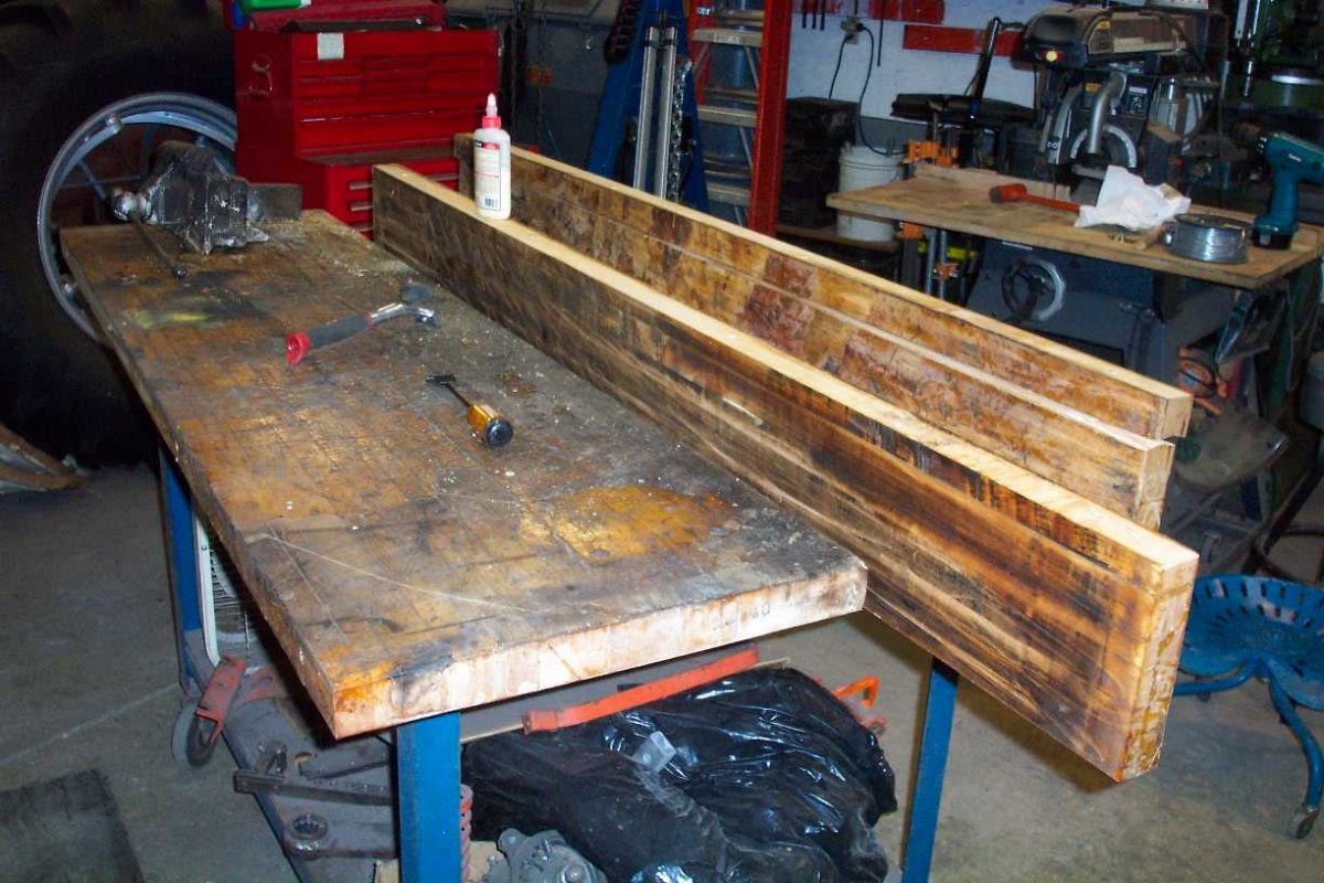

    The teller cabinets were from a remodel at the local bank, the casters were a swap meet buy and the top is a 3 1/2 x 5 ft piece of 1/2 in steel that was the top of a sad welding bench bought from a going out of business welding shop. The only new things I had to buy was the steel for the frame and the receivers for mounting things on the ends of the bench like a saw table. Here is a pic of the sad bench that I got the top off of, good thing was the $50 price tag.
