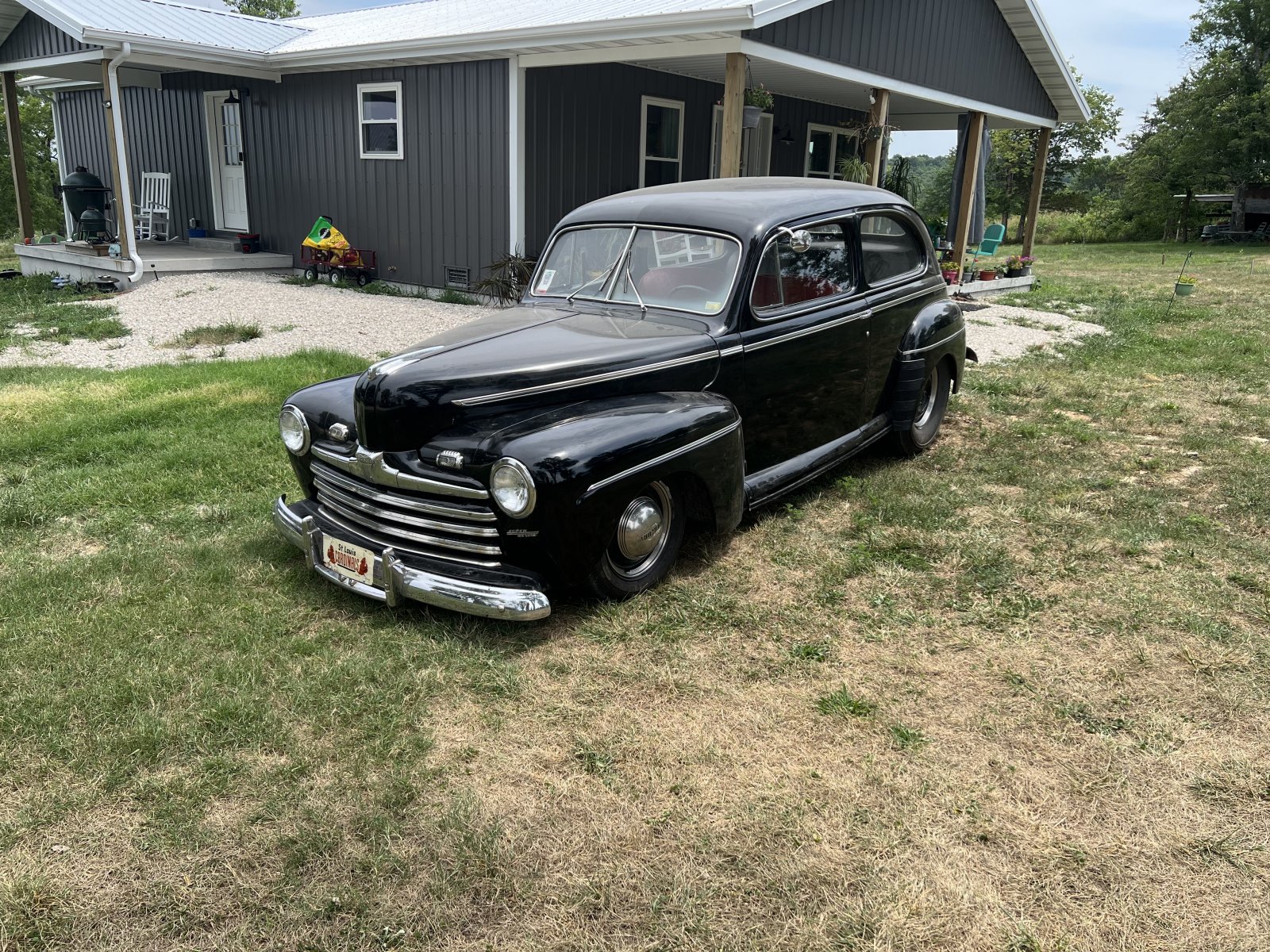

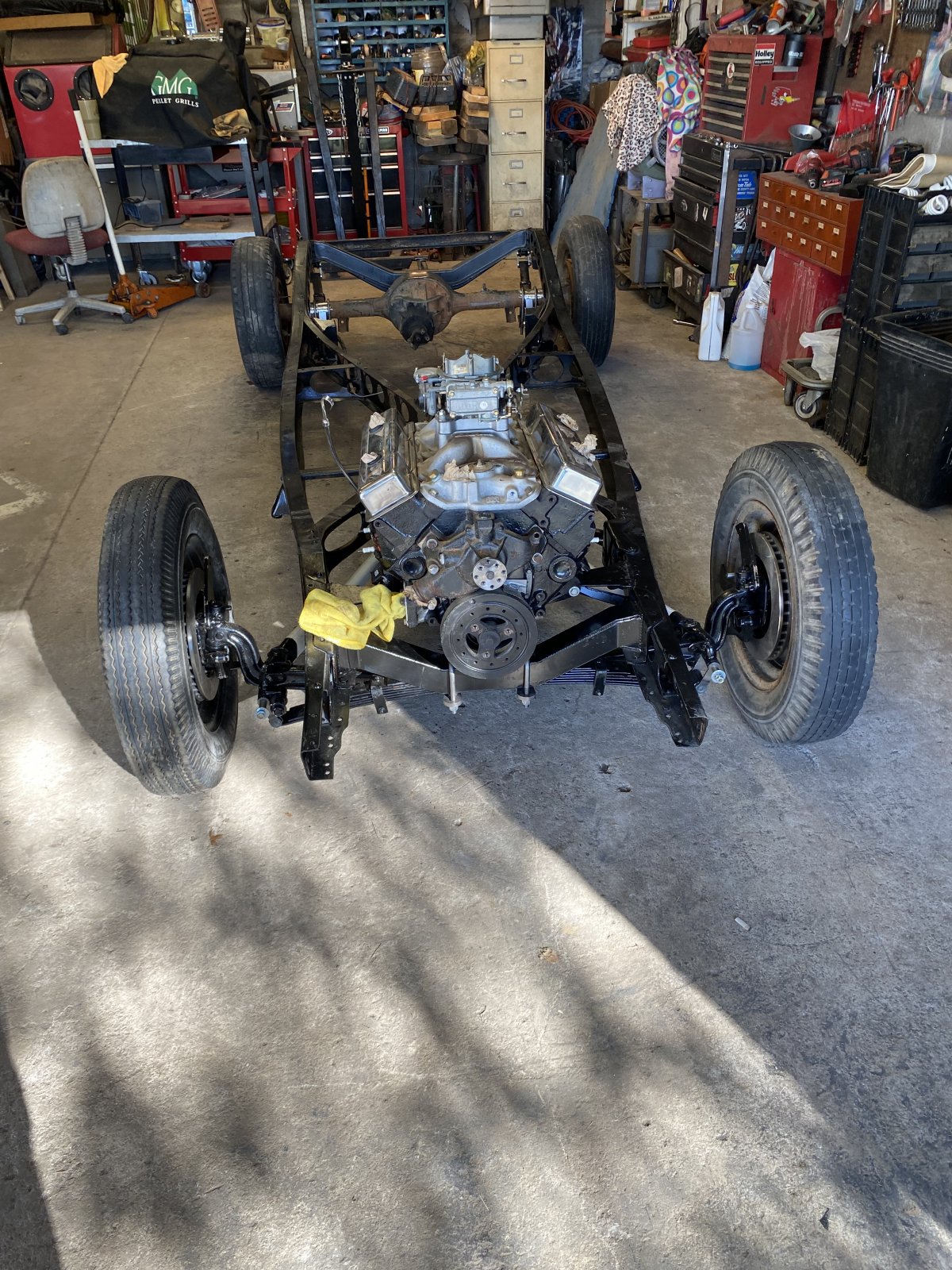

  25. EV34
    Joined: Aug 29, 2008
    Posts: 1,207
    EV34
    @Dan Coburn the 9 I’m in my 46 is offset. And I’m very low and have no issues with the floor pan and factory tunnel. I’d ***ume you would be ok as well. Here’s some photos
    here you can see the offset between the rear and the transmission. I thought I had a shot of it with the driveshaft in but I don’t. But you can see how it is from this photo.
    here It sits after the ford test drive. No issues at all. And this is also with a short tail shaft by the way.
    Dan Coburn likes this.
