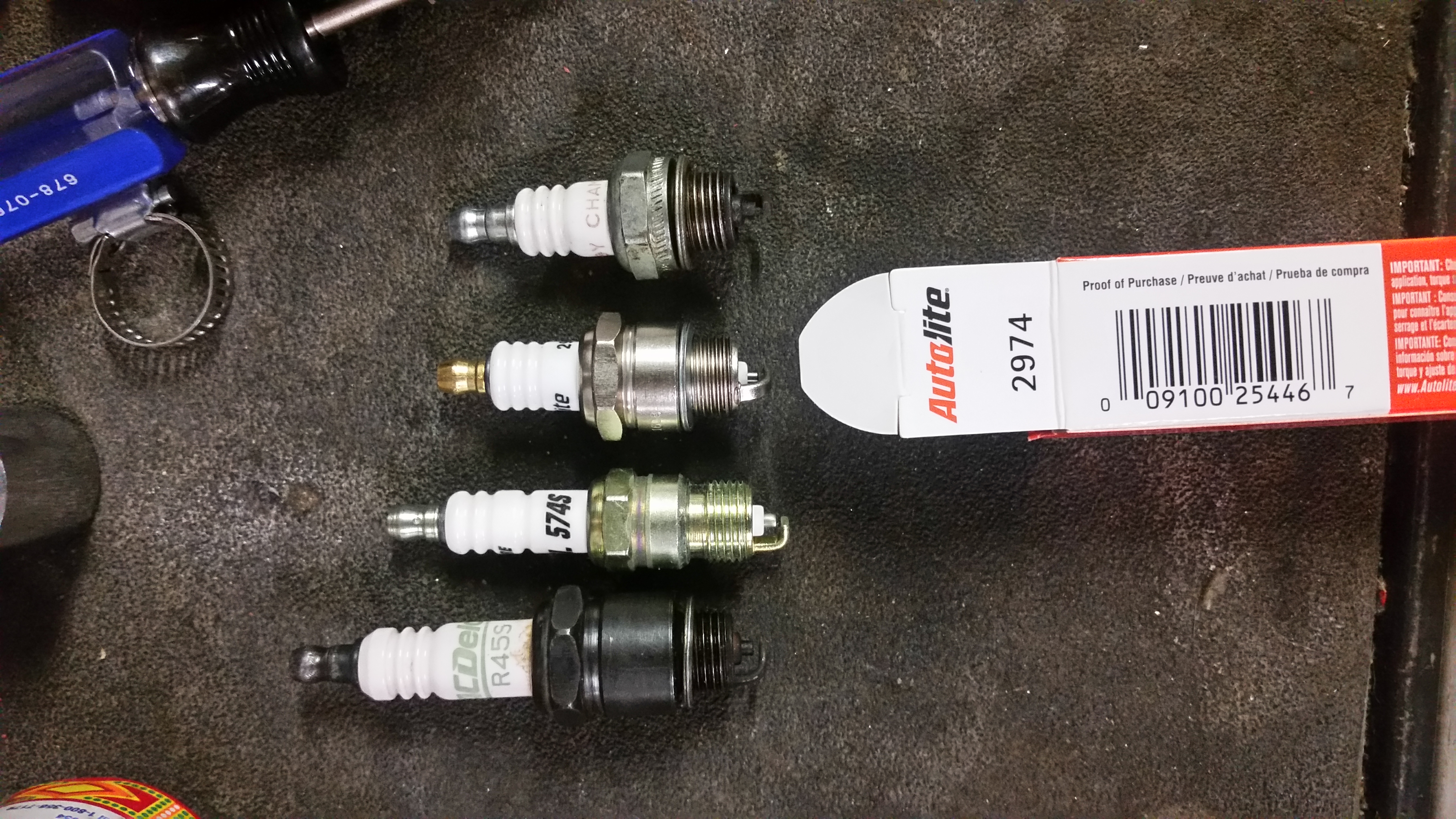

  7. Gota love the HAMB!
    Just ran into this problem on mine, but the shorty accels wouldn't help enough.
    From left to right
    AC r45s
    Accel 574s 1/2" shorter (I know tapered seat, the amazon discription was wrong)
    Autolite 2974 1" shorter, with just enough shoulder under the hex to reach out of the counterbore in the head
    And a random champion out of my weed wacker
    Max Gearhead likes this.
  8. [​IMG]
    And there's the money shot, shortest on the left
    Full Kustom, drunk mobile posting
