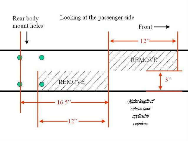

    124.5 minus 115 = 9.5 that you have to cut out of the frame. The correct length bed will fit that wheelbase.
    This was posted on the truck forum that I spend a lot of time on a few years ago.
    DO NOT pay attention to the numbers as the 12 inch cut would now be a 9-1/4 inch cut. do pay attention to how the gent who drew up the design said to shorten the frame with an overlap rather than just cutting and **** welding the frame.

    Just to confirm, this is a 46 pickup. The thumbnail in my original post shows 3600 wheelbase at 125 1/4” and a 3100 at an even 115” (10 1/4” difference) You have more experience than I do I’m sure, just want to make sure numbers are right for this series of truck. Appreciate your response/advice..
