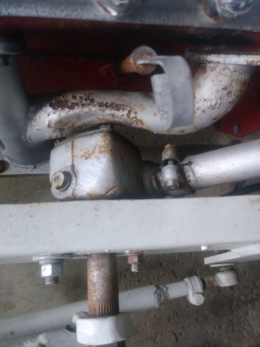

    Is there a correct way to shorten the steering column? I have a 30 model A pickup with what I believe is an F1 steering box, and the column is way too long. While sitting in it, the steering wheel (that is way too small for manual steering) will rest against my chest. The truck was built in 57' and I cannot fathom anyone ever driving it like this. Any advice would be greatly appreciated.

    Does the steering wheel end of your shaft have splines or a keyway?

    If I were thinking about shortening it I would pull the cover off the shaft and take a good look at it. It is a hollow tube which your horn wire runs down through. If you wanted to run a horn like the original, down through the center, then you would need to cut the shaft, **** the ends of the two halfs, and sleeve the shaft either inside or outside at the cut. This would allow you to keep the original steering wheel mount. If inside it will need a hole for the horn wire. If outside the shaft it will need to be thin enough to fit inside the mast cover. Either way should work fine as long as your welding skills are up to the task and if they aren't get someone qualified to do the welding. This is one place you don't want a failure! OH, then cut the cover accordingly!

    when i do it, i take it apart, press the worm off, and shorten the bottom. no welding. a ford light/horn rod can be cut shorter and tig welded with a piece of brake line in the joint for a backer

    Your box is an F1 and has a hollow shaft. Unless the shaft was swapped out with an earlier one, it has splines.
    When shortening columns, I like to remove the shaft from the box. It is much easier to handle and you should check your gears and bearing races for wear before investing time it.
    I like to cut the shaft in the middle of the length. After removing the required amount, I put a heavy bevel on both ends to allow a deep root weld. I use plenty of heat when welding to ensure full penetration. To keep it kinda straight during welding, I place the shaft sections into the "V" of a piece of angle iron and clamp them in. Weld what you can and then remove it from the angle iron. Grind the weld flush. Reinstall in angle iron and weld the remainder. Fill any low spots with weld and grind it all flush.
    You now need to find and install a sleeve. Use as thick of sleeve as you can find, but be sure the OD of the sleeve is still small enough that the bearing and race can still fit over it. A sleeve 1" to 2" long should be fine.
    Slide the sleeve over the weld joint. Weld the sleeve 360 degrees on both ends. Grind these welds down too.
    You will now need to straighten the shaft. Put it back in the box with the bearings/ races and turn it to see which way it is bent. You are really just trying to get the wheel end to run true....so a little bow in the shaft is ok as long as the end is centered. Since the weld area is where the bend is going to be, that is where you should do the straightening. I set the shaft over 2 heavy steel blocks I have about 18" apart then carefully use a sledge hammer to lightly tap (at the weld joint) to straighten it out. Take your time and dont get heavy handed.
    Once the shaft is straight, cut the bottom of the outer tube to the correct length.
