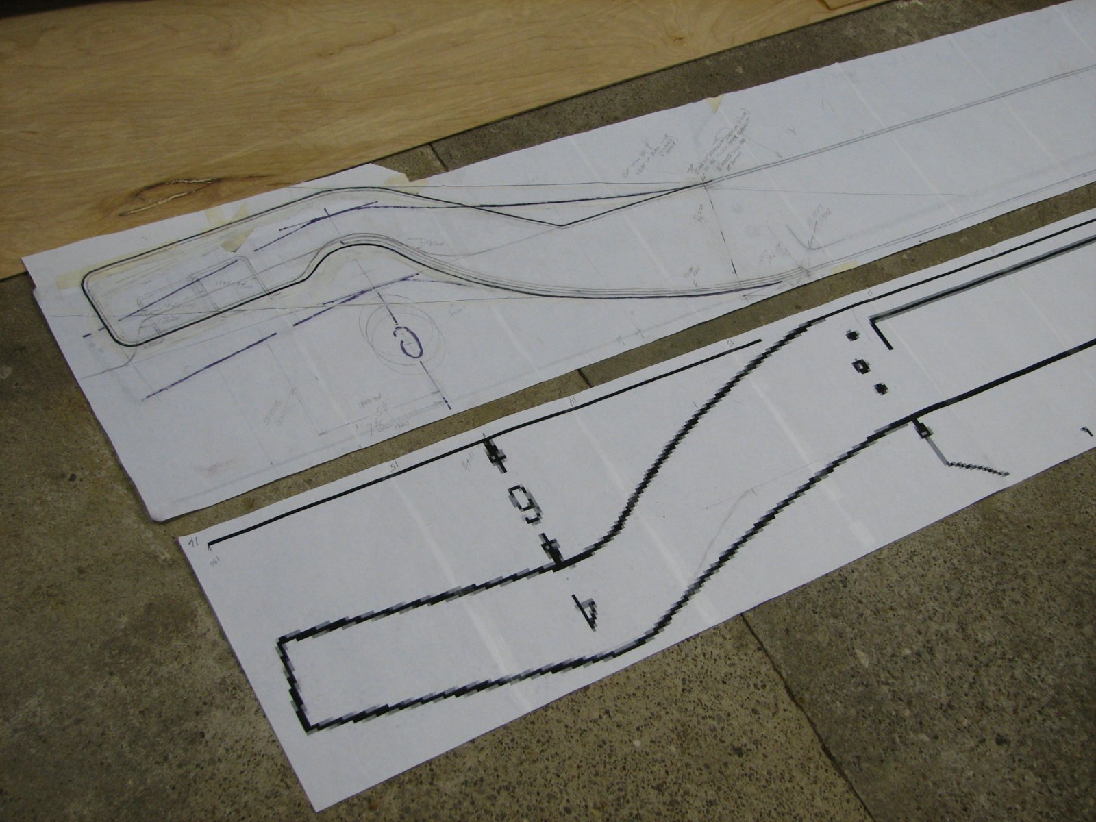

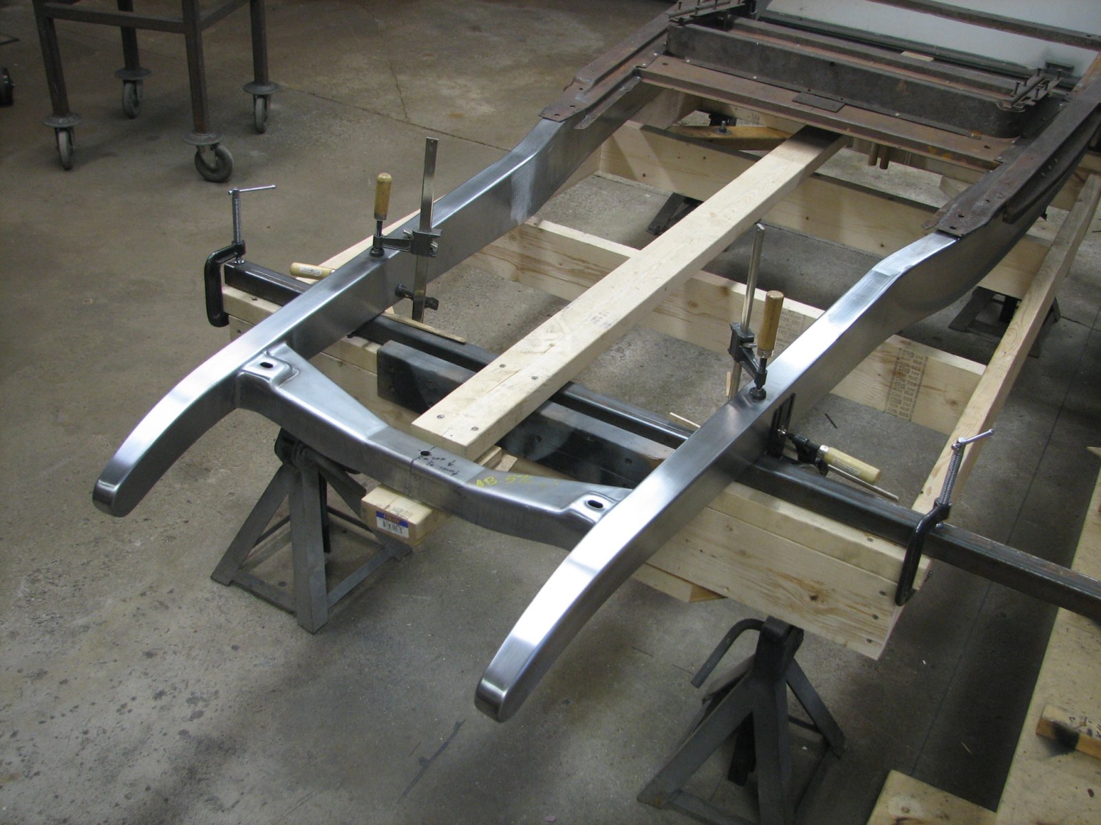

    I'm the guy that built that grey coupe and yes it has a 103.5 wheelbase. I did print full size rails but modified them to fit my needs.

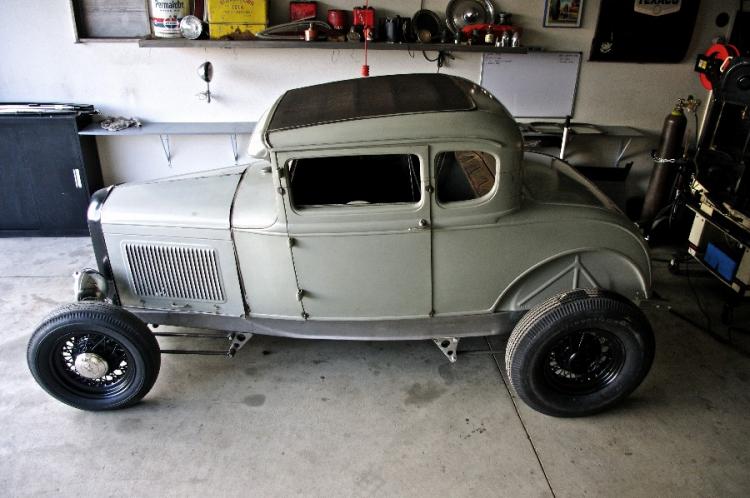

    Here's a few pics for you. It's not that unusual. Generally speaking if you see a Model A on 32 rails with a stock hood, the wheelbase is stock, there's no other way to do it. If it has a 32 hood the wheel base is most likely 1 9/16 longer than stock model A (that's the difference in model A and 32 hood length).
    The look is a low model a with a hood that's short and stout like Henry built them.
    To some of us that extra long hood looks out of place on a model A. You may not be able to notice it but to some it sticks out like a sore thumb. A couple of these pics are of my car. 356643-1326525577-20938d175fbb04acfe54501ea786d459.jpg 426758-1353300333-ad4f9e6c0f76e14ff5484d3e89509fa3.jpg before tear down with tires_013.JPG DSC_8056.jpg grey coupe5a.JPG IMG_4647.jpg IMG_4658.jpg smallIMG_6577-4.jpg uploadfromtaptalk1356040715970.jpg uploadfromtaptalk1356040818493.jpg

    Here's how it was done. Unfortunately a few guys just posts to change your mind. You've got a good eye. The difference is subtle but powerful.
    I did recess the firewall about 3 1/2 inches only in the area that interfered with the engine. That's why from the side view it's not that noticeable. This recess works good for me. I've done a few like this. Pedals are no problem at all. A small block Chevy wouldn't be much different. I used F1 pedals and bent them to fit my application. It's all connected with original Ford clutch linkage. Hangers would properly work better for you. recess firewall_008.JPG recess firewall_009.JPG recess firewall_010.JPG recess firewall_013.JPG recess firewall_018.JPG recess firewall_019.JPG recess firewall_020.JPG

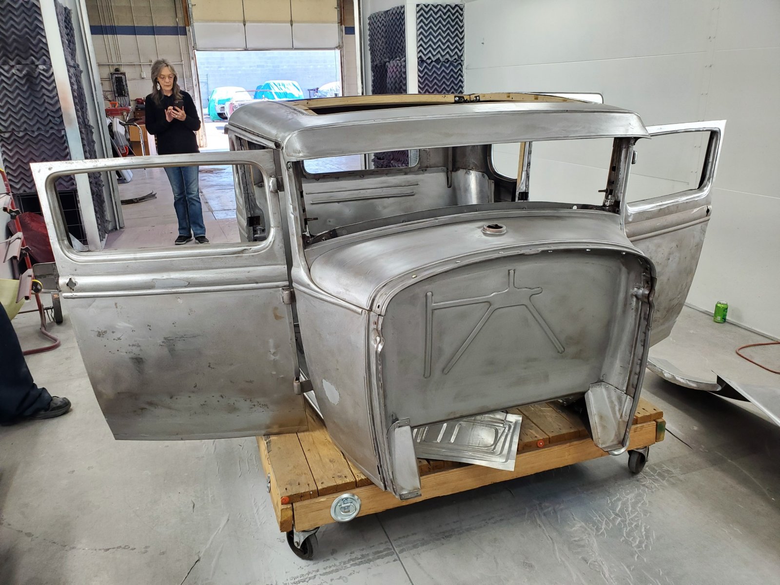

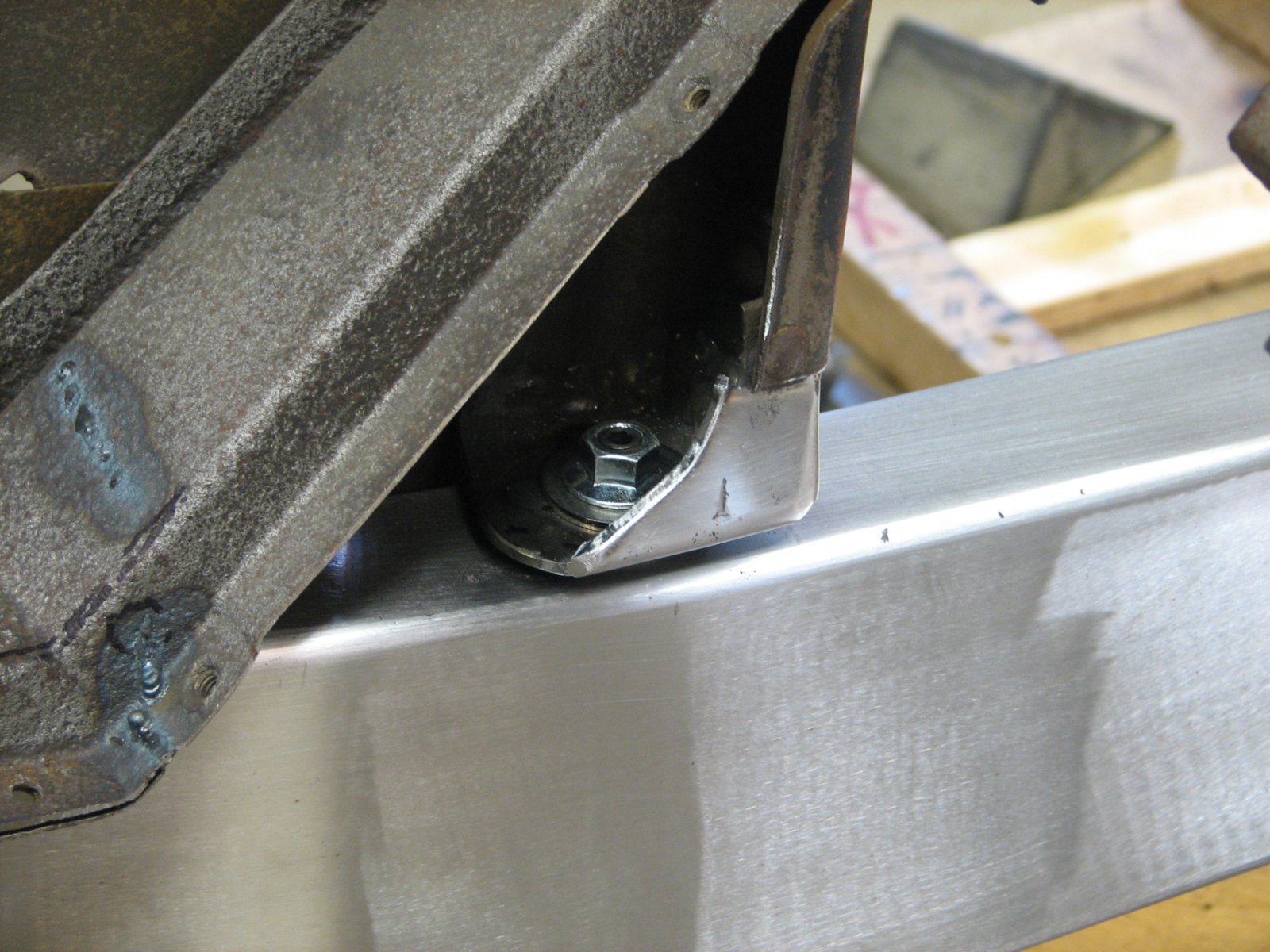

    Thanks. They're slightly kicked up like 32 rails do. That little rise gives a couple inches more drop in front. Model A cowls have little feet that are easily modified to compensate. Here's my way:
    32 ford frame build_436.JPG 32 ford frame build_439.JPG 32 ford frame build_440.JPG 32 ford frame build_441.JPG 32 ford frame build_442.JPG

    Another note for you. The frame was shortened by locating the rear tires dead center in the rear wheel-wells of the body then measuring forward 103 1/2" and locate the front cross member. In essence the front cross member was moved backwards. I then bobbed roughly 3" off the frame horns to be more like a model A.
    I was originally going to use a model A hood but ended up using an original 32 hood which is 1 9/16" longer than Model A. Had I known that when placing the front cross member I probably would have moved it 1 9/16" farther forward. I had to cut some off the 32 hood at the cowl to make it fit.
