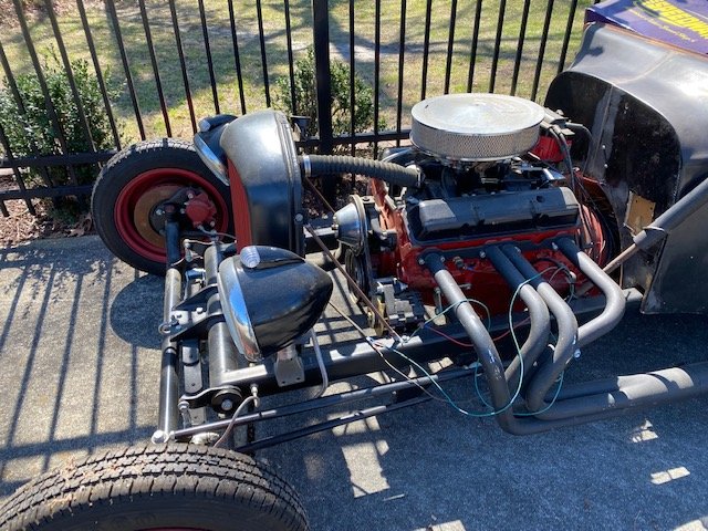

  1. I want to shorten a t bucket frame a few inches between the engine mounts and the front crossmember. What would you say is the best technique?

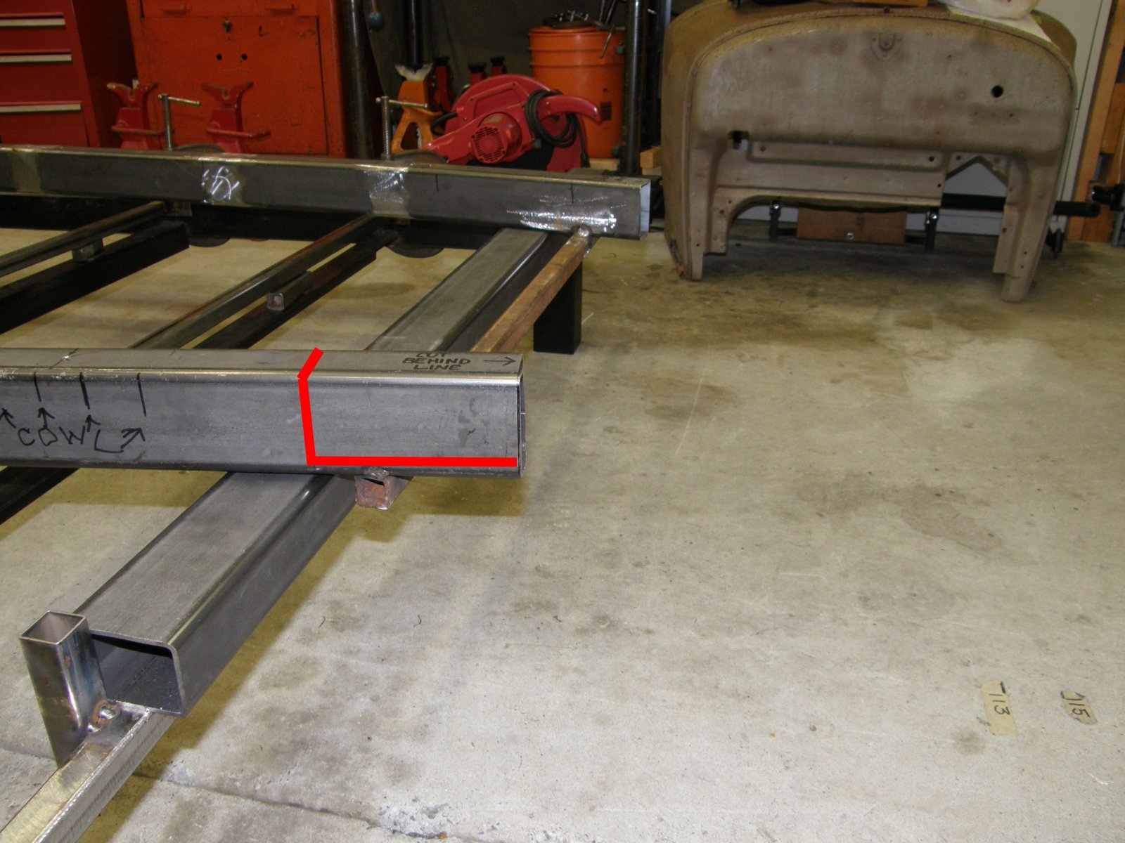

    step cut frame ..remove desired amount with same step cut ..drill(4) 3/8 holes on inside , outside of both sides of original frame to look like dice pattern , and insert tubing inside 4 inches on one end total of 8 inches so 4 will extend into opposite end ..of course line everything up straight and square . level and diagonally true...rosette welds on both sides..finish welding stepped cuts...good to go...you could add plate on inside rail as is wont be visible for good luck..seems like over kill because it is..

  8. You are. The frame is not painted. The frame has nice fit and finish welding. If I cut the crossmember out, I have to do way more work.

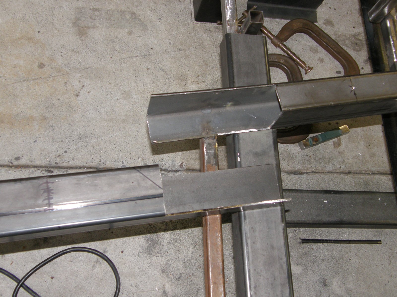

    But measure and cut the section out. If you don’t have a piece to fit inside, use the removed piece. Slice it into a sleeve. Drill some plug weld holes on each end of the frame. Insert the sleeve, plug weld one side of the sleeve, attach the front frame section, measure and square it. Welder up
    lostone and '28phonebooth like this.

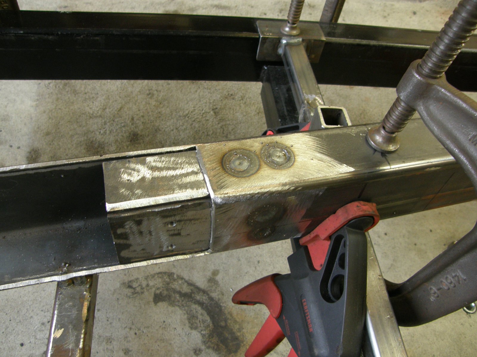

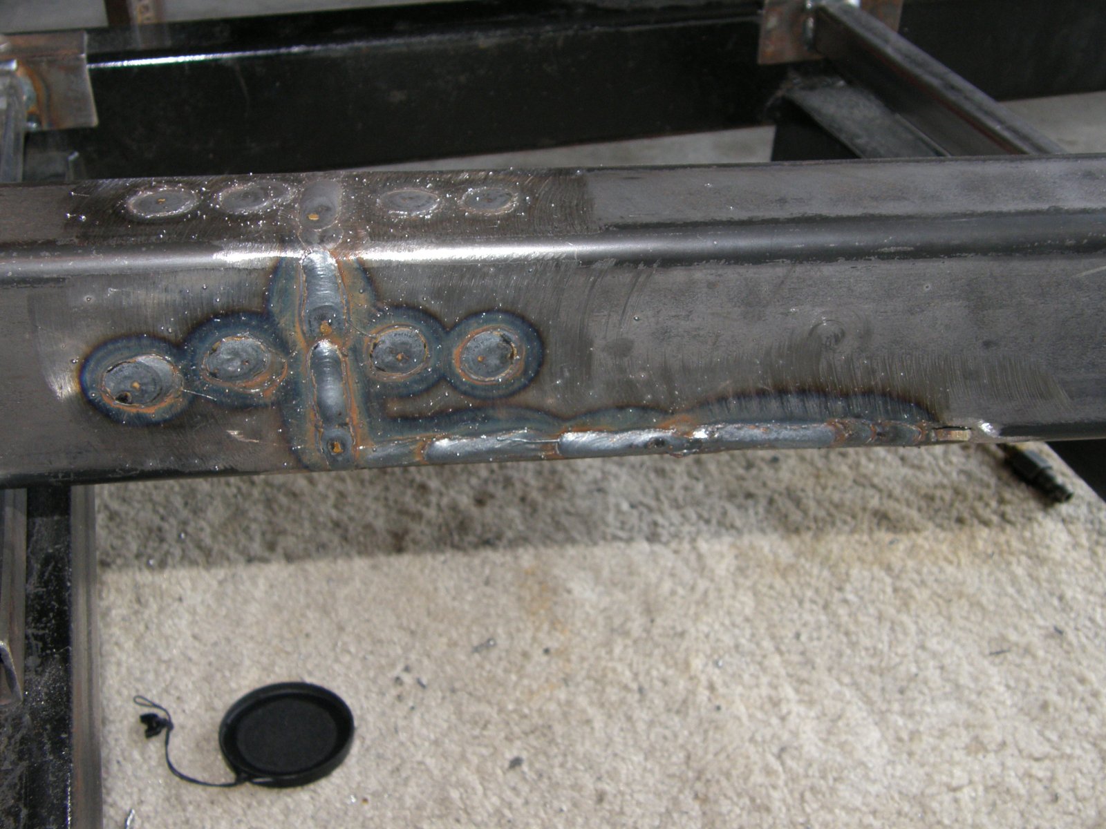

    Back when I was building the roadster, I had to extend the 2"x3" frame. I cut out half of each tube then flipped it over on itself. Rosette welded some 3/16" plate inside the cut sections then finish welded the whole thing. That was a few years and a couple thousand miles ago. Never had an issue.
    ottoman, alchemy, rod1 and 5 others like this.
  29. 1971BB427
    Joined: Mar 6, 2010
    Posts: 9,777
    1971BB427
    from Oregon
    That's exactly how I did a friend's frame when he wanted the length altered. Plug welds, plates, and offset cuts.
