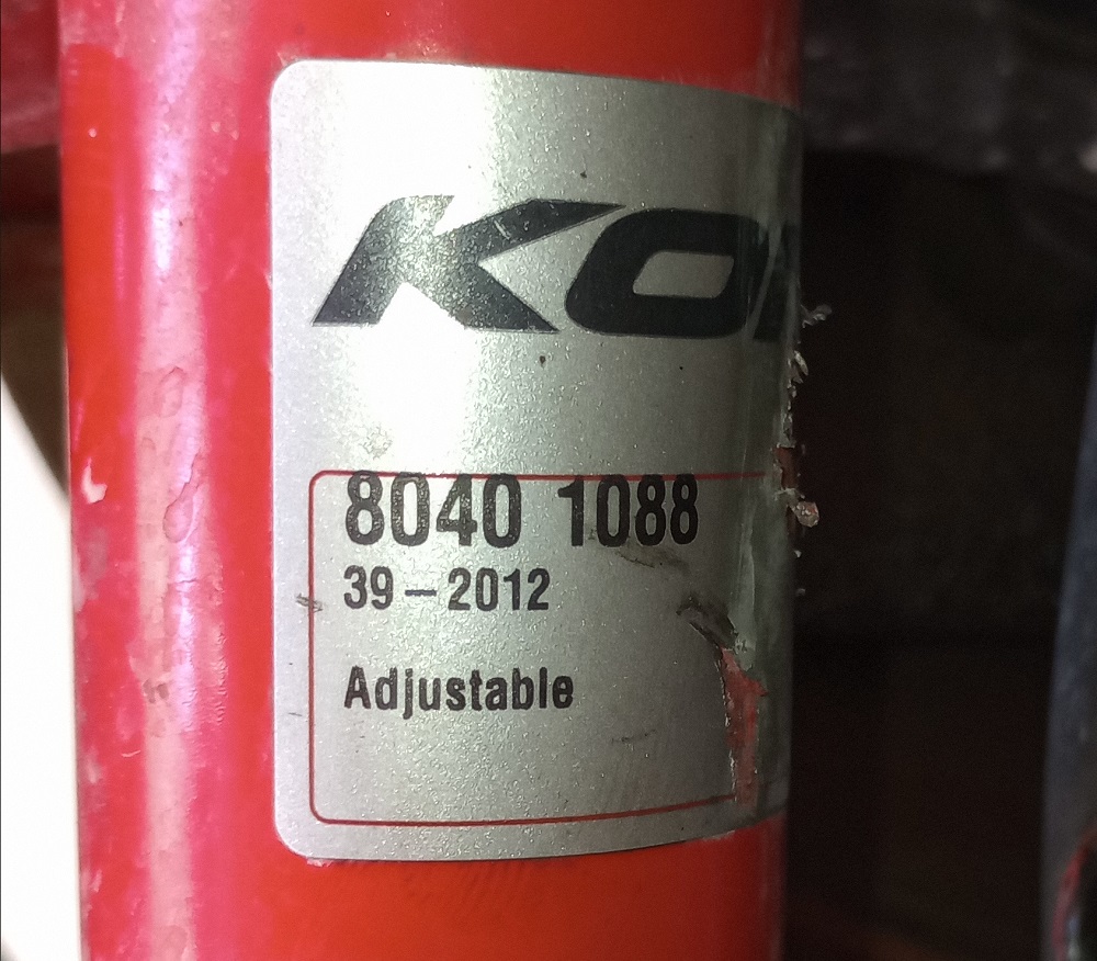

    Further examination shows the same shock as specified by Gimpy. Evidently Koni dun goofed somewhere unless there is something I am missing. I cannot see GM making a different setup for the 8.5 equipped 1971-72 Skylark and Cutl*** versus the rest of the A body. Or the aftermarket 1971 442 FE2 spec spring was made wrong?
    I am not sure if the wagons/Elky's got a different shock either.

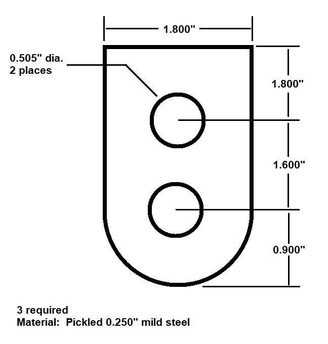

    I drawn up a simple tab to be welded to the mount - it should suffice.

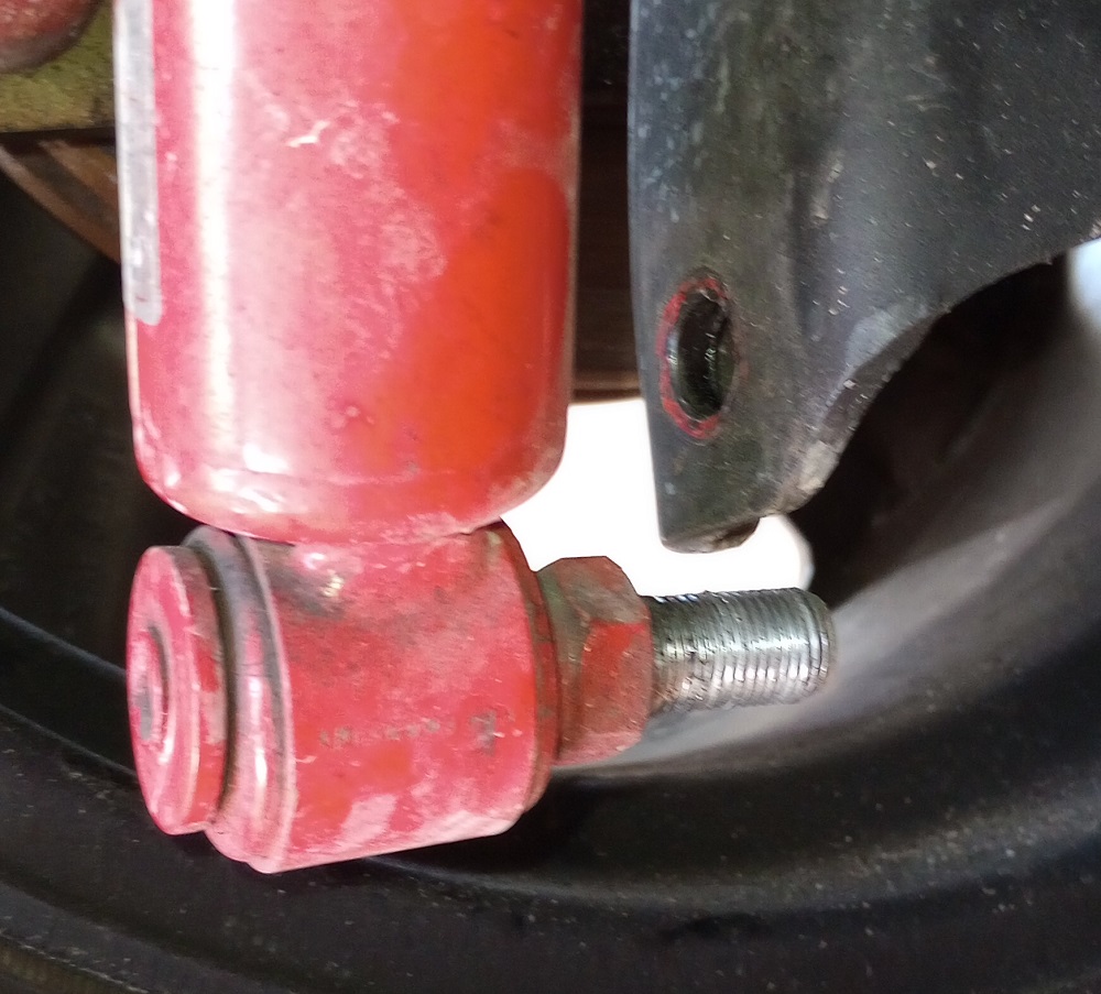

    78-04 Fox ch***is 7.5" rear shocks lower mount is the same as the 64-88A/Gs using that stud bolt to attach the shocks to the rear end.
    With the intro of the 8.8" in '86 Ford rotated the lower shock mount 90° by adding a u bracket that bolted in place of the 7.5" lower shock mount, and added a through bolt.
    These are repops of the 8.8" bracket.
    https://lmr.com/item/LRS-9998915K/Mustang-Rear-Shock-Bracket-Kit-86-93
    Build a similar mount using C channel would allow you to customize shock droop heights.
    Wouldn't require welding to the bottom of the irregular factory mount, or molesting it in any way other than maybe adding an additional bolt hole to prevent rotation of the C channel.
    The hardest part would be removing the stud bolt from the shock, and cutting an appropriately sized crush sleeve for the through bolt.
    IMO, simply adding a tab to the bottom of the existing shock mount would be more work and not as reliable as a bolt on C channel ala 80s Ford 8.8" lower mount.

    I already did measure for 'spring disengagement', it came out to slightly less than 1.5" longer. The new tabs ordered are spaced 1.6" and can be bolted or welded in (will need to drill extra hole for latter).
