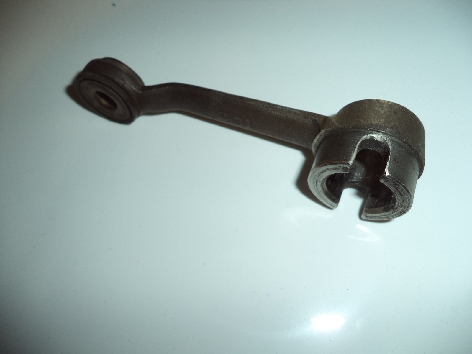

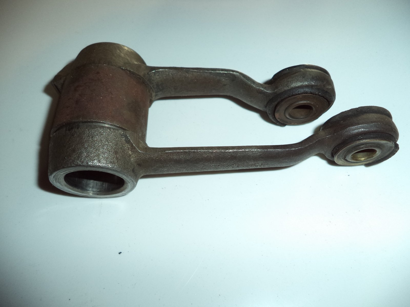

    I shortened a 47 Ford column about a foot to fit a channelled roadster. Mind you, I did it to convert from a three on the tree to an automatic. Had no problems with anything but if you are going to redrill for the pin between the levelers, make sure you drill them straight otherwise you will have binding issues. DSC00431.JPG DSC00433.JPG DSC00434.JPG DSC00435.JPG
