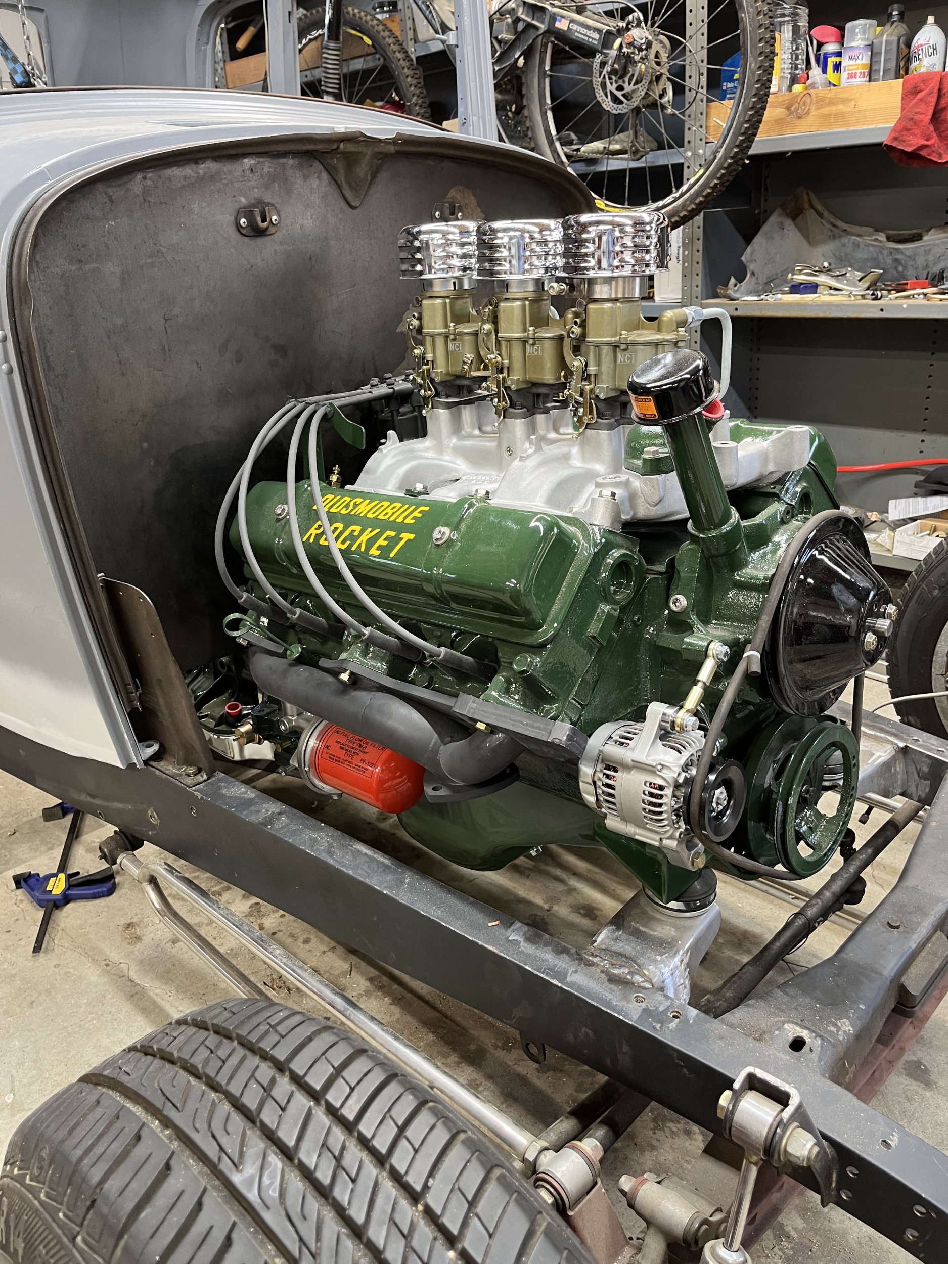

    I did this, but I’m running a hood so a generator wasn’t important I was more interested in keeping the top of the motor uncluttered IMG_4961.jpeg

  7. I am running a hood as well and it’s more for the traditional look

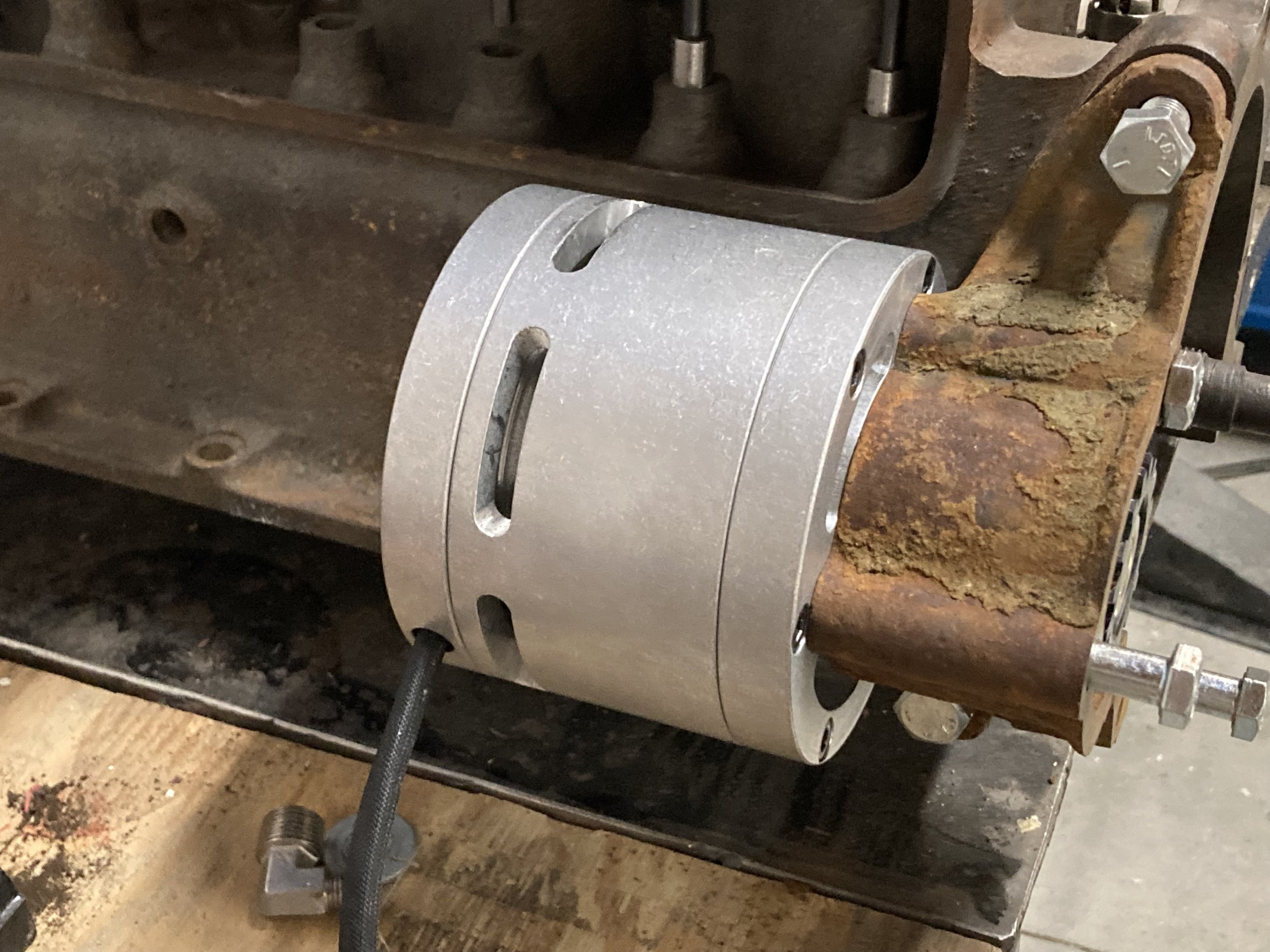

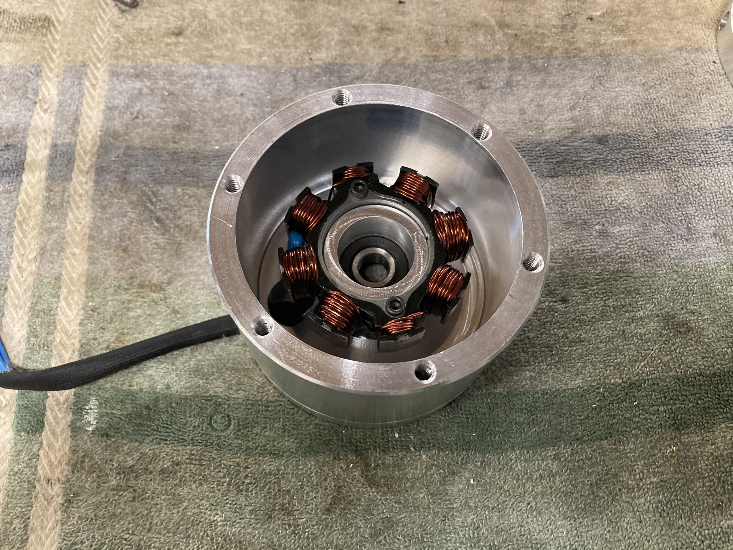

    I made a housing to disguise one of these Kubota dynamos in my T… charging a full size car battery with this thing is kinda like filling a lake with a garden hose. It will only charge 20A on a small lawn tractor battery. I’m lucky to charge 2A at speed with a full size battery. Works OK to keep a fully charged battery topped off on a long drive in a car with a minimum current draw. Don’t forget to pack your battery charger!

    Adriatic Machine
    Now we’re talking! Love this
  29. Kevin Pharis
    Joined: Aug 22, 2020
    Posts: 749
    Kevin Pharis
    from Califunny
    I have considered high power magnets or adding a 2nd stator coil to increase amperage output, but no ambition yet. It was built with a p*** thru shaft to drive a Datsun oil pump off the back, so not as easy as slacking the belt to remove.
    The voltage regulator is a simple solid state unit that mounts under the dash. The AC leads from the dynamo go under the dash, and a 1 wire connection into the harness from there.
