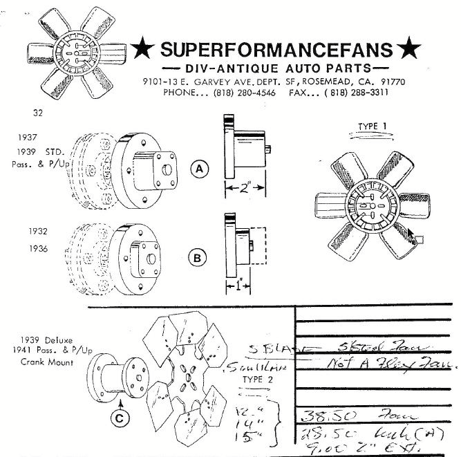

  7. I believe someone used to make/reproduce a narrow belt (8ba) generator pulley that integrated a pre '39 fan mount. Basically a hybrid 8ba generator pulley that you could bolt up a fan. Perfect part for an 8ba in an AV8.

    Not for an 8BA, but an adapter for a center mount generator. I have this on my 59AB in my '32

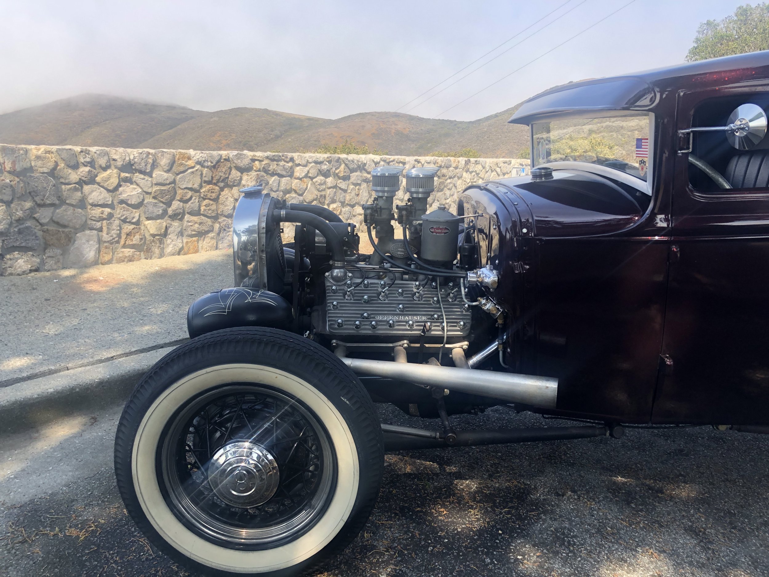

    My '31 Tudor AV8 is still in the works, but...
    '37 21-stud with a late crab-style distributor, early Offy 2x3 intake with generator in stock location. AND everything fits between stock firewall and stock radiator location. I will have to trim the fan blades a bit to clear the filler neck.

    Glenn,
    Would you happen to know if these are still available? I know Jim @ Antique Auto is trying to sell parts again, but he was tough to get a hold of when the business was operating
  11. glennpm
    Joined: Mar 29, 2015
    Posts: 234
    glennpm
    Sorry, I don't know if they are. This was the only company I could find at the time, a long while ago. Works great for me.
  12. This has been covered quite a few times, so I'll be a bit brief here:
    1) The shortest possible setup involves switching the front of the later 49-53 engine to utilize the earlier 37-48 components. You make the front of the engine look like a 59AB style engine - this is the main goal of the following. As you can see in the picture above (with the 21 stud engine) - everything will fit with the radiator in the stock location . . . which also means a stock hood can be used.
    2) The Distributor Issue: The component that really makes a difference is the fact that on 32 - 48 engines the distributor mounted off of the timing cover - which allows the fan belt to be very close to the block. Once they moved the distributor in 1949 to be a "side mount", then the fan belts had to be moved forward to account for this.
    3) Parts Needed (there are multiple options, this is what I'd use).
    a) Timing Cover: Early 2-bolt timing cover for a crab style distributor
    b) Front Mount Distributor: Crab Style 2-bolt distributor
    c) Early 42 - 48 Camshaft: This is a camshaft that is used with the front-mount crab-style distributor. This is the part that gives folks the most trouble - as it requires taking the engine apart (pulling the heads and valvetrain) and installing a new cam. Some folks will modify the cam that is in the 49-53 engine (cutting the snout off and putting the T-slot in it) - most will just install an earlier cam. If you modify the current 49-53 cam, then all the other valve components can most likely be reused (if they are in good shape). My recommendation: When you do all of this, you might as well have a valve-job done, you'll need new lifters, maybe an upgraded cam profile, etc..
    d) Crank/Cam Gears: You also use the earlier crank and cam gears - as the thrust is toward the block. They changed this in 1949 and changed the thrust toward the timing cover. As you'll have the cam out anyway, this is not a big deal - but must be done.
    e) Water Pumps: 1937-1948 single side belt pumps
    f) Crankshaft pulley: You'll need a single wide-belt crankshaft pulley.
    g) Generator: Generator that mounts a fan in the front of it - similar to what was shown above. The fan needs to be a short one - like a 34 fan.
    The above configuration will give you the best possible setup - though the cam swap can make this a bit more difficult. It really isn't a big deal, but it does require taking the whole engine apart. If you're taking the engine apart for the cam swap, I would go ahead with at least a valve job -- and maybe consider an overall "freshen up" or rebuild of the engine.
    There yah have it!
