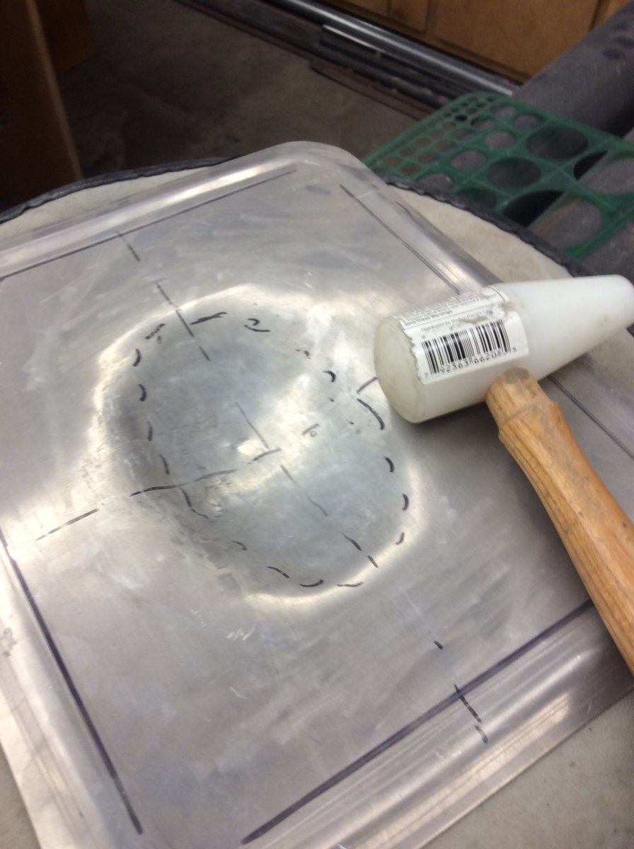

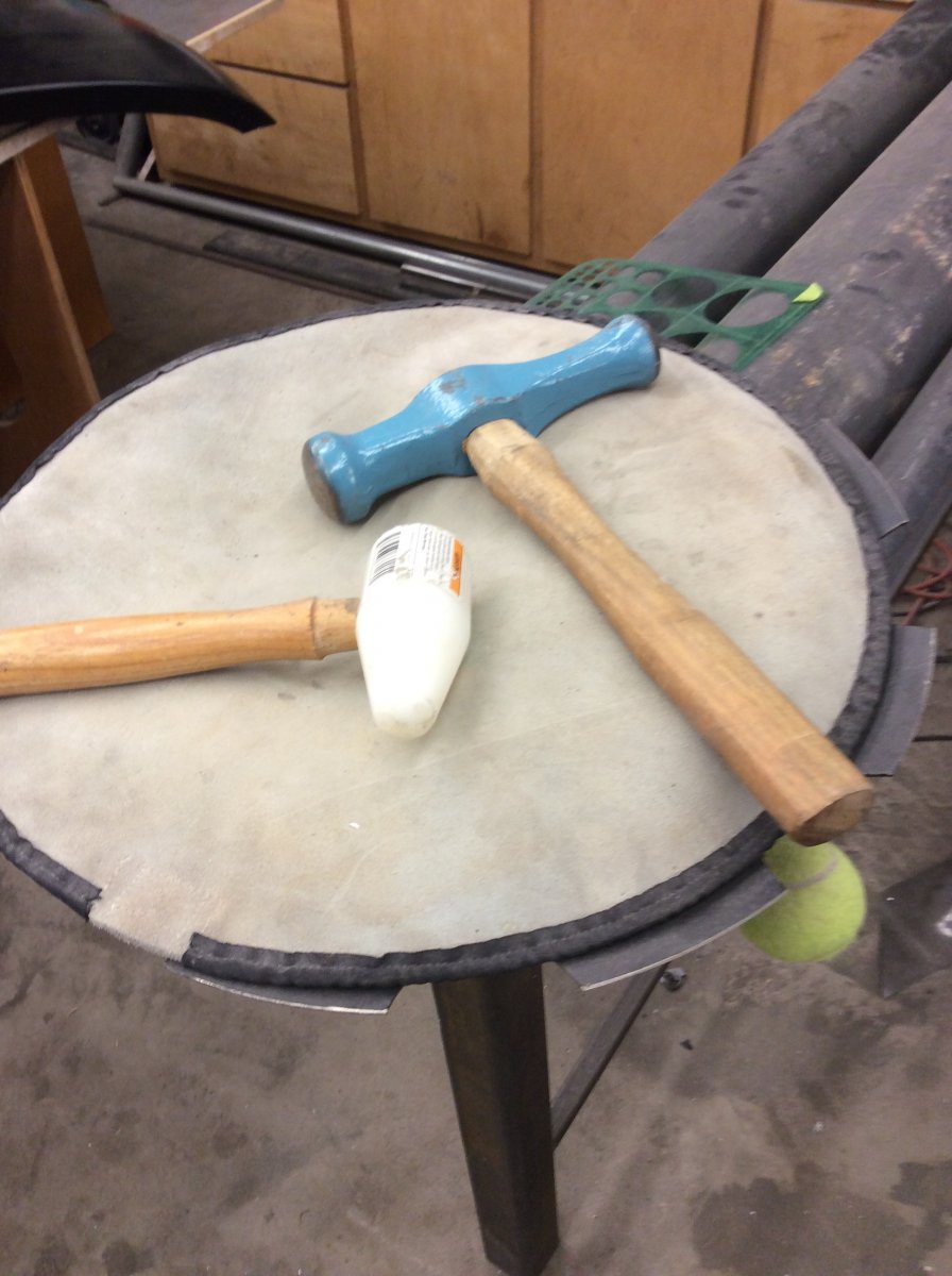

    Skier , this is one of my bags with two of the hammers I use most . I also have a cap to an oxygen bottle with a 1” pipe welded through the holes for a handle . Just polish the end of the cap so it doesn’t scratch too much .
