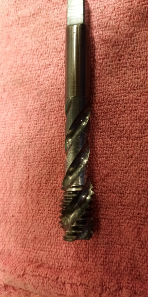

    "Taps" cut threads , "thread chasers" clean threads , if you're using a tap your damaging the threads

    I have collected taps and dies for years, garage sales flea markets, etc. Everytime I see a pile for cheap it goes in to my tap drawer. One of the things I do to prep a block is to “ chase” all the threads in that block, especially the heads and mains. I usually just grab the bottoming tap of the right size and run it in and out. I have never seen any “ metal “ come out of any block! Rust, dirt, crud, maybe but no shavings. I have been doing this for years. Most of the time I’m turning the tap wrench with my finger, spinning it into the hole and back out.
    Now you are telling me , I’m cutting new threads doing this?

    I always had two thread chasers, 3/8th and 7/16th. After spending two days looking for them, I said screw it. My last Summit order I bought a set of metric and SAE. I think they were only 12-15 bucks a set.

    True all threads have several differant cl***es.Depending on what cl*** of thread the tap is made for will determine the fit of the bolt.I agree a thread chaser instead of a tap should be used.I used a tap on a banger block i rebuilt and wished i had not.The head bolt threads were much looser than the original tapped holes even with new head bolts installed.

    Some taps are marked +.001, +.002 and so forth.... Some are also marked undersize -.001 er -.002 for a tight fit... It's best to buy quality brand name taps for tapping or cleaning threads instead of those cheap Chinese ones... ;)
