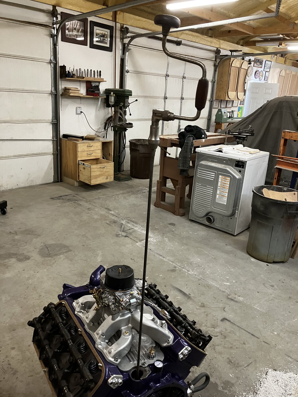

  4. I put 'em in dry. Here is my prelube system. rotate the crankshaft 15deg and twist the drill a few times at each setting 'til rockers bleed. Long shaft has notch in bottom to intersect the hemi oil pump. It is long 'cause I didn't want to cut the rod. I realize everyone doesn't have a brace!! No need to spin the pump with a drill. This pumps it up to pressure relief and pumps plenty of oil thru the system.

  5. Are you sure they aren't mechanical/solid lifters? I have always filled SBC hydraulic lifters before installation then pre-lubed the engine before starting without ever having an issue. Are you running hollow pushrods? Is the top end (rockers) getting oil? Oil passes through the lifters and pushrods on the way to the rockers.
    I don't understand how you can have a problem ...
