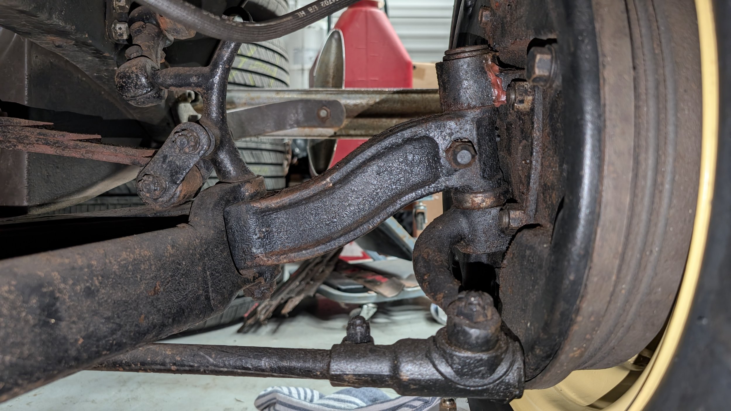

    I was looking at my steering on my '32 Sedan today to take some measurements and generally thinking about how to get the suspension drop I want. While doing so I noticed that the clearance between my stock unsplit wishbone and the cross steering tie rod is nearly non-existent. I'm planning to reconfigure this anyway but in the mean time is this a concern?
    The gap is paper thin. I had trouble getting a good representative picture of it. I swear it's not actually touching and there are no witness marks that it has had any contact. Since the wishbone is unsplit the entire ***embly moves as one and it shouldn't have contact. But still it seems like it should have at least a 1/4" space.
    This car is basically stock with '46-'48 style spindles and juice brakes. All of which appears to have been simply bolted on. As it sits the tie rod is hanging below the wishbone with the ends hung from the bottom of the steering arms. Henry had the tie rod above the wishbone with the ends attached to the top of the steering arms.
    Does the tie rod being above or below the wishbone matter? Does the tie rod end attaching from below present any issues? If I lower the front of the car as I plan (wishbone will remain unsplit) the space between the top of the wishbone and the frame will be reduced. Will it be reduced enough to cause tie rod to frame contact in suspension movement if I locate the tie rod above the wishbone? Not sure. Also not sure how to choose my parts to avoid that. However, if it's not a concern to have underslung steering the previous question is moot. And life is much easier to sort out my front suspension drop questions.
    Pics to follow of what I have currently.

    Here are the pictures. I swear they don't actually touch.

    If it bothers you, get a torch and bend the arms down a 1/4" to 1/2"

    Is the steering rod bent? It can happen. HRP

    NO,, THAT ALL MOVES TOGETHER,THE SAME AMOUNT..

  6. Put a straight edge along the bottom of the crosslink and see if it is bent upward. Hard to tell but it appears to be in the pictures.

    I tried doing the tie rod below a '32 heavy axle dropped to 4" and put the tie rod below the axle which is a bad deal in my eyes. Nothing like dragging the tie rod if ya get a flat. So, I used '40 spindles and heated and bent them up just a touch and went over the stock '32 wishbone.

  8. Does it touch when you articulate the suspension?

    Not true. On full lock it rotates about the king pin which is at an angle.
    You need to check clearance lock to locks

    Your statement is basic true* { from caster effect } !,But over looks ,that it's been working with out hitting in turns =Yes it moves tie rod little from caster*,but not enough to bend it self.; So back to ,it moves all together, even built in caster setting! As that's how post was asked.

    Good point. I will add this to the list of things to check... just in case.

    On my avatar roadster I have a '38 front suspension with cross steer and split bones. I just measured, my tie rod is 1-3/4" below the wishbone. Your tie rod definitely looks bent upward. How about replacing the tie rod and adding 1/4" or 3/8" spacers between the steering arms and tie rod?

    Simplest solution is to heat and bend the arm a touch for more clearance below. If you change to a dropped axle, it will be very hard to drop the arm enough to go under the wishbone, but it might be done. Will most likely need to go above, and might need to trim the back edge of the crossmember for clearance on full turns. If you use a flatter spring it will be even more problematic.
    On my sedan I have a dropped axle and reversed eye spring. I used the tie rod ends from Speedway that have a drop built in to get the tie rod below the wishbone. Some tweaking to the arms will get you to the sweet spot with clearance, but not too much.

  14. If it clears in use is clears.
    Dont need 1/4 inch of clearance if a 64th is enough

    As I said, I didn't see any witness marks of contact and the paint on it is old. So if had been hitting there would be signs.
    But I'll check it out lock to lock just to be sure. I'm planning to change it all anyway, but between now and then I plan to drive a bit so safe operation is essential to me.
