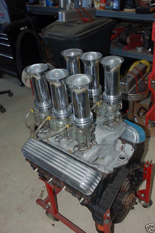

    I bought a www.retrotekspeed.com 6x 2 setup for my 46 Olds project. Not exactly traditional but has the looks, power and economy with a T700 and 3.5:1 rear end. With the price of gas down here, twice the price what you pay in the US, and given the fact that I drive my cars it was the logical solution for me, horses for courses they say. An added plus is that you don't have to synchronize or tune each carb to get the system running correctly. Starts first time every time and the hidden ECM is easily programmable. Comes with base map program so tune to your requirements.
    My system came with 97's, pump, ECM. I even added the fuel on demand component to make it more economical. No external choke assemblies on centre 2 assemblies though. Here are my Faux 97's on my 6x2 manifolds and Holley 94's (As an example) on an engine. Wire showing at back on manifold is throttle position sensor (TPS)

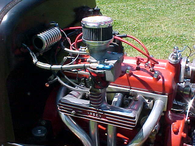

    Here's the Mooneyes unit on my Model A engine. Worked great here in the mountains. Replaced it with a pair of new 97's as the F.A.S.T hill climb rules banned aftermarket EFI
