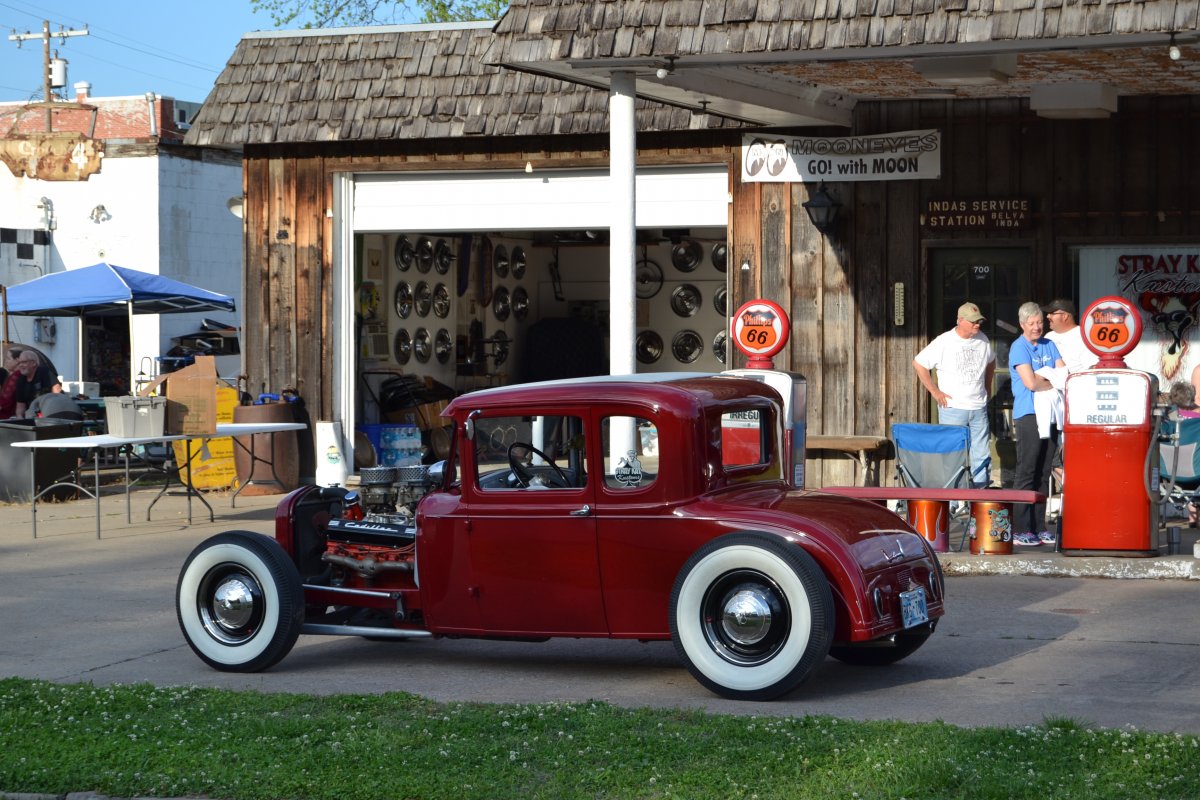

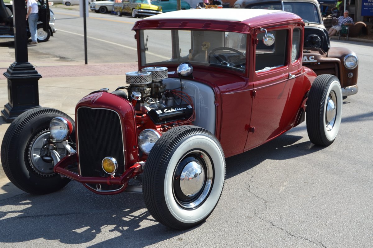

    So which of your three reasons would apply to the owner of this Model A? DSC_0068.JPG DSC_0133.JPG

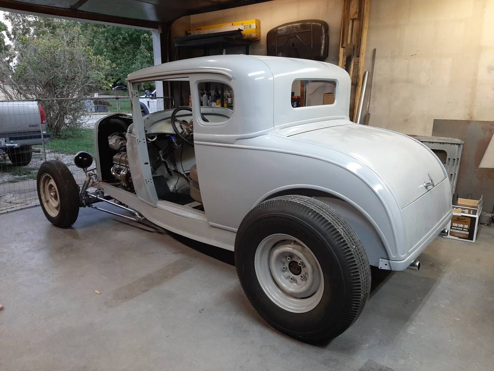

    My vote is chop-ola. Mine is a 4inch cut with a caravan seat. I'm 6ft 230lbs and fit fine. It's in the body work stage now. 20191002_183306.jpeg

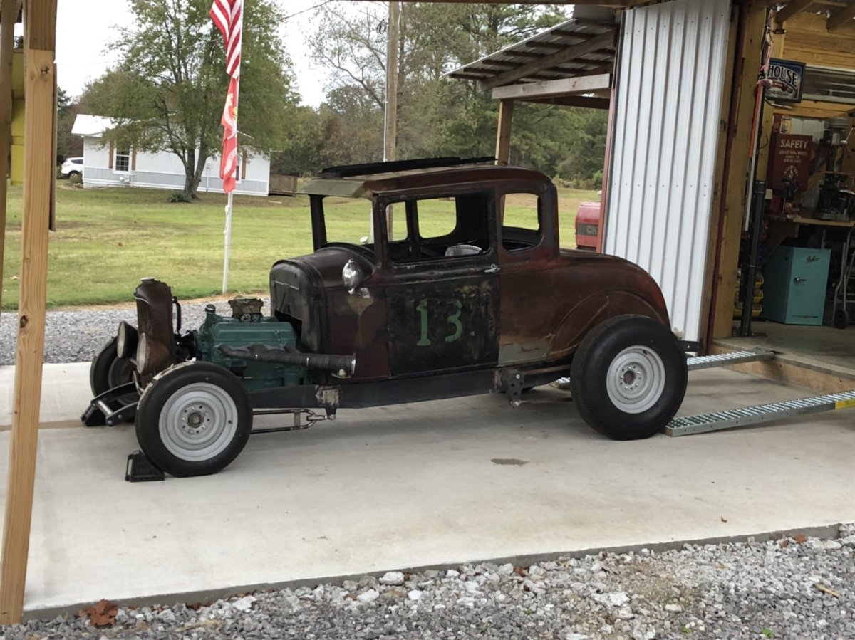

    33atspeed.jpg Put the seat you plan on using in the car. Sit down and have someone measure how much room between your head and the top. Cut the top one inch less than that number. At least, that's how I did it with my channeled 33 ford pickup. Never regretted it. Btw, my seat [ford mini van seat] was mounted on the floor with no adjusters. Chop was 5.5".

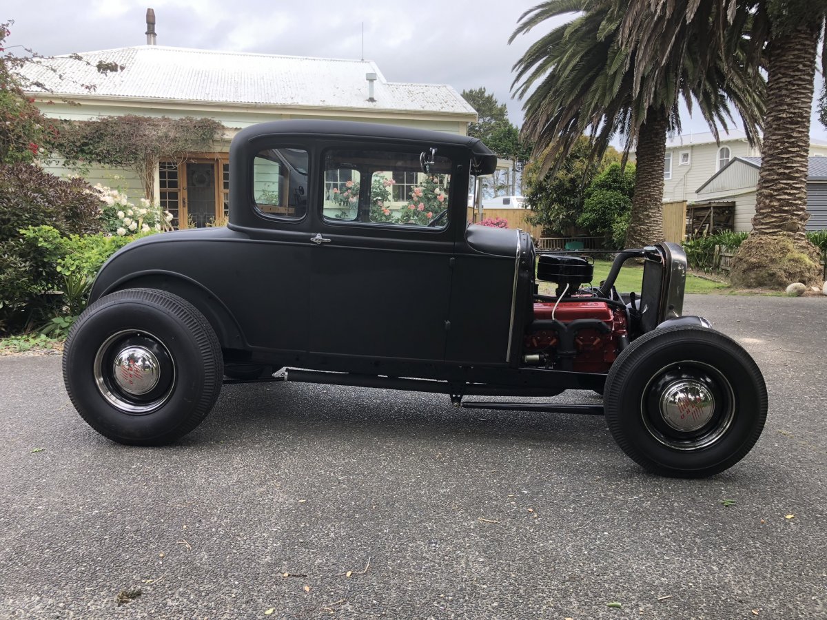

    I've just about finished building this coupe,I haven't chopped it,when I started the build I was going to chop it 4",,,,I decided to leave any decision to cut the roof till last,after I had completed the build ,,,,my final decision was to leave it stock height,,,as it had kinda grown on me,,,,,you don't see a lot of Model a hotrods unchopped ,,,still your choice , IMG_7668.jpg

    Beautiful coupe, love the look
