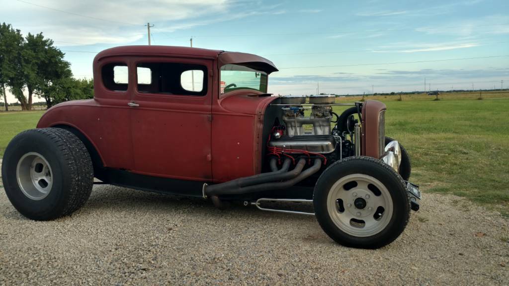

    For what it's worth.... here's my actual experience and takeaways:
    I have a crusty ole Model A coupe that I have beat on for over 15 years. 60 over 396, 10.5 to 1 compression, mildly worked oval port heads (port matched and polished), Comp XE274H cam. The car has an M-21 and 3.50 gear nine inch with 31 1/2" tall rear tires.
    I ran a 2x4 offy hirise with Eddy 500 cards and progressive linkage for years.
    This year I found a swap meet, oval port weiand street tunnel. I had read why so many said it wouldn't work. Well, at the HAMB drags this year it picked up 6 mph in the qtr.
    No, I don't have the ideal street/strip setup but I have fun. The car's street manners are better and I think the intake looks *****in. The plugs after the 300 mile trip looked cleaner and more even from hole to hole. I'm sure the light (2900#) car and 4 speed helps it's streetablity.
    I wouldn't run a streeter **** single 4 on this car anymore than I would add a/c or cruise control. It's a grity ole hot rod that I have a blast with.
    Summary......do what you want and work on it til it works. Most that say "you can't" never have tried.
