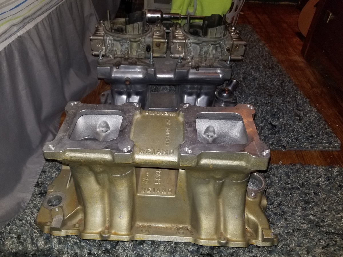

  10. Smoothy
    Joined: Jun 18, 2015
    Posts: 338
    Smoothy
    Well I bit the bullet tonight and bought myself a Christmas present from a local guy on craigslist. A Weiand 5985 Tunnel Ram. I have decided against pulling the 450s off of my small block tunnel ram and am going to buy a pair of 600 Holley vacuum secondaries tomorrow for a different guy on the local craigslist.
    My question is this, where am I supposed to hook the vacuum secondaries to? I literally have no vacuum ***ist on anything in the whole car.

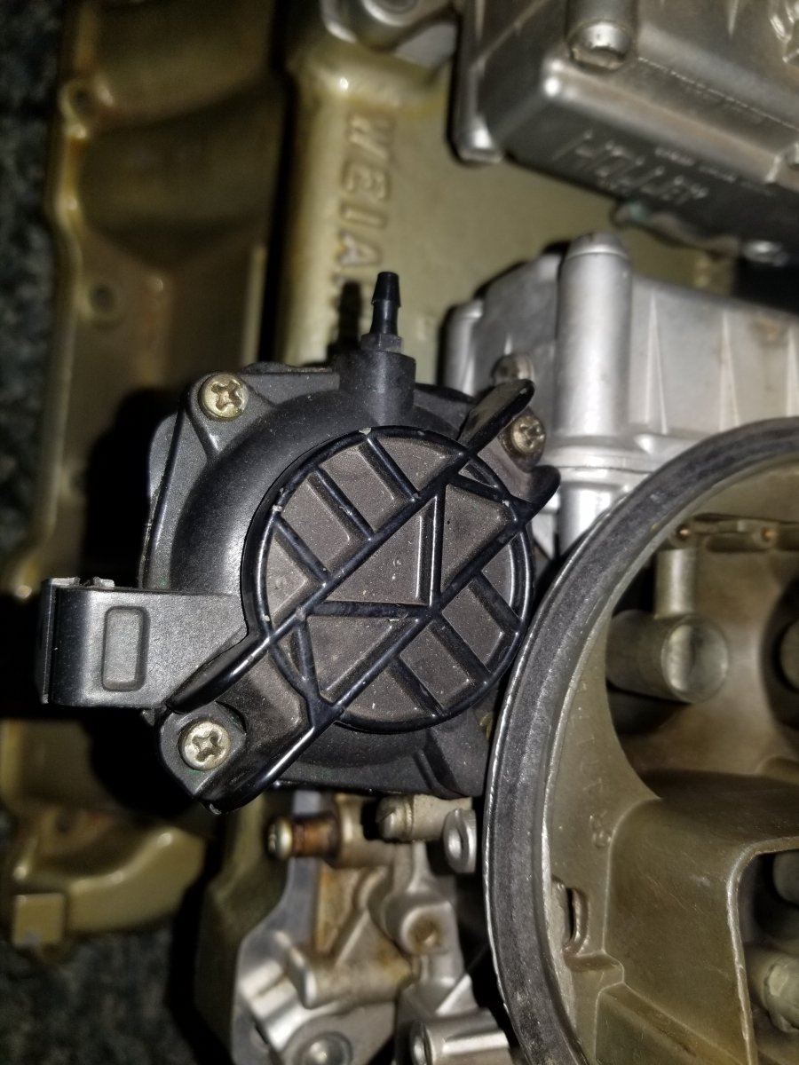

  26. Smoothy
    Posts: 338
    Smoothy
    Are these the diaphragm tops you're talking about? These carbs came off a 396 in a 33 Willys with a low rise dual quad intake, so I'm hoping they're in the ballpark. 20181227_215809.jpg
    loudbang and Deuces like this.
  27. swade41
    Joined: Apr 6, 2004
    Posts: 14,478
    swade41
    from Buffalo,NY
    Yes those look like the balancing modules, also do yourself a favor and just use right stuff black rtv instead of the gasket in the tunnel ram, which are prone to leaking. received_1293730194061011.gif
    loudbang, Deuces and Smoothy like this.
