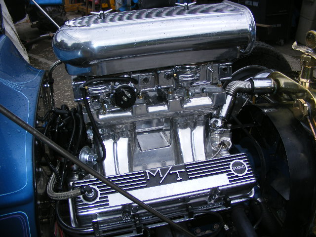

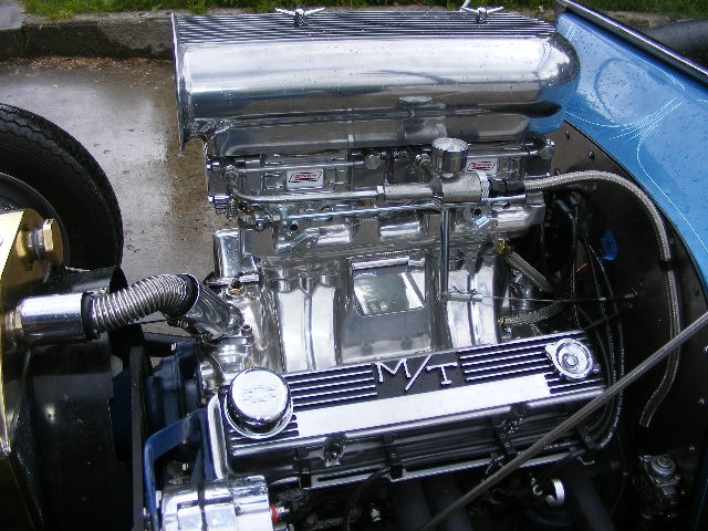

    Here's the latest tunnel ram I did last week, customer loves it even with auto trans and so so rear gears, un known stall. Idles great at low RPM.

  14. brigrat
    Joined: Nov 9, 2007
    Posts: 6,056
    brigrat
    from Wa.St.
    2old, Got it running last Thursday and he had a car gathering to go to on Sat.. He wanted a couple days to get used to it and clean it up a bit. Comes back tomorrow for a final tune up than I will bend some small stainless tubing (instead of rubber hose) and connect the 2 ports. Still trying to learn all I can about these new to me QF carbs. Lots of adjustability over the old Holley's of yesteryears.................................................

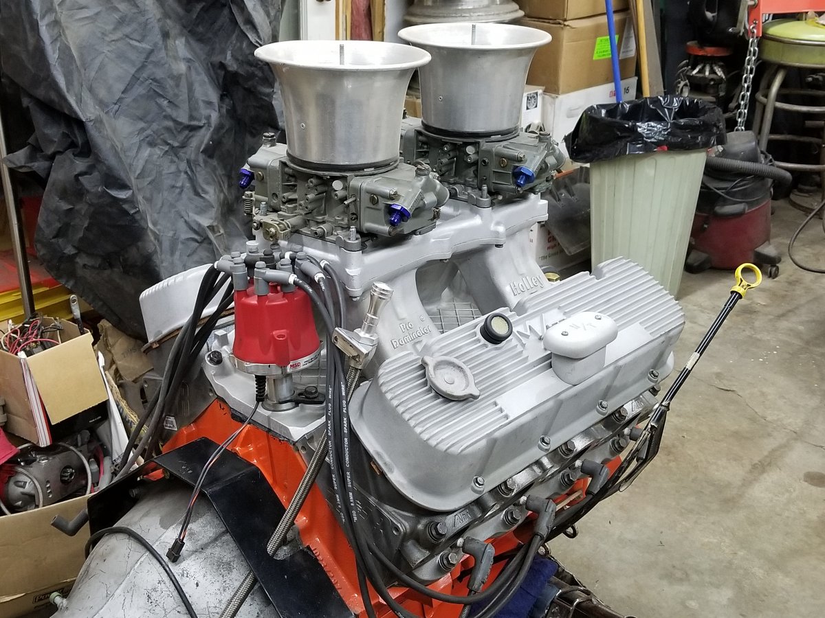

  16. lumpy 63
    Joined: Aug 2, 2010
    Posts: 3,362
    lumpy 63
    Got mine fired up on the run stand a couple of weeks ago, same set up I had on the 400 sbc. Now on the 377 with more compression and more cam + better heads. Still using the 1850 600s for now with 50cc accelerator pumps , milled off choke horns etc. changed the power valves from 6.5 to 5.0s for the loss of vacuum with the bigger cam. Idles at 1000 revs fast no farts or pops . Thinking its time for more gear:cool:
