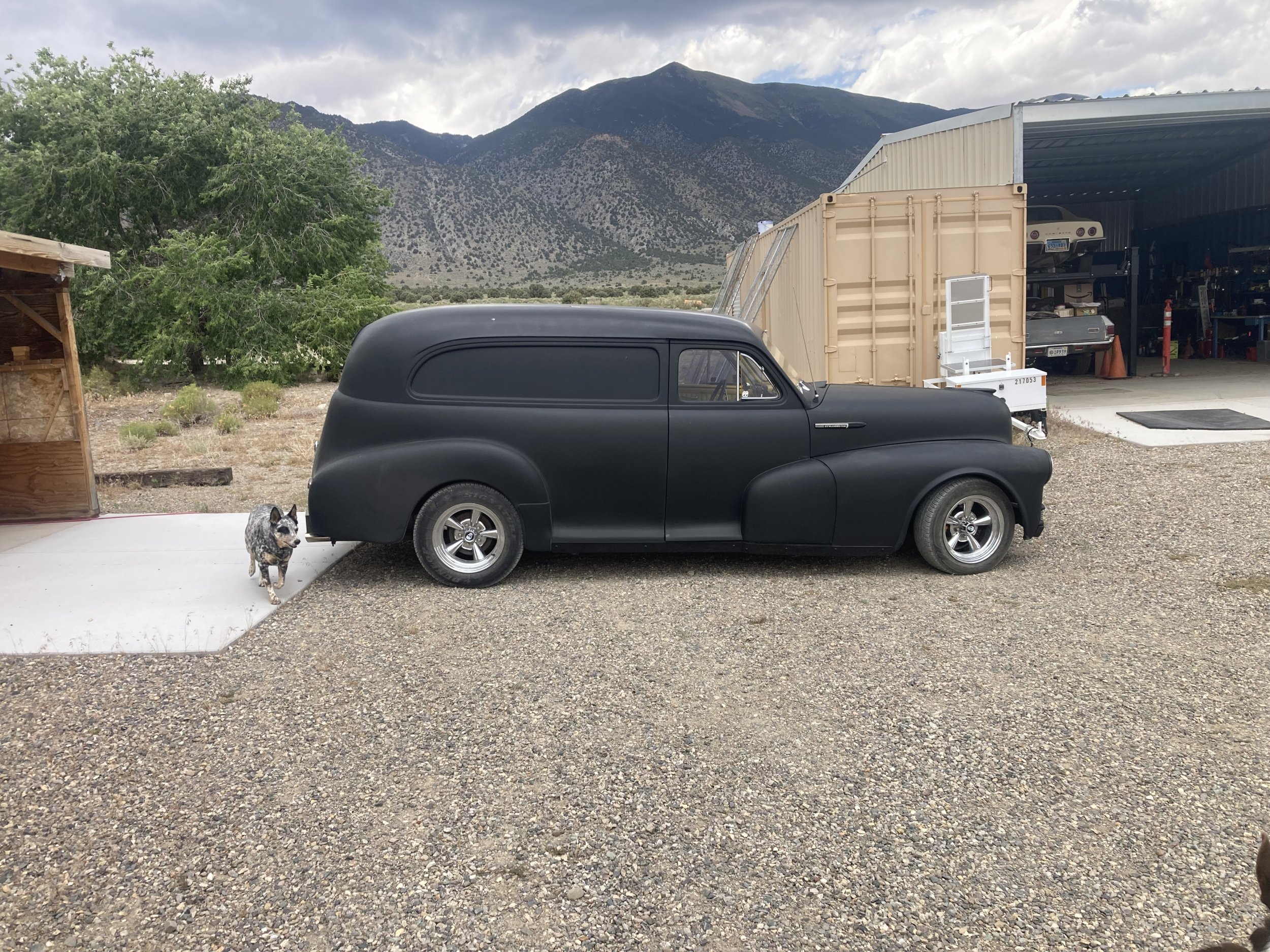

    I have a bunch of cars and have been selling some off. I'd like to get down to maybe one hot rod and it will be this recently acquired '48 Chevy Sedan Delivery. The reason this one is a keeper is because I like to do road trips and this is well suited for that. Lot's of room inside, rides nice, and I can tow a custom teardrop trailer behind it.
    It's a 350/350 combo now with a 3.55 or 3.73 gear. The engine seems to be stock so I'd like to do a cam, intake, carb swap and maybe heads to get a little more power and nice loppy idle. I'd also like an overdrive trans so I can drive 65 to 70 MPH a little more comfortably.
    Many have suggested the dreaded two letter modern engine and trans swap but I want to keep it more traditional old school. Thinking about going with 3 deuce carb set up or even dual quads just for the look.
    Then I saw this Mopar with a 392 Hemi in it and thought that is pretty cool. The sedan delivery is not a common car to begin with and having one with a 392 in it would I think, be really neat.

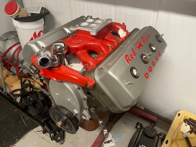

    Now 392 Hemi's are not easy to come by but I just happen to have one! I bought this a few years ago to put in a '34 Ford coupe I had but it was a gl*** car and I just thought it deserved to be in a steel car. I sold the '34 and figured I'd probably sell this engine too but now I'm rethinking it. It's a rebuilt '57 factory dual quad from a New Yorker.
    I'd want to paint it a different color (maybe red), dress it up a bit with some nice Hot Heads stuff (polished intake, valve covers, air cleaner, etc.) before I put it in. There is plenty of room under the hood for it so I don't think that would be an issue.
    Not sure what trans to go with but it would have to have overdrive. Hot Heads makes adapters for different manufacturers so I could with a 700R4 or something like that. I don't know if there is a Mopar overdrive trans that would bolt up. Or I could go with a 727 and a Gear Vendors although that's a more expensive route.
    My only hesitancy about doing this is gas mileage. While I'm not too concerned about the cost of gas but more so, would be fuel range. The car has about a 12 gallon tank which is pretty small. I intend to replace it with a larger one and will carry extra fuel cans when I travel. I live in NV and all through the west there are long stretches of roads without much in between. It would be nice to have at least a 300 mile fuel range.
    Do you think this engine with an overdrive trans can get at least 10 MPG cruising at 65 to 70 MPH? That would require a 30 gallon gas tank which is pretty large. I'd be really happy if I could get at least 15 MPG at those speeds. maybe with overdrive and a bit higher gear like a 3.08 would be the solution. I'm not drag racing it and with the extra power of the Hemi and a 3.08, it would still perform nicely.

    The only problem I see is with a SBC you keep the hood closed, with a Hemi? You may be leaving it propped at shows.

    Match the gearing, cam, and induction, and you should be able to get 13-15 mpg out of it. Hint: think "stock" or "very mild"
    But it'll be a huge can of worms to get it all together and working well. I hope you're up to it.

    This is probably the best way to go and was my original plan with the car. Wasn't really thinking stroker but rather keeping it a 350 and going with an RV type cam for the low and mid range torque.
    I live at close to 5000 feet elevation and yeah, lots of mountain ranges to cross from here. Engine cooling would be a concern too climbing long grades under load and 100 + degree air temps.
    The car is a running good driving car now so the Hemi swap would require it to be down for probably longer than I want. Those kinds of projects always take longer and cost more than you expect. A cam, intake, carb swap of the SBC could be a weekend job.

    If you keep the 350 in it, you might consider how your proposed changes will affect the car in the opposite way from your intended usage. For mileage, you really want to keep the stock cam and gear it for appropriate rpm. That means the 3.55 gears (or even longer) and OD, and a stock intake and Qjet work really well. I went through this with a few different rides, my 57 Suburban ended up getting well over 15 on the highway with stock 87 350 converted to carb, 3.0 gears, and OD. And it was peppy enough for me. I also killed the mileage on my 62 Corvette by swapping heads/cam/intake/carb, went from 18 to 12 on the road.
    And adding all the higher RPM stuff isn't really going to help towing, you need low-midrange torque for that, and that is what stock engines are designed to make. If you were planning to go racing, then you want to run the engine at high rpm. I don't think that's what you have in mind.

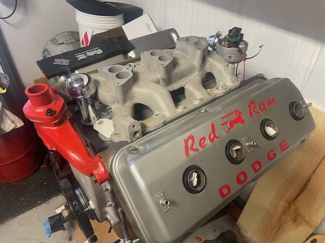

    Did it 30(?) years ago as a prank. Notice valve covers laying on header pipes. Tin Chevy valve covers and plug wires there, too, underneath.

    Ohhhh, an ultra rare hemi headed SBC complete with PVC injectors! :D
    I really like you flower pot holder though. :cool:

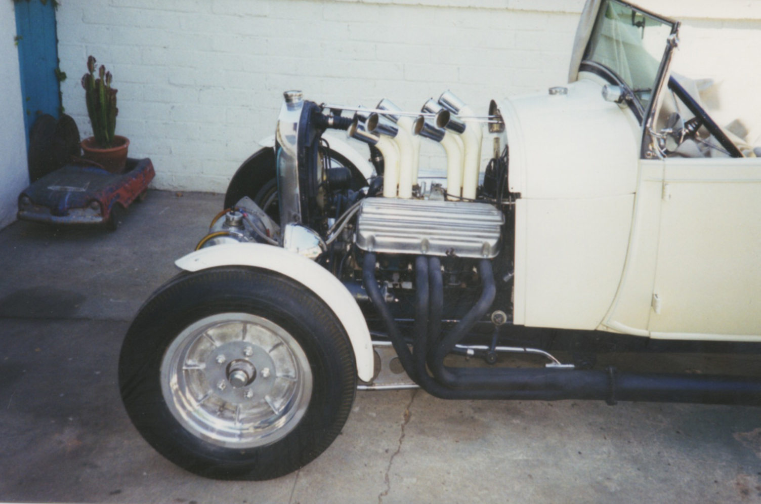

    You are correct. I think what I have now other than lack of overdrive, is best for what I want.
    All my other cars are OT 1960s/'70s muscle cars and a couple Corvettes. Nothing suitable for the hemi. I've realized I have too many cars and am spreading myself too thin, time and money wise so selling them all. I want to get this car dialed in 100% to my liking and for what I want to use it for. Once it is done I can think about picking up something more suitable for the hemi. Ideally, that would be a '33/'34 or Deuce coupe but I think they are price prohibitive at this time. A Model A coupe or Tudor is more realistic.
    I wouldn't mind building a copy of this '29 I used to have but with the hemi and a stick shift.

    The power level and the fuel mileage you want shouldn't be too hard to accomplish, right up until you want to hang on the custom teardrop trailer and want to drag it through the mountains. That teardrop could change the entire plan, since we don't know how easy it pulls.
    If you feel your current sbc is slightly under powered with the 3:55 gears, you won't like it at all with an OD trans behind it. Then you want to swap in 308 gears instead of the 3:55, with the OD? Its going to turn into an under powered, slow poke, real fast, climbing those mountain grades. That 10 mpg may become a fairy tail. Then add the effects of the teardrop following along up those mountain grades. The reality is, that OD trans probably won't be in OD most of the time you are in the mountains. That 10 mpg may be a fairy tail until you get through the mountains.
    More cubic inches (or torque) will be able to pull those mountain grades much better, will deal with the OD better, and will likely be less effected by the trailer in the mountains. With a properly tuned big block, you may get much better mpg with the OD then the sbc will get.
    The old school multiple carbs, intakes, and rumpity cams won't get you the road car it sounds like you want. Just my opinion.

    Meh. With a Camaro subframe the Camaro engine and ****** are right at home. Leave it and drive the hell out of it. Maybe put houndstooth upholstery in it?

    For me the most sense with that rig with what you want to do with it is run the 350 and put in a cam that is more road friendly than mouth breather impressing and a performer intake and 4 barrel of choice. Anything else carb wise either 3 2 barrels or 2 four barrels might again impress the unwashed mouth breathers when the hood is open but be a pain in the *** for what you want to actually use it for and here the KISS theory applies. Keep the ****er simple, set it up so if you have trouble on the road you can go the first parts house you find or even a wrecking yard and find the part you need to fix it and get on the road unless you flat blow something up.
    I wouldn't argue with putting a 383 stroker in it though or turning the 3fiddy into a 383 stroker. Cubic inches count and in a 1 ton 4x4 I had 35 years ago the tired 400 that came with it still had more power than the fresh 350 I put in it after my wife blew the 400 up.
    Still any rig has to have an engine, trans and rear axle (final ratio after tire size is counted) ratio that works to do what one wants to do with it. It has to be a deal of This setup will work to do what I need it to do on the road doing what I do and not as much of a setup that impresses the mouth breathers but lacks in actual function. If you want to build a show car build a show car and get something more practical for road trips.
