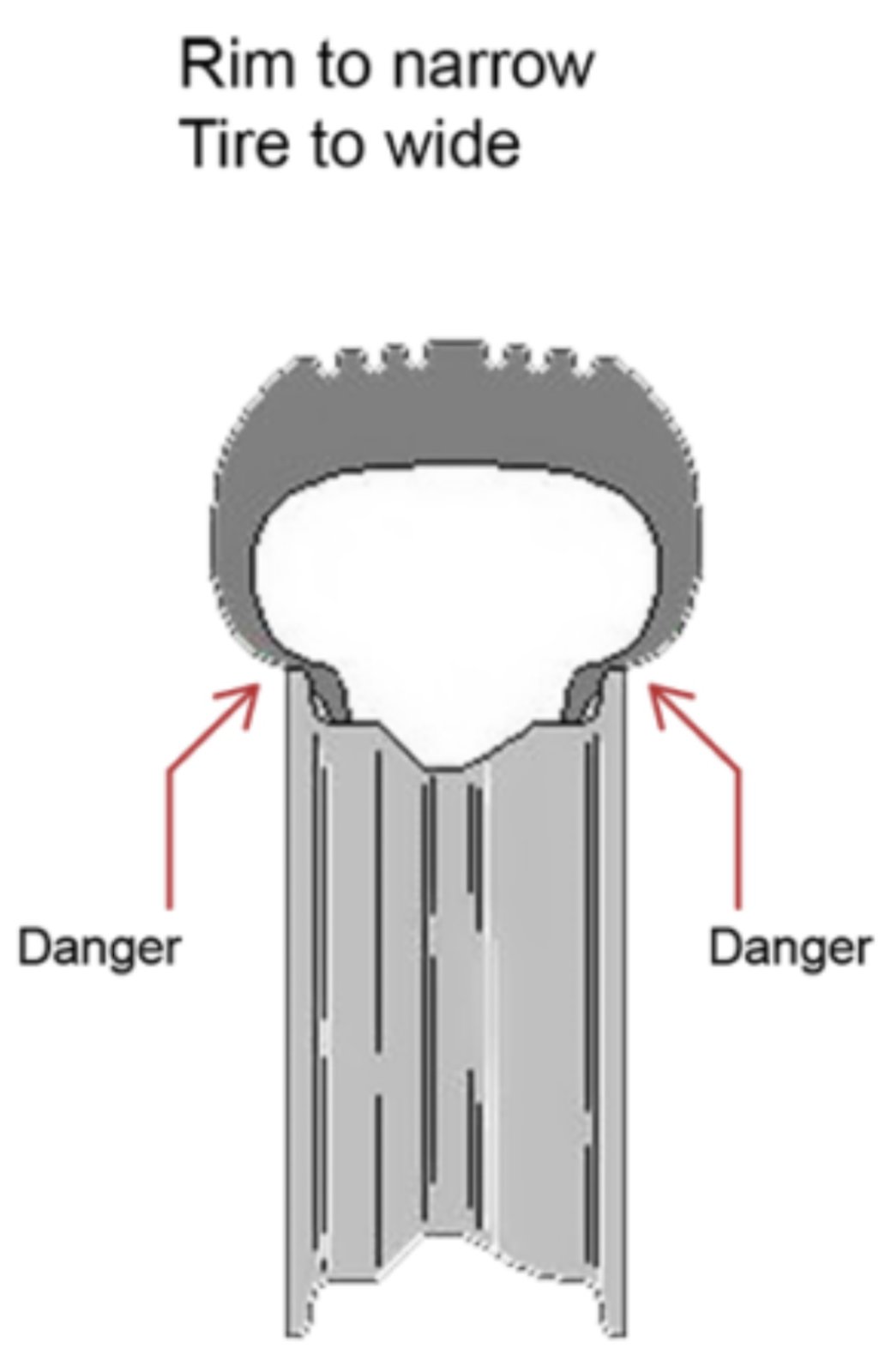

    Keep in mind there's also a safety aspect to running tires on narrower wheels than they're intended for.
    The manufacturer recommended size for a BFG 275/60 is 7.5-9.5.

    Correct. Running a 275 on a 7" rim with the low pressure needed to keep the tread face on the road will cause excess heat buildup in the tire. Heat is the enemy.......

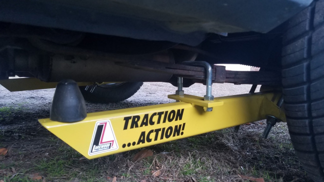

    I thought I had my say but since Cragars and Lakewood traction bars were mentioned, here's a little story......my second car in high school was this 57 BelAir, partially financed by my mom and yard mowing money, having my face glued to hot rod magazines kept the gears turning in my head 24/7, so many mods were planned for this car but with limited funds some things had to wait, one thing for sure was Cragars were going on it one way or another.
    Just so happened that a schoolmate hung around the shop of our local Funny Car hero who was sponsored by Cragar, he told me he could get four new 14x7" wheels for $75.00, luckily it was summer and yard mowing season, did not want to p*** up that offer so begged my mom to front me the money, a week later they showed up and there was not a happier kid on the planet but any further mods needed some creative "non $$$" action, they are hard to see but those are homemade "Lakewood" bars, hardware store snubbers even looked right, glued on the logo from a magazine ad, nobody knew the difference.

    I was actually referring to other safety considerations as well. Too wide a tire on a wheel reduces stability and can cause issues with how the tire is required to flex around the bead of the wheel and how well the bead actually seats. This can lead to premature failure.
    If you think you know better, go ahead. "I've always done it that way" is a statement I hear a lot in failure ****ysis after failures occur.

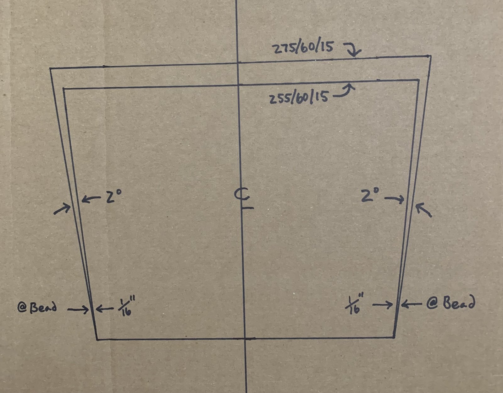

    Here’s a simple to scale illustration using tire diameters and tread widths on a 7” rim width.
    255/60/15 -Tread width 8.2” -Diameter 27.1”
    275/60/15 -Tread width 8.9” -Diameter 28.07”
    As the drawing I drew up there is only 2 degrees of difference between the 235 and 275. At a 3/4” deep rim bead that’s only 1/16” of compensation required. IMG_3104.jpeg
    Now I placed a protractor on this illustration and the degree come out to 18 degrees. When I scale that out using a 3/4” deep bead there is a 5/16” of gap. IMG_3103.jpeg
