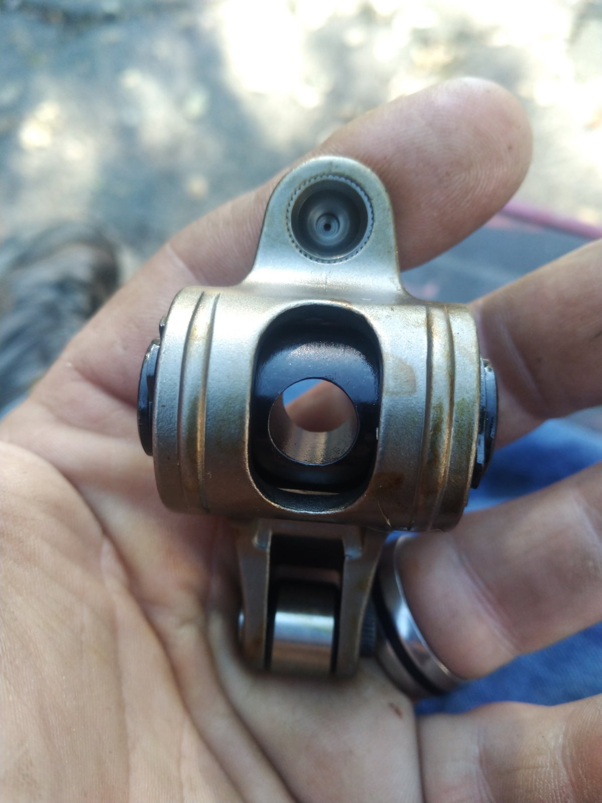

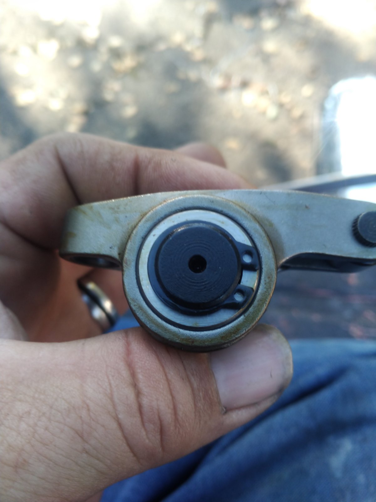

    My buddy was cleaning out his garage and gave me these stainless steel Cat roller rockers for a sbc new in box circa 2008. I have a mild 327,.466 lift, 224@ .050 cam . TheseE have a mixed reputation online, so has anyone run these, good or bad, or general thoughts?

  6. They look fine to me,,,,except for the logo ?
    Are they in a CAT box ?
    All the Cat products I have ever had or saw,,,had a clean ,clear Cat logo,,,and had an image like a panther or large cat above it .
    I’ve never seen engraving or dot spelling on their parts,,,,maybe I’m wrong .
    Either way,,,they look okay for anything short of a high output application,,,,and might even be good for that ?

    I would be concerned about the bearings being rusty. looking at the photos I don't see the cam breaking any rockers.

    Any problems with the rockers themselves. The polylocks look like crap and won't be used. The ratio looks good on the ones I measured

    I'd only use them if you can take the time to check them often for the first couple thousand miles to ensure that are stable. The needle bearings are what I'd be most worried about.

    I would take them apart and have a look see, if they look good and your not running some crazy spring pressure you should be good, if they look bad then you have your answer.
