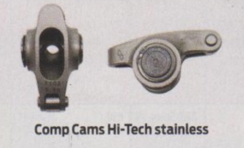

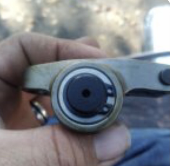

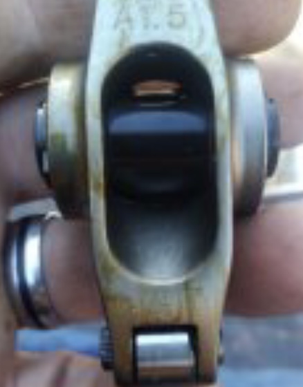

    FB69EB98-260D-49CE-B7B1-A6BFEB3B8050.jpeg 01C49B11-D6DF-4B6F-8618-1882277A72D8.jpeg 3FBFB7FD-E0AA-4053-A237-E7F0271454EF.jpeg
    Other than the radius in the corners where the roller tip for the valve stem is the Comp Cams rocker sure looks like the CAT rocker. Those castings appear to be the spitting image of one another.
    The CAT rockers are from pre-2008, was the machining updated at a later date to eliminate the sharp corners?
