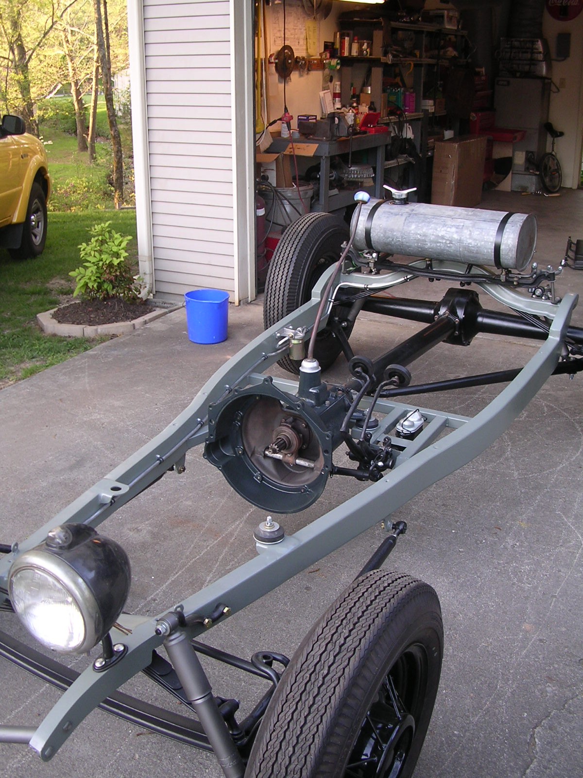

    I used a '40 rear & torque tube on my RPU. Shortened it in front of the radius rod lug. Left the bearing inside alone. I shortened one end of the driveshaft & had it resplined at a local machine shop.
    Don't beat yourself up trying to find a '33-'34. Use what you have. It'll work just fine.
